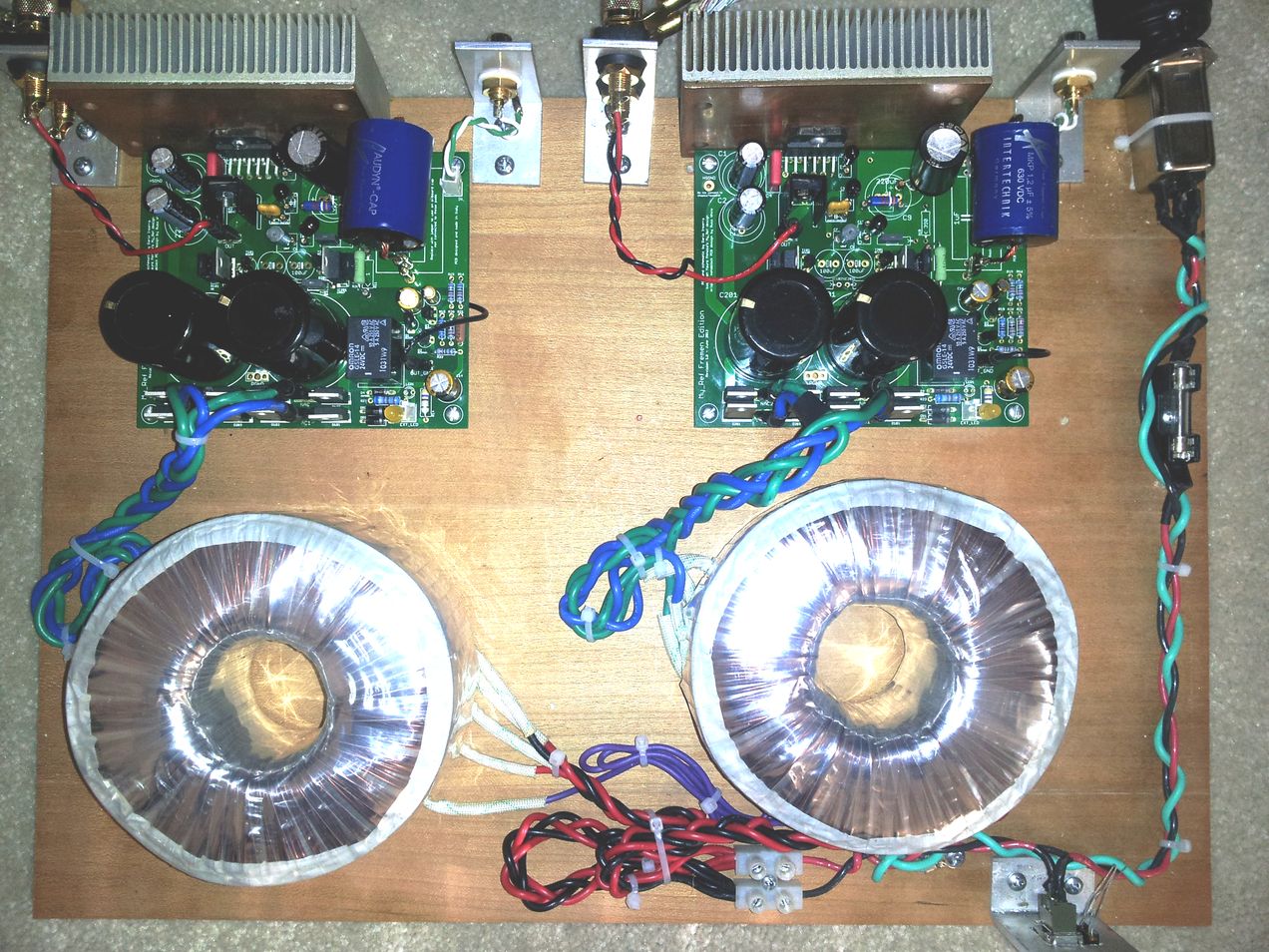

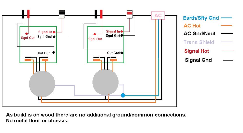

The configuration has no common mains wiring. That's what makes the problem so confusing. The fact that the JC-2 is completely free of hum when connected to the powered speakers indicates the problem has to do with the pre to FE combination. I'll do some more puttering today.:scratch:

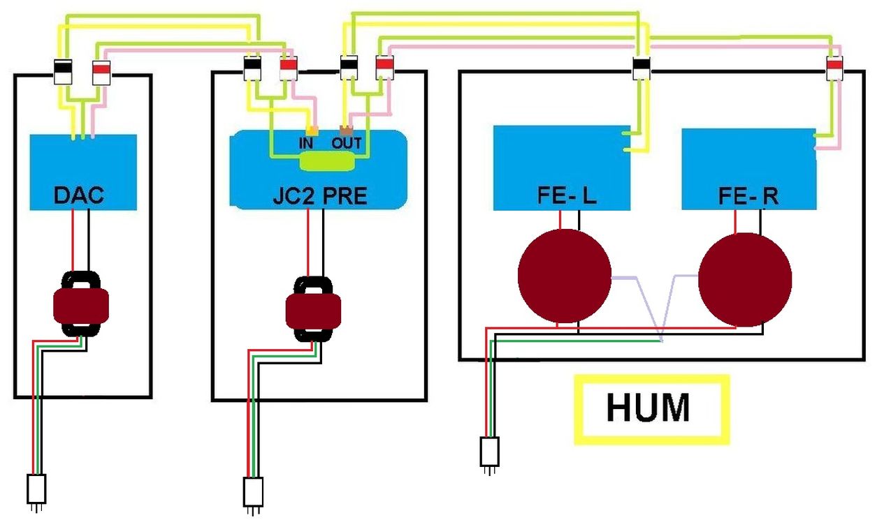

I replaced the JC-2 with a Carver C-1 and the hum remains. Commercial shielded pre-made interconnects were used. Again, a direct connection from the Mini 2496 DAC is perfectly clean. Has anyone successfully used a pre of any kind with the FE?

you left pic clearly shows loops in the grounding. Two sets of them.
The centre and rightmost show just one loop, but the other end of that loop is not connected = no hum.
Had the other end been terminated with a stereo amplifier then that too would probably have hummed.
It's loop area that is the problem.

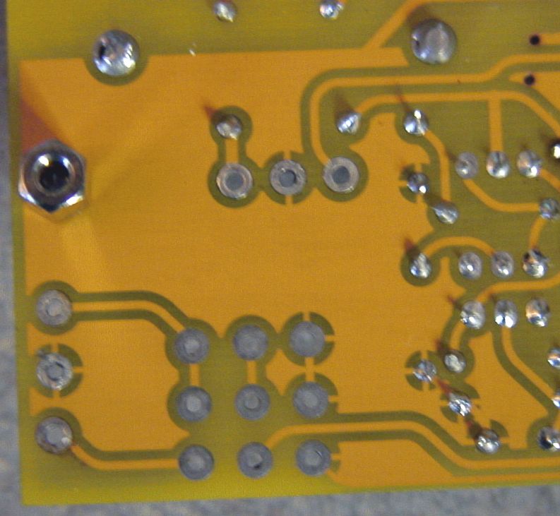

Hey Andrew. I think I see what you are describing, but the grounds on the JC-2 are all the same - two big connected planes on both sides of the PCB.
The mystery I have is why that same configuration of the JC-2 does not suffer from hum/loops with the powered speakers.
Bob,
It's just a guess, but it is likely that the powered speakers don't have the same ground and shield connections internally. Because they seal the package together, they may take other approaches to safety ground. After all, the powered speakers probably use a wall wart and all their high voltage is constrained to the wall wart.

New development - finally seeing the obvious I connected the JC-2 to a Hafler 120 power amp. No hum at all and music plays cleanly without distortion.
That, combined with the powered speakers result makes me believe the problem is the JC-2 to FE connection, placing the build on wood, or as willamp suggests a leakage of signal to ground after the RCAs on the FE build.

Bob, the idea is not to tie your input signal shield of the FE to the speaker gnd but instead to tie it to some quiet ground point. And also to tie both input signal shields to this same quiet point. You don't want any current flowing in these shields, that's not what they're for.
I don't quite understand your grounding scheme in the FE. It's a dual mono design but are the two audio signal grounds from each channel tied together? (These are the grounds that would go to your speakers.) Also are they tied to earth ground in any way? Depending on the answers to these questions I could better suggest a place to attach the input shield grounds.
Phil
