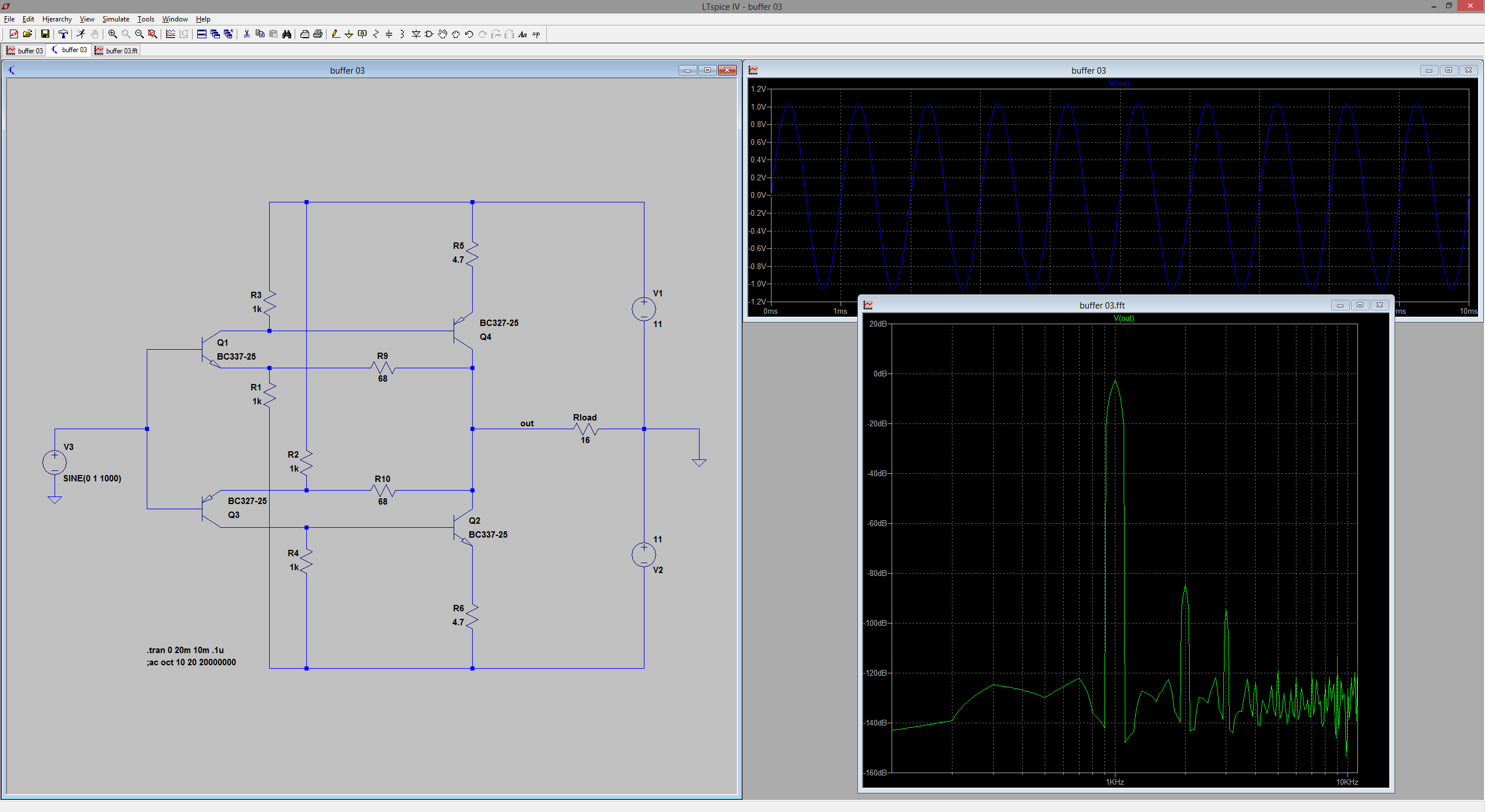

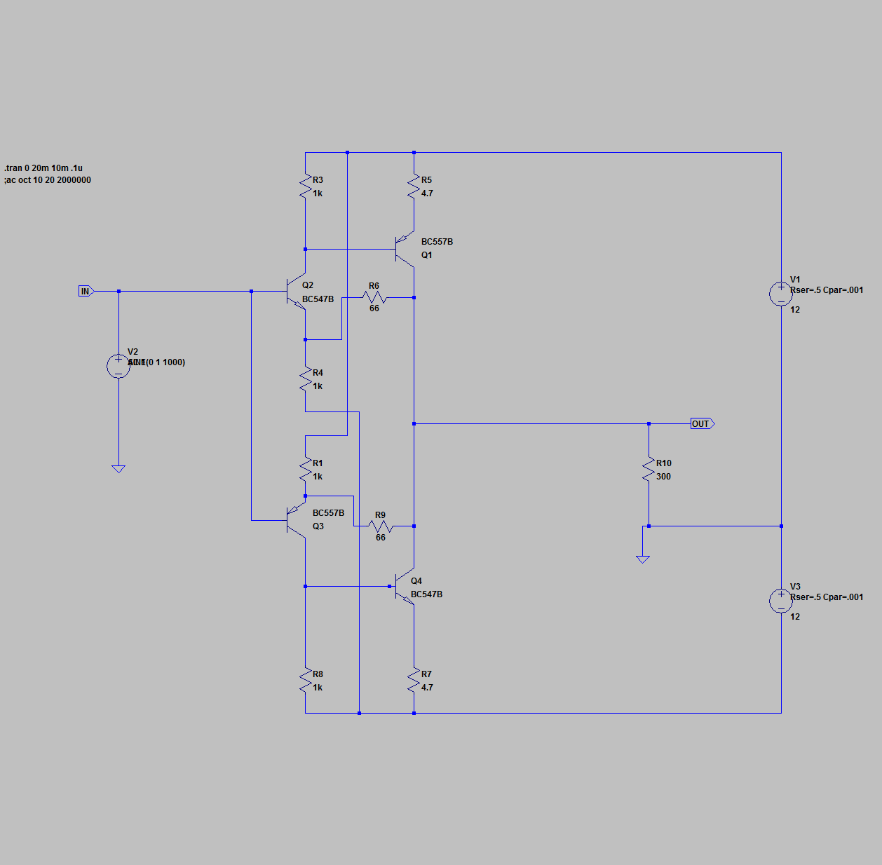

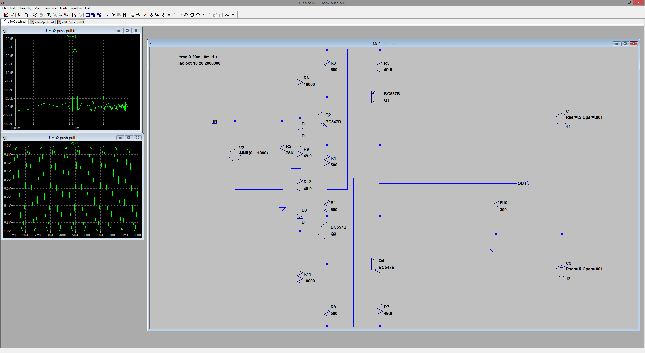

I was not aware mosfets could sound so clean.... I am wondering how a Zen should sound like 🙂
PS: Would you care to sketch the circuit you wrote about so I can visualize it properly ?
Real quick and dirty, just to prove it works.
If you are clever, I'm pretty sure you can get rid of the bias network entirely.

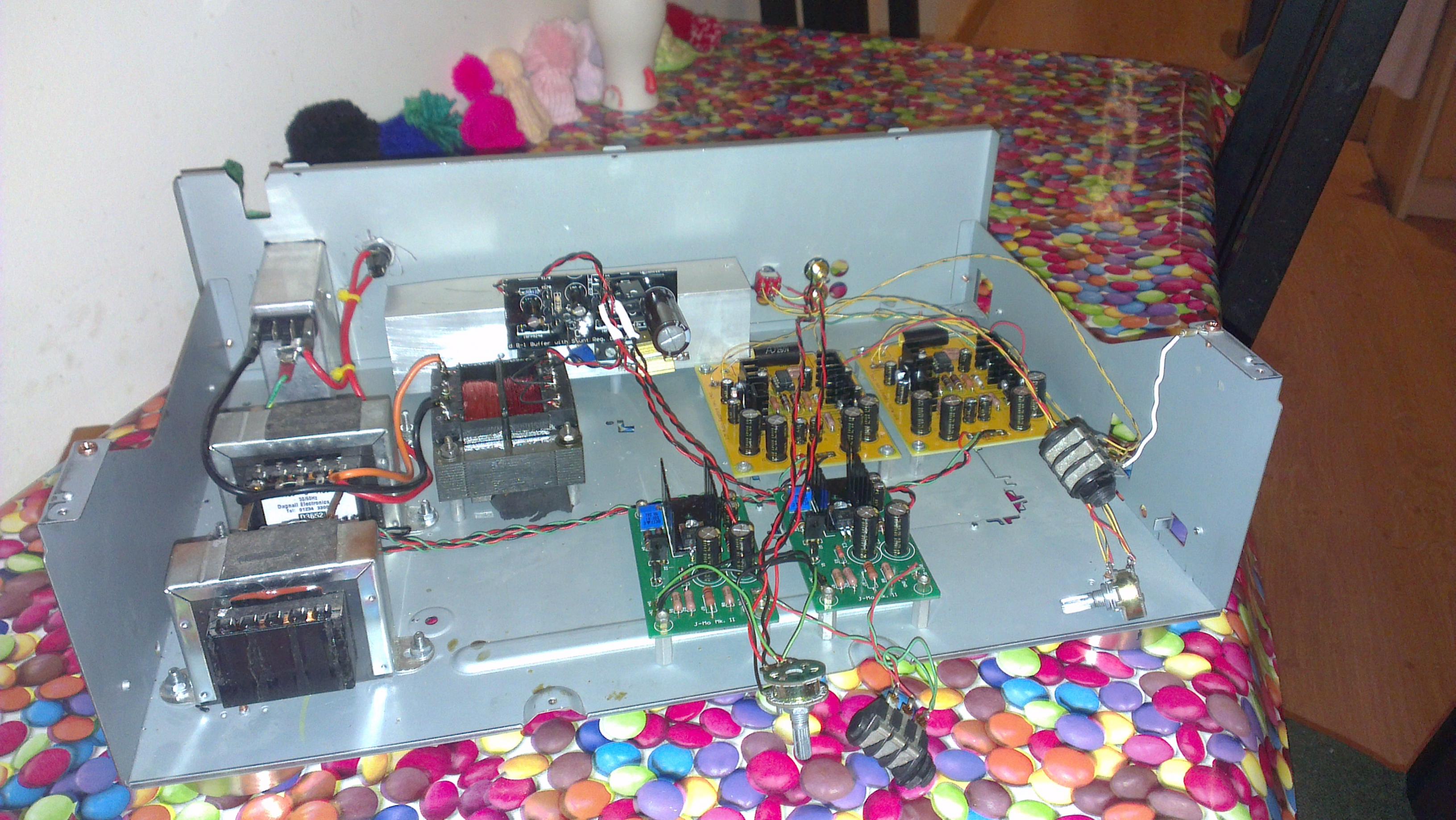

A pic.... as I said, it aint pretty. Thats the shunt at the back, the J-Mo in front of that and then the 2 boards for the Sapphire to the right. Single pair of input RCA jacks at the back with a switch to swap the signal from one amp to the other. 2 x headphone jacks and 2 x gigawork pots complete the wiring.
Both amps are silent as the grave, with just a touch of hiss on the Sapphire at full volume (which you would never go near anyway). At all normal to very loud listening levels, no hum, hiss, etc. etc. If it wasn't for the LEDs in the shunt and the bit of vibration from the EI Tx you wouldn't know it was on.
The lid has yet to go on, and of course the front plate which I have yet to make (this is a recycled box from a cassette deck).

Anyone who thinks it looks ugly is advised to wait until Fran gets started on the cabinetry. It will blow your mind.
Fran, are the power supplies completely independent after the AC line? How are the three power transformers divided out between the four amplification channels?
I like it a lot....., mine is p2p and uses two shunts with special vref and output cap arrangement 🙂
The two matching transformers (leftmost ones) supply the sapphire, one for each board. The rectifiers are mounted right on the transformer terminals. The other one then supplies both channels of the J-Mo via a salas shunt - the PCB mounted vertically on the heatsink at the back.
Nothing shared after the back of the IEC..... I'm getting lazy maybe putting it all in the one box, but it helps keep the box count down. I'm still thinking about finishing the front of it - whether I go for a wood or acrylic, not sure yet. The other thing that I might do is split the supplies for the J-Mo and go dual mono on that. I reckon I can fit it all in, especially if I stacked 2 toroids.
