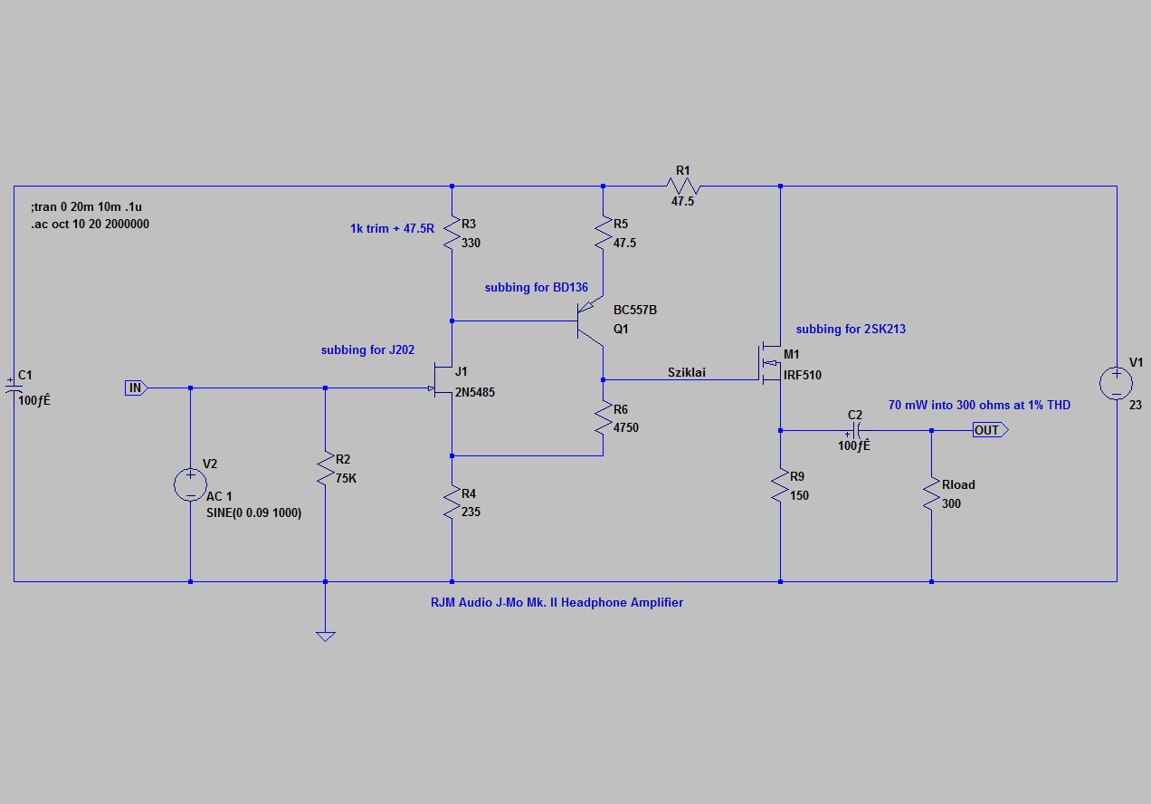

Ok, here's the circuit as I built it for myself, for HD-600 (300 ohms).
I used J202, BD136, and 2SK213. The gain is defined as 4750/235+1, but the gain programmed by the voltage divider is getting a bit too close to the "open loop" maximum so the actual gain is a bit lower than expected, about 15x. The current through the JFET and PNP are both in the 2-3 mA range.
I'm not sure what the currents in the input stage should be ideally. Of course the available range depends on the model of JFET. I've tried to adjust the resistors so that the currents in both devices are about equal.
FYI the Vs of the J202 ended up about 0.7~0.8 V.

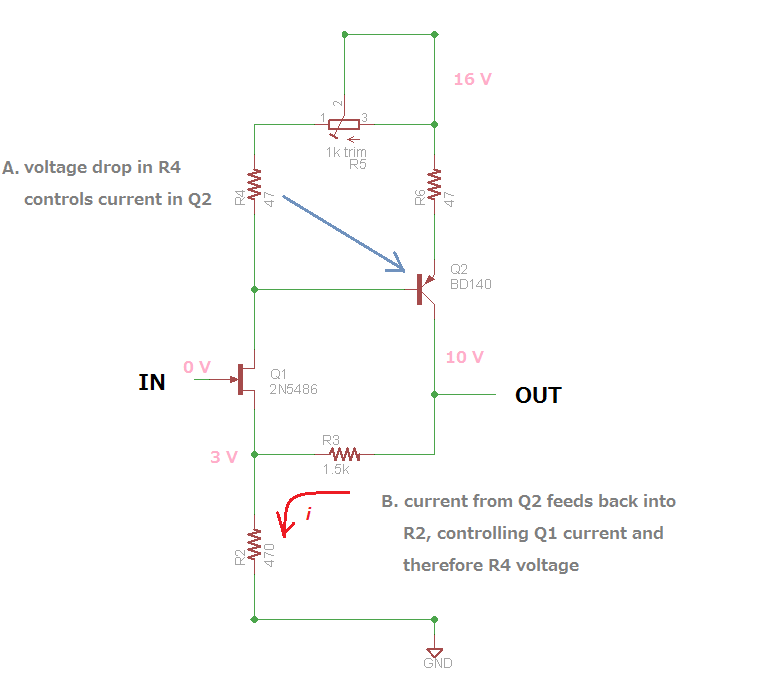

Would you please explain how first stage works so I can better visualize the mods ?
This may or may not be of some assistance:
The circuit block distorts least at unity and low gains. The distortion, however, is anyway below the MOSFET output stage, so we don't care. It's also, like the MOSFET follower, dominant 2nd harmonic.
If we did care, we'd have to do something different for voltage gain. An op amp, for instance.
Fun thought: Take the Sziklai stage above, make it unity gain, and replace the jfet with a npn transistor. Then mirror the whole thing across the ground line, so it's push-pull buffer. That's a headphone driver in and of itself, right there.
