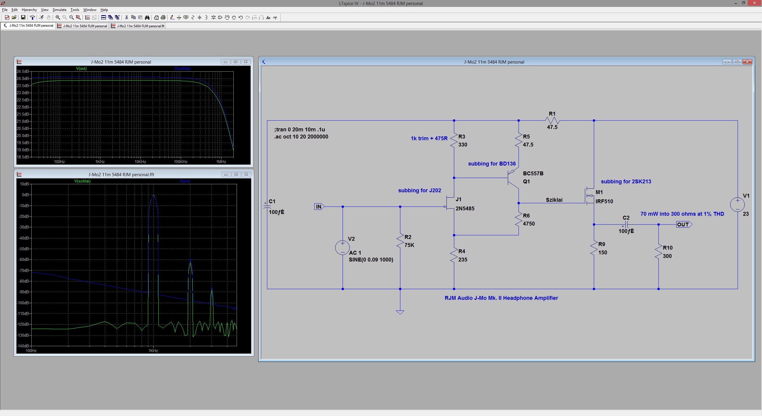

The attached is the LTSPICE file for my version of the J-Mo II. It has higher gain than the regular version, and lower bias current, optimized for 300 ohm loads.
It's good for 70 mW at 1% THD into 300 ohms. Distortion falls away as the signal voltage gets smaller. At typical listening levels, its much lower.

Fiddling around with the simulation, I conclude that the cleanest signal is generally obtained with the Mosfet gate voltage biased well above half the power supply. This is done by adjusting the trim pot on the jfet drain. Overreach however and the jfet current drops below a critical threshold... if this happens the Sziklai element has to be reconfigured, perhaps substituting a jfet with higher Vgs0, or alternatively increasing the gain.
This kind of optimization can drop the second harmonic component 5-10 dB, so its not trivial. How much different it makes to the sound though is something I'll discover shortly.

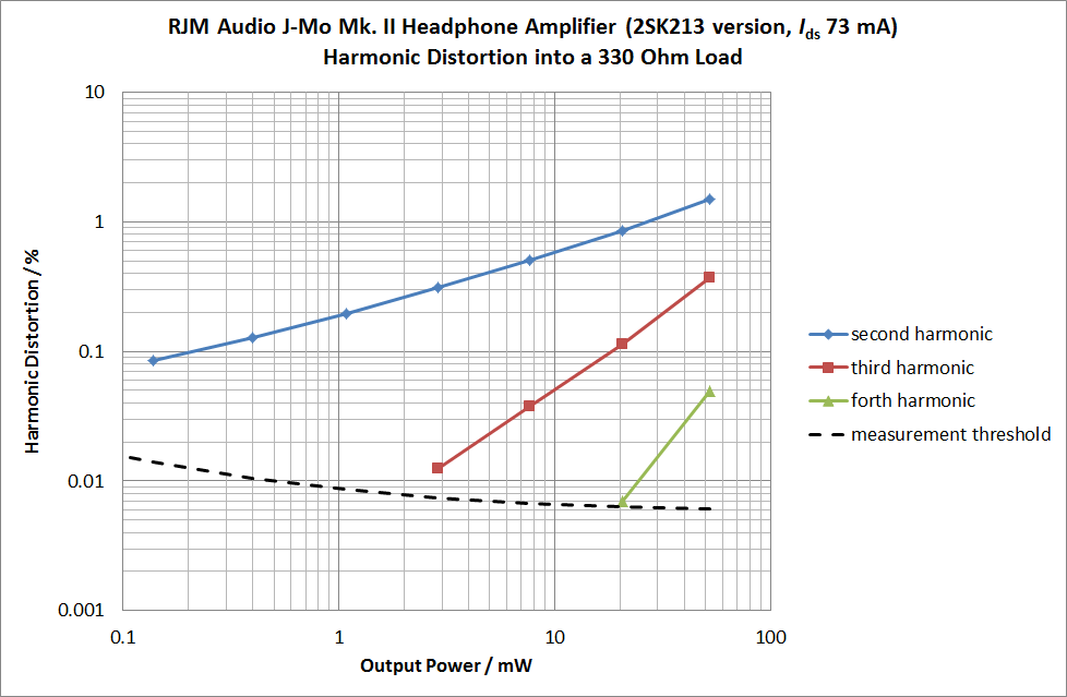

What the previous post says, in graphical format. This is real data, not simulation. By way of comparison the sapphire amp has no measurable distortion, i.e. no points above the black dashed line. However it's worth noting that real world listening power levels are not even represented on the chart, they are down at 0.01 mW where the THD is in any case about 0.03~0.05% and almost entirely 2nd harmonic...

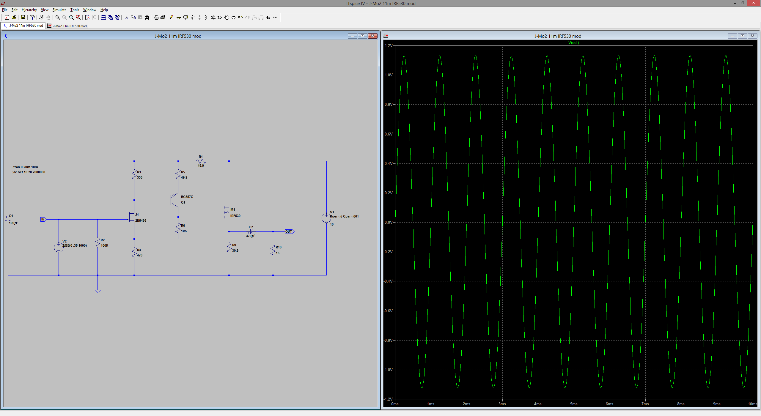

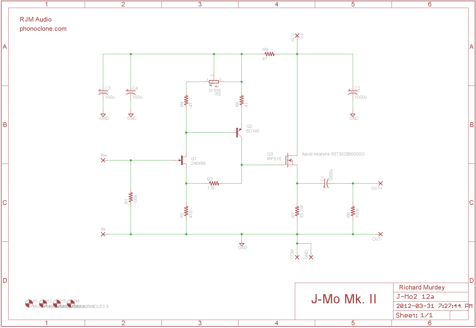

Schematic is on the web page, and included below.
Please note the LTSpice simulation part numbers are not consistent with the formal schematic and BOM.
R2 is 470 ohms and R3 is 1.5k in the BOM version.
A quick check, with the IRF530 standing in for the 640 showns no significant degradation of the bandwidth. (even the IRFP240(chosen at random) is -3dB at 2 Mhz) The BC560C should be able to drive it. I don't have a model for the 2SK170 but with the 5486 subbing the circuit works great with the BOM values for R2,3.

Ok... I finally got it working (thanks to rjm good posts... read it all and than reread)
I used a J310 and a BC560C for the input.
R2 240ohm
R3 1500ohm
I can easily set collector voltage from 1.4 to 13.9v using the 1k trimmer.
Current on the fet is 2.6mA and current on the bjt is 5.1mA
Should I expect this contraption to be able to drive the mosfet ?
Now about some détails.... I believe R9 (47r) forms a filter with caps C3 and C4.... can it be removed ?
