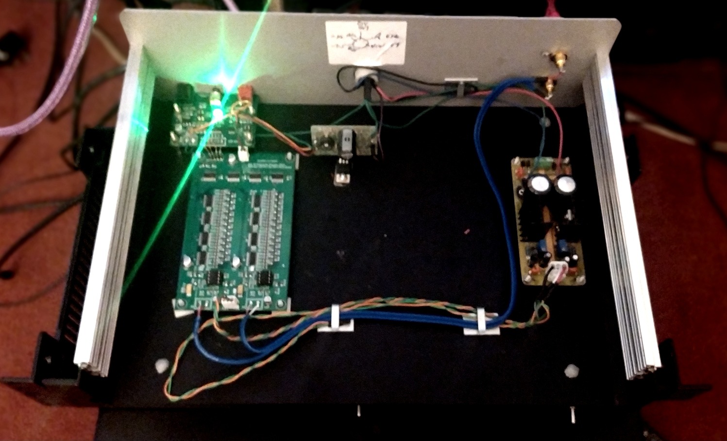

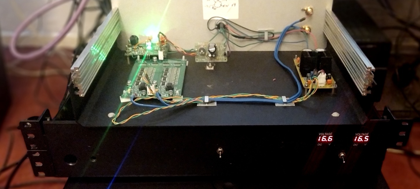

Finally reached the listening and testing phase. (left the supplied TL082 opamps fitted but have some LME49720s to try)
It worked perfectly first time (so the DIR9001 was set correctly) and with both 44 and 48k coax inputs.

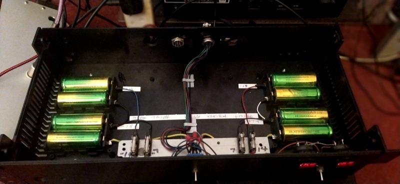

You can see my Lipo psu in the photo, which supplies + - 8 and 16v to the dac. Not yet fitted the sockets for charging the eight 3.7v 8ah cells.
I have to say I am impressed with how clean the audio is considering there is no oversampling and only the dac's 12db 24Khz filter. (Solo male classical vocals are great for showing up artefacts.)
(CD source is a Cambridge Azur 651c and 48k was from a Nvidia Shield Pro and SML USB-spdif adaptor streaming my favourite professionally recorded Youtube videos (Voces 8, Voices of Music, Apollo's Fire etc)
The Dir9001 is run from the dac's 5v supply but I will give it a separate supply
It does have a hard act to follow - the Dacmagic 1 (two TDA1305 CC bitstream dacs in balanced arrangement) is a very sweet sounding dac

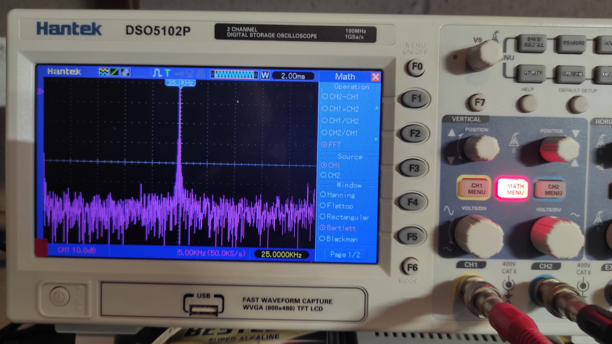

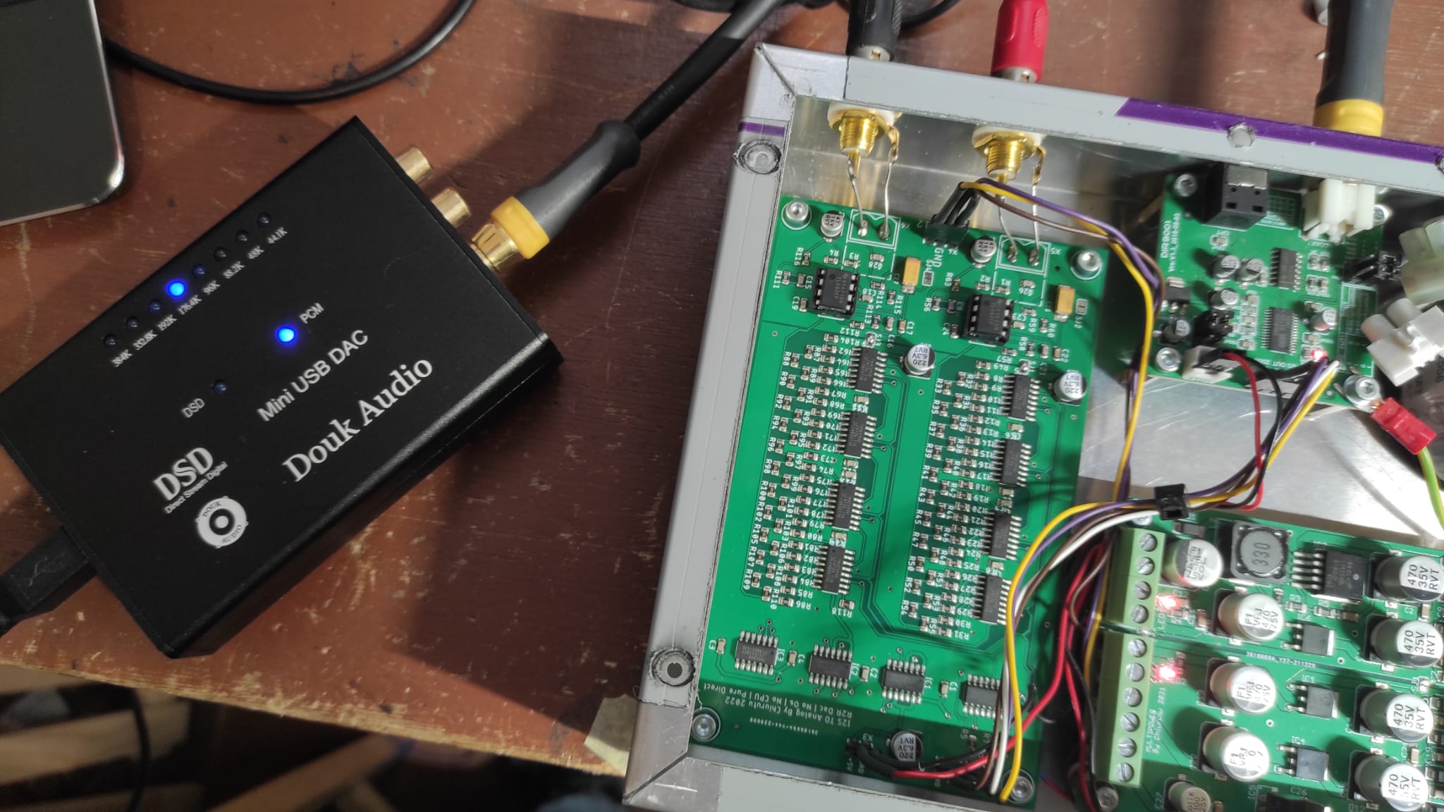

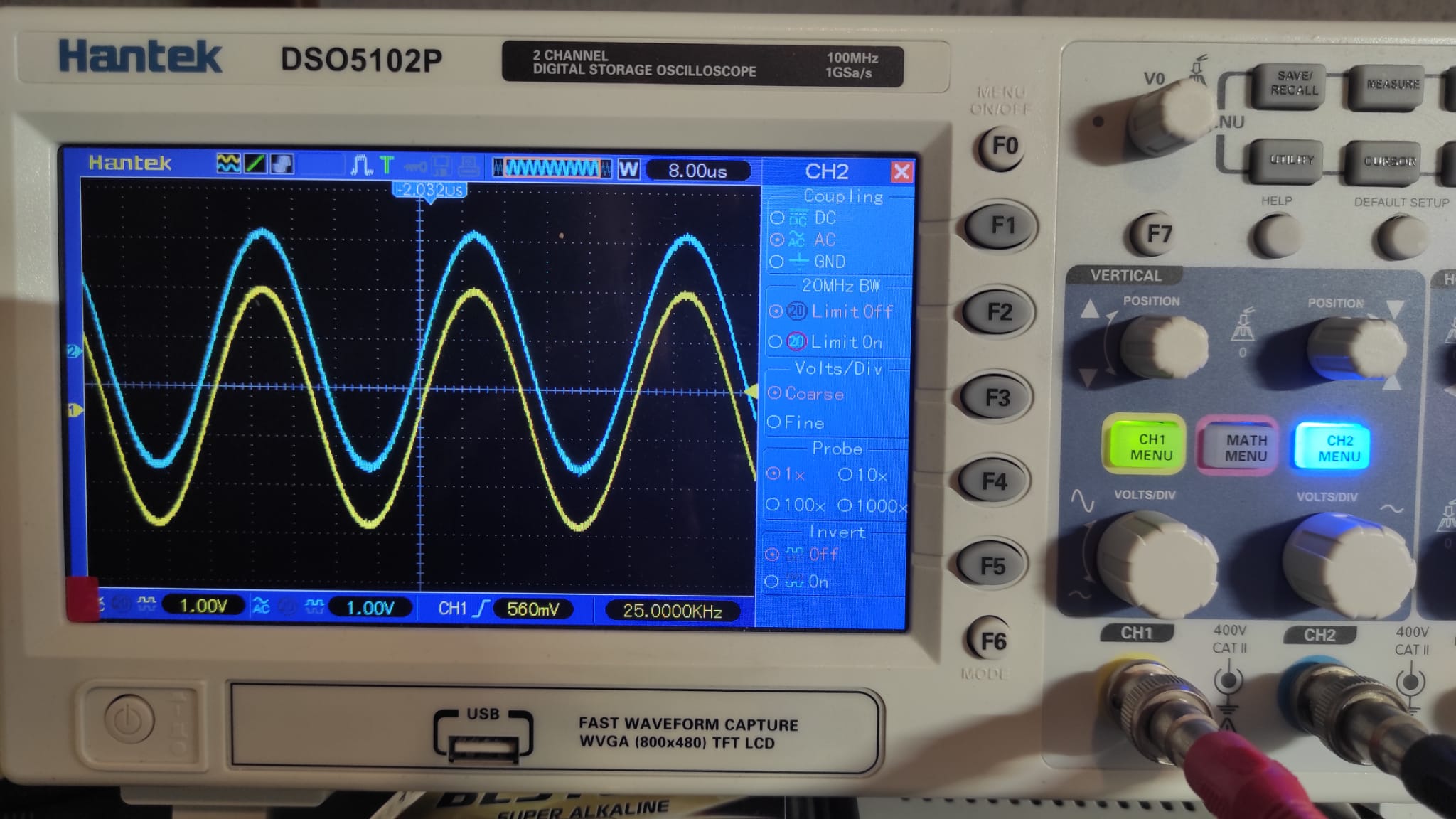

Dear, attached you will see the R2R Dac running @176Khz 24Bit No Oversampling 25Khz Full Scale Sine Wave generated with Audacity -> USB -> Spdif -> I2S -> R2R -> Analog. Basically the concept of this DAC is: No Oversampling, No Noise Shape Feedback, No Algorithm or CPU. Pure Bit as the TDA154x family but featuring up to 24 bits. As out italian Grandmaster of Sound Bartolomeo Aloia he thought (and I believe): Feedback is good for instrument but bad for ears. 🙂

Why all the format conversions? They add nothing to the quality of the sound. Why not just use the 24 or 32 bit parallel output from Audacity or other digital audio source and dispense with all the conversions and shift register nonsense?
Maybe i’m missing something but accurate clocking would require something between to gate the delay in serialising the parallel pin programming. Then you want something to isolate noise and counter any isolation delay.
