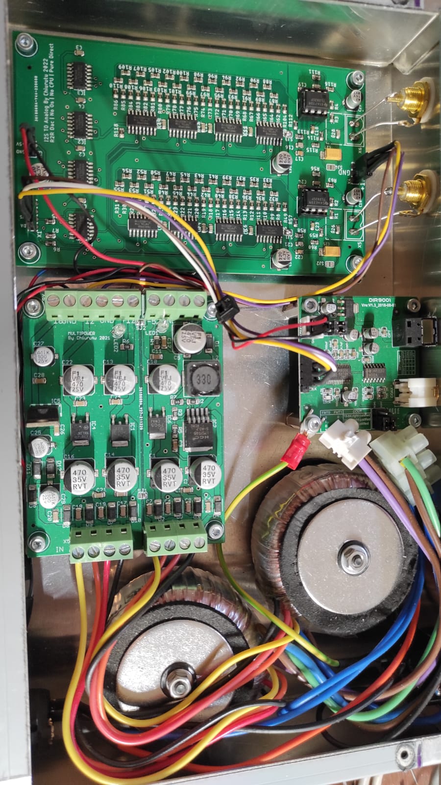

The balanced dac AD1862 is my own design fed from an iancanada I2S to PCM board & DIR9001 spdif receiver. (I haven't yet assembled it)
(Chips are from Rochester via a group buy on here a few years ago)

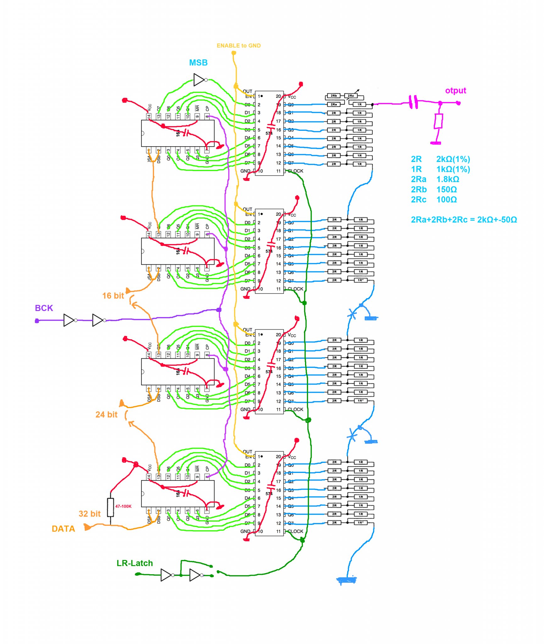

I build this one for 32bit word just to test. It was 4 modules for stereo balanced version. Also tried paralled SE.
Working good but maybe 24 bits are enough. Probably digital noise will be smaller.
Value of resistors are not fixed. Someone said the 1mA from "1" that is 5V to 0V is ok that means 5K...
2R value is "last" "R*" so if You are cutting out for the 24 or 16 bits last R in ladder is 2R value
I left R2R ladder removable to try with smaller tolerance resistors. (I never had time to try that 🙁 )
So I tested with 1% Rs, The distortion @-60db digitaly attenuated is present and You can even har it in the headphones expecialy. MSB trimm and even MSB-1 trimm are welcome BUT it not solve the problem.
So there is a must to use at least 0.1% or even better 0.05% R

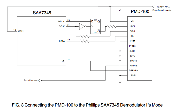

Dac input format is Left Justified
So please take a look at PMD100 datasheet to find I2S / LJ simple circuit. . I use that before this DAC with Amanero USB/I2S interface. Or use double FlipFlop in series, but without inverted BCK that will "delay" LE for one BCK...
DAC is R2R voltage output type. Output resistance are R. This is from merit for optional analog output fiter.
DAC is easely capable to 384KHz SR probably more, very fast reaction for SR change without clicking.
I build it on the test board point-to-point without classc PCB.
If You use single 8X 574 logic IC for each bit You can acheive 8X smaller tollerance of used R.

I should start auditioning the dac in a day or two, so hopefully the pcb has been designed correctly with regards to the ground and power rails/planes.
