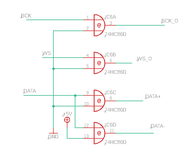

Hi, attached my method used for to have dual digital data for dual dac and balanced output. In my opinion very simple.
Stefano

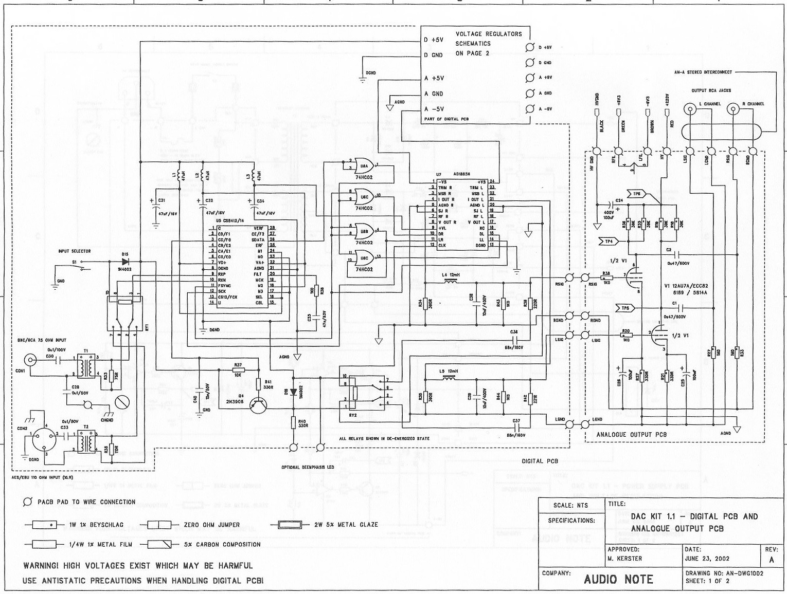

That's similar to how Audio Note separate the data into L & R for an AD1865

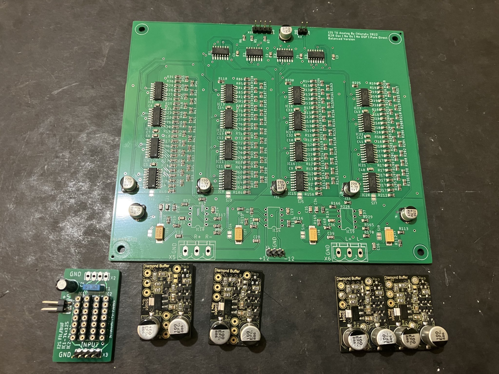

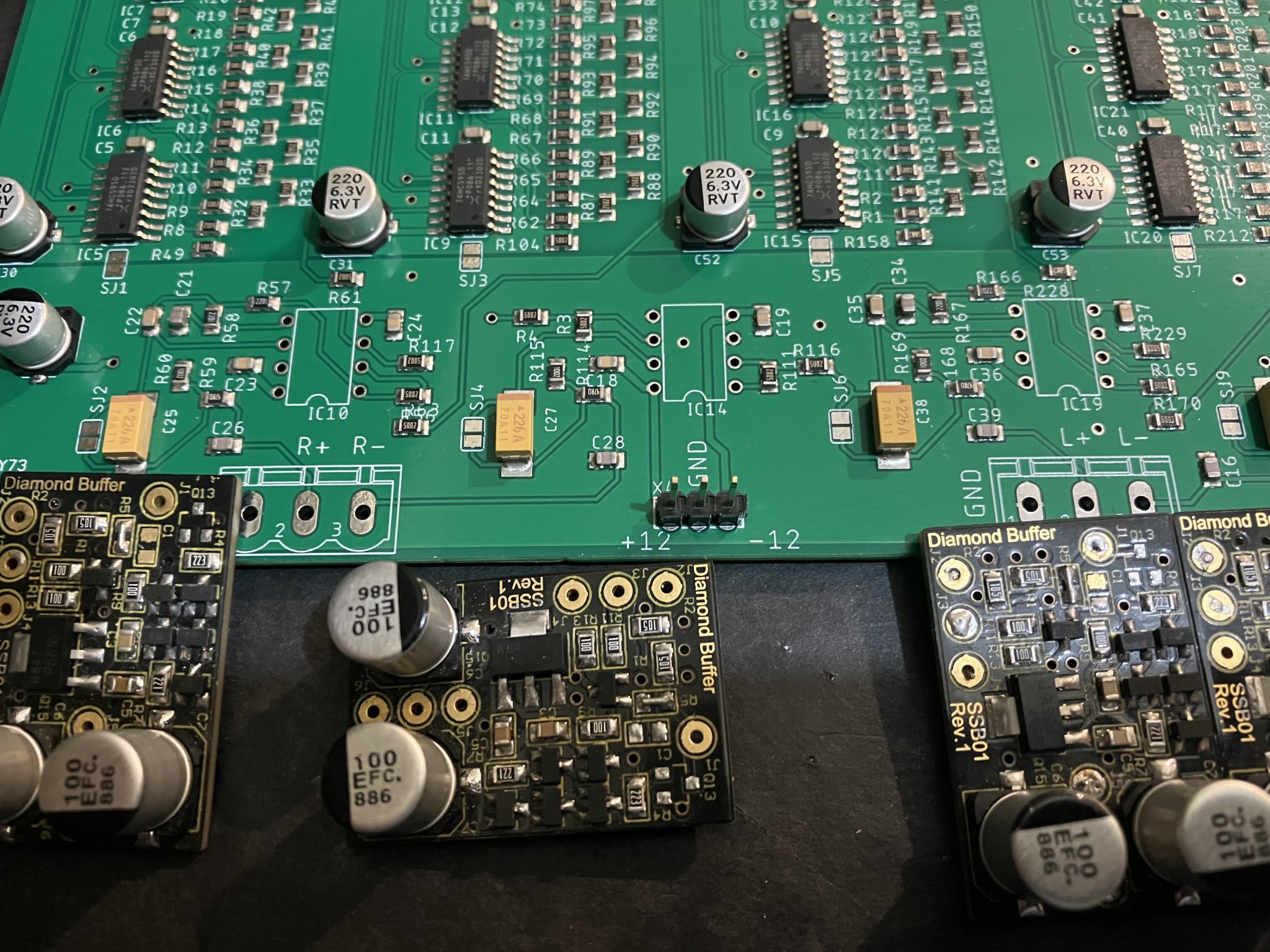

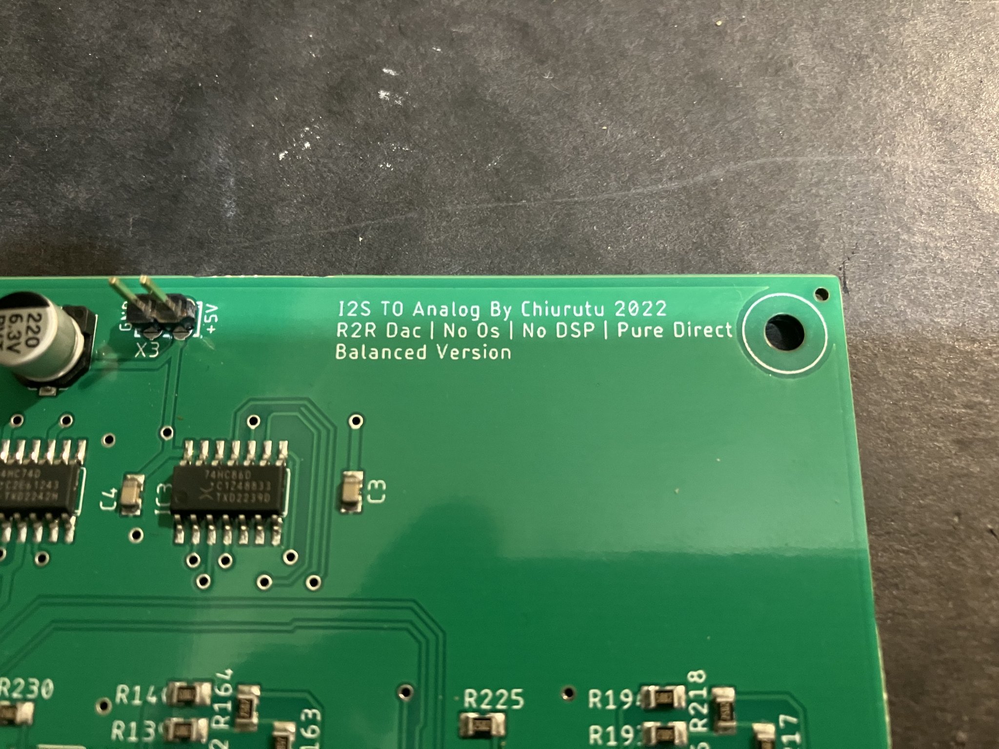

Just bought the balanced version of this, will be using Amanero USB so hopefully plain sailing. Stefano threw in a buffer / filter PCB in case of problems with Amanero.
Output will be discrete diamond buffers and may try Muses balanced volume from Meldano.

I'm tempted to also buy the balanced version to use with my Sowter I/V transformers and a DIR9001 usb-i2s iterface.
I see the output opamps are not fitted to yours which I also need as the transformers connect to the dac output directly.
Chiurutu, what are the direct ladder output levels and will they drive a transformer (low Z) input?

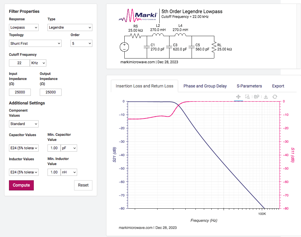

The value of the R=25K so this is the output resistance of DAC. This is quite high value and will be not sufficient to dive the transformers in low end among other issues. So the buffer for the low output resistance is needed. In all cases of load. This is simply very high output resistance...
Higher than most of the SE stages tubes has...
Maybe this 200ohms is too high for the solid state buffer? Please check that info?
That is almost exact value of buffer with catode folower with ECC88 tube? 🙂

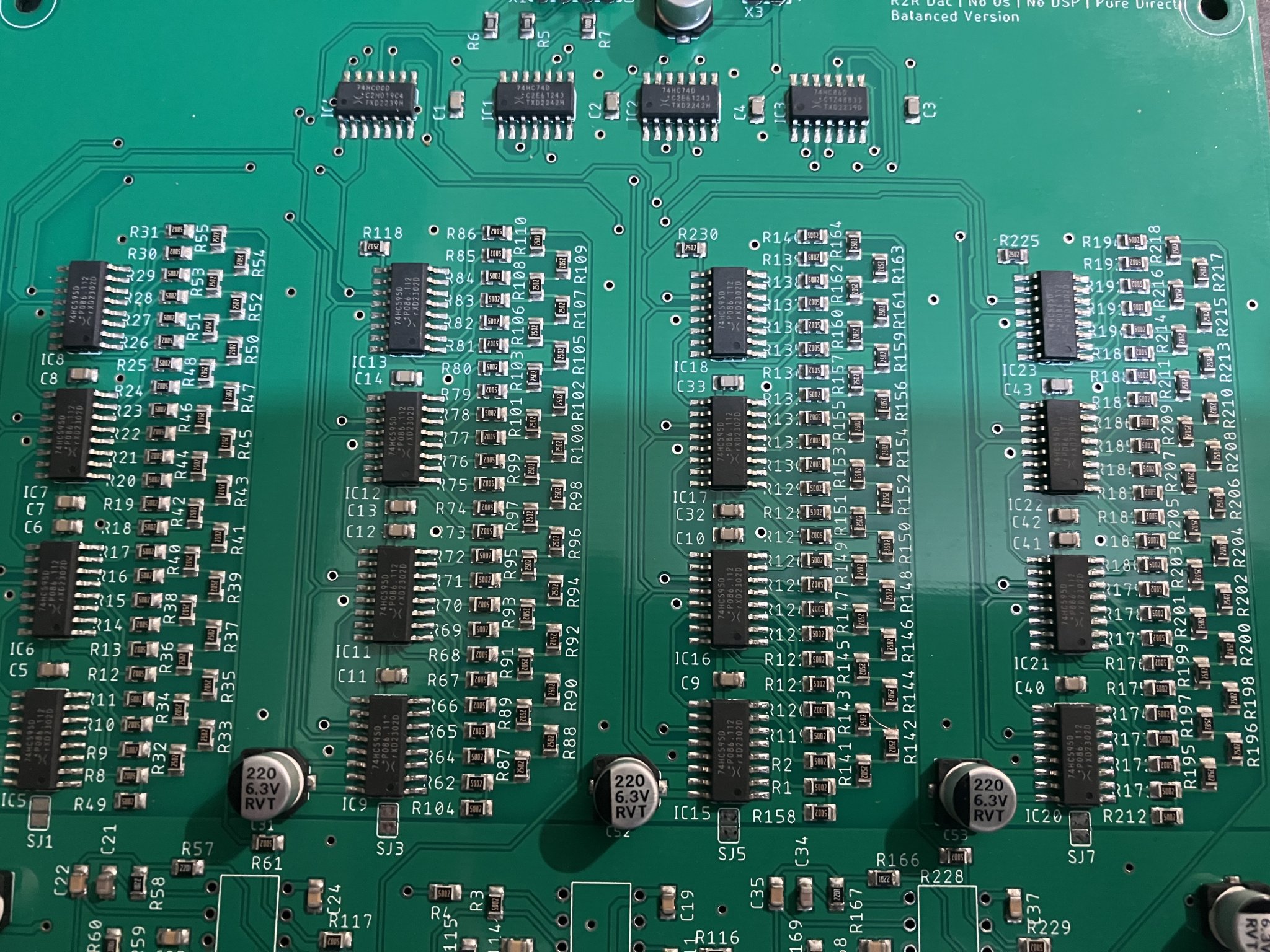

Actually this dac is 32 bit word converter. That is because all 4 x 8bit = 32bit shift registers '595 has R2R ladder network. With 24bit word rest 8bits (up to 32bits) are zeroes so there is no switching, but anyway 32bit going to conversion...
Voffset at the output of DAC at MSB point R2R ladder is typicaly 1/2 V+ of power supply. That will be 2.5V for 5V supply. So the buffers will ned a coupling capacitor. Value of this C depending on R at the input to ground...
More, my diskrete dac tested up to 384KHz sample rate doing well. Changing Fs samling rates in computer settings followed almost instaeniously converting and playing music. Without clicks or pops. There was a case ONLY with TDA1540 dac Any other dac was slower in these terms with same USB-I2S interface and computer. Among that these two dacs was converting 20KHz square wave into almost perfect analog 20KHz... All other - not.
So this dac probably will be the same.
I was planning to not have a SS output and just connect the ladder output to the input of the X10 which is about 470k Zin through a .33 capacitor.
Output is 200R to drive the Sowters. One X10 pcb per channel. No gain but the Sowters provide this.
I built a second X10 using local components instead of the supplied Chinese ones. The performance at 1V RMS output into 3k load is slighty better at 0.015% THD at 1Khz compared to 0.019% using the Chinese parts.
Check (measure or simulate) sowter Lp (primarry inductance) with Rsource of 200 ohms and see what is roll-off in the bass region... And phase too. Will be clear at first site...
Reactions: batteryman
With the X10 driving the transformer with the secondary loaded by the 22k input Z of my Behringer audio interface, the output drops to -20db at 30Hz.
Using a Picoscope instead, with a 47k load, the output is -3db at about 33Hz so I will either have to buffer the transformer output (preferably not) or connect to an amplfier with >47k input Z. Fortunately the NAD326bee I use as a preamp has 100k Zin.
You have to buffer input to the transformer - primarry.
DAC-filter-buffer-transformer
