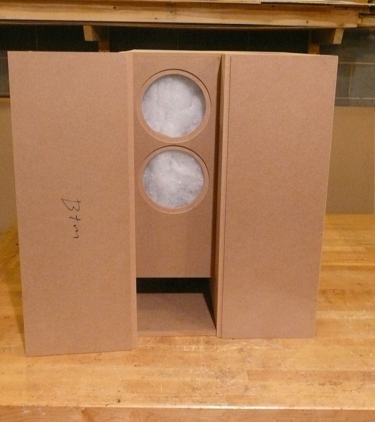

It will work just fine. Do you prefer a single fold that's somewhat simpler to build, or the double fold style shown in these threads? What material thickness do you prefer?im not sure, most people have said they dont model well so ive got someone designing me another L ported box, but if you've got another idea ?
i dont really mind the folds, how ever many it takes to get the best sound i'll do it and i use 15mm or 18mm mdfIt will work just fine. Do you prefer a single fold that's somewhat simpler to build, or the double fold style shown in these threads? What material thickness do you prefer?
yeah we get 18mm here, i use a wood cutting service at "homebase" in the uk they cut the sheet for about £40 here, which isnt bad for a hole sheet plus cutsDo you have 18mdf over there? Not sure we do here in the USA, but 18mm is available in medex. btw, medex cuts wayyy nicer, doesn't fly around the room as much, well worth the extra $$ and lead time.
Looks familar. You'll want to get the rips for the folds all the same, or as close as you can get them. What tools do you have on hand?
