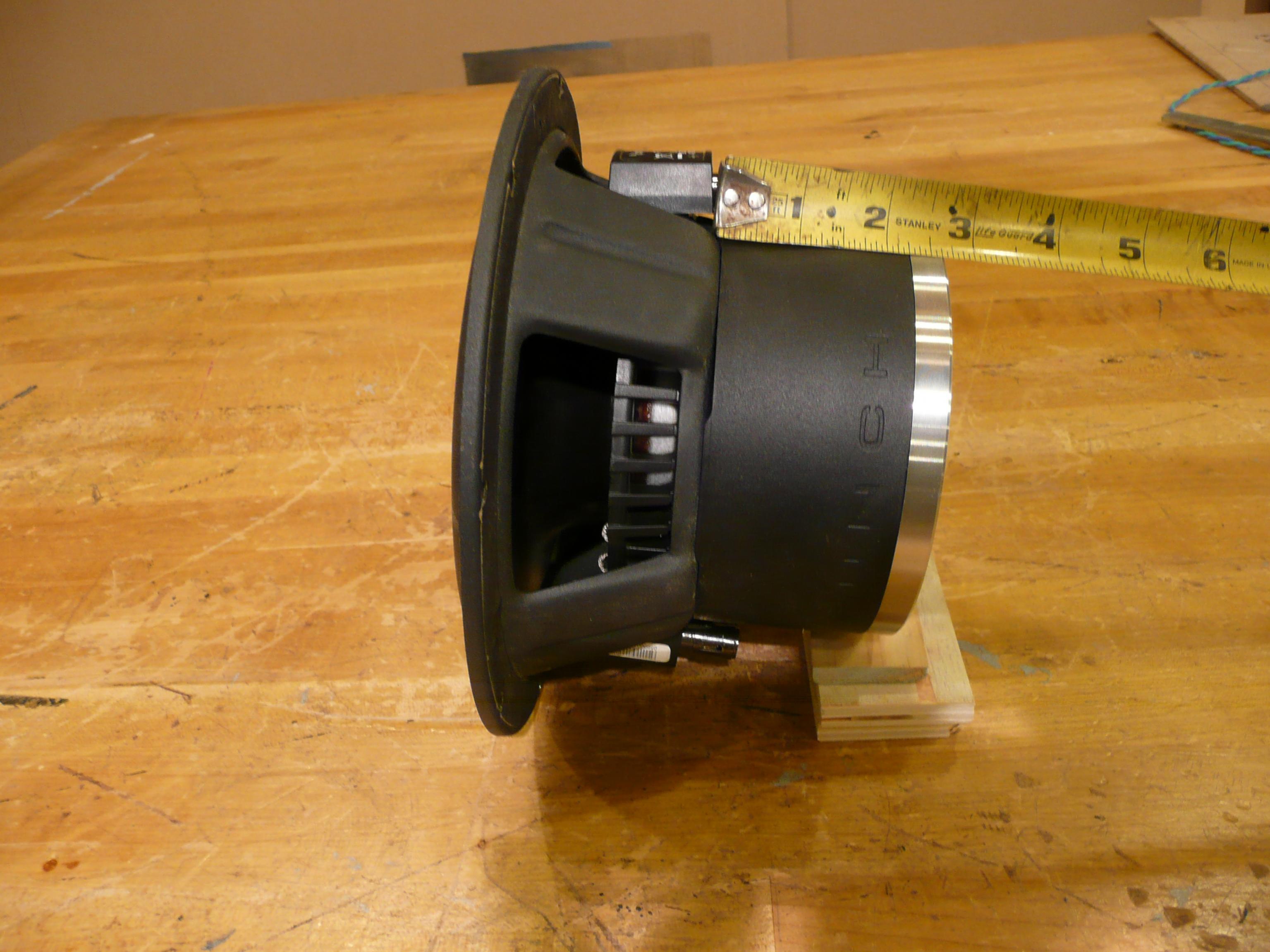

I don't know if the cover comes off. If is does, I think the magnet is deep. Funny though, a good 1/2" of coil is showing (can see it in the pic).
I guess it could be removed, but would still have 4" (only 3/4" shorter)
The cover comes off. If the image I've seen of it is correct, you'll find a smaller magnet inside.

Is there a rear angle view, so we can see in a vent or something?
It's really that deep, its a inexpensive driver, it bottoms out really easy too.
I had a few they are junk.
The 2" rubber would come off, but not sure about the aluminum piece.

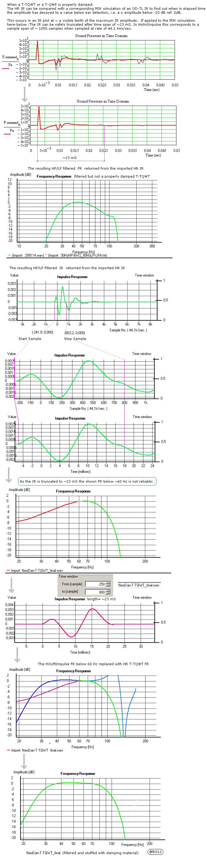

Wow that's quite drastic, and good. It has extended a heap and flattened a lot. That's a huge improvement, I never thought it would be that much!!Hi,
Here is a supplement picture to post#105 that show the simulated 'heard' effects of damping the sub properly:
