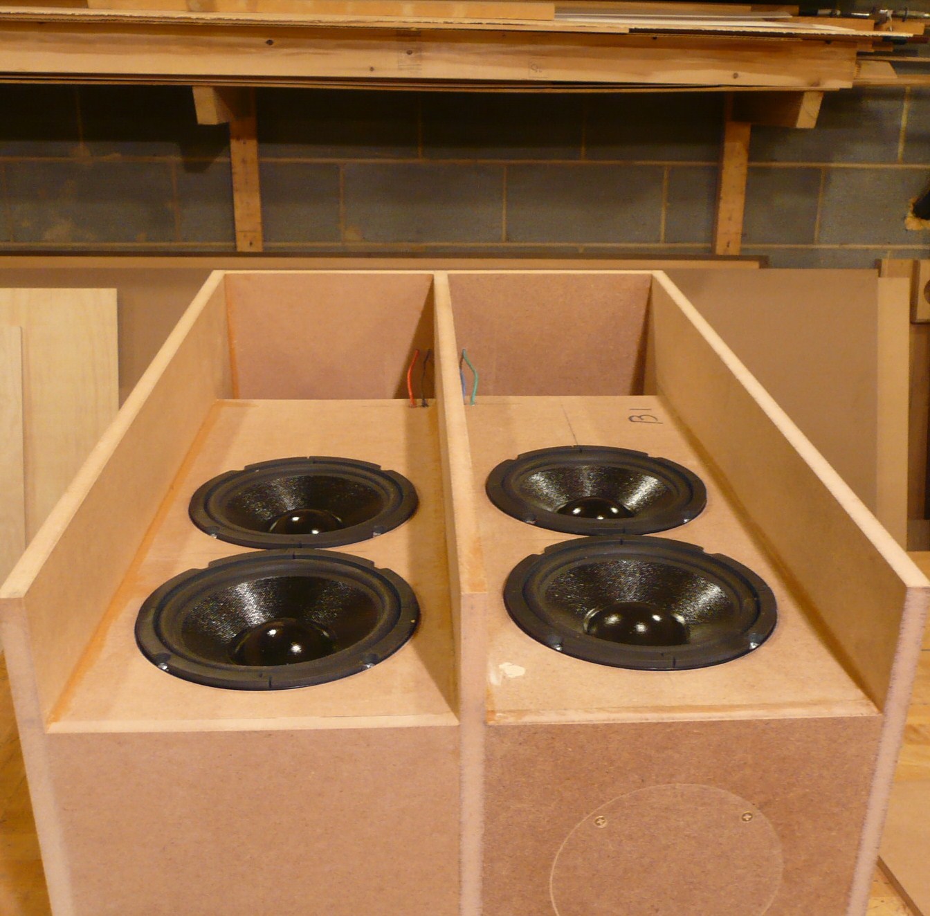

Progress Pic..
I found it is good to glue the horn before attaching; scrap wood holding it 90 degrees while glue sets up.
*hope that is the right name :-/

I almost have that now, only one bottom panel....on one of them now.
Probably gule that last panel up later today...I could plunk it on the existing one, with or without the last panel.
However, I think I get better results with the mouth at the floor (up 2", sitting on foam pads).

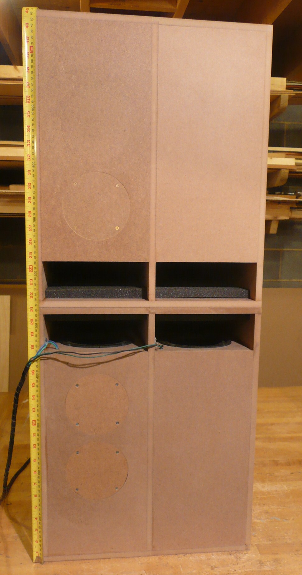

Just finished:
A little goofy, but they were built at different times, etc.
Surprising amount of bass, and I've been holding back on the volume.
8 woofers x 2.75lbs = 22+ lbs of "speaker". I wonder what the cone equivalent would be.
The bass is very fast; I saw bjorno's chart, but nothing to compare it too.

Sofa Box???
This was/is a fun build, it does shake the room, more than you would guess. The double wide box seemed to be stronger than two singles (but I did use thicker wire and a one-to-one connection).
I had a couple of ideas; maybe make a "tall" single; i.e. instead of double wide.
Plan: Build a double tall box; which should be 41" tall if the two "bottom" panels are removed.
The mouth would be 6" which would be good. Although that said, I do like the 8" x 12" piece of foam at the mouth. A plus would be that two drivers could be installed "upsidedown/backwards".
