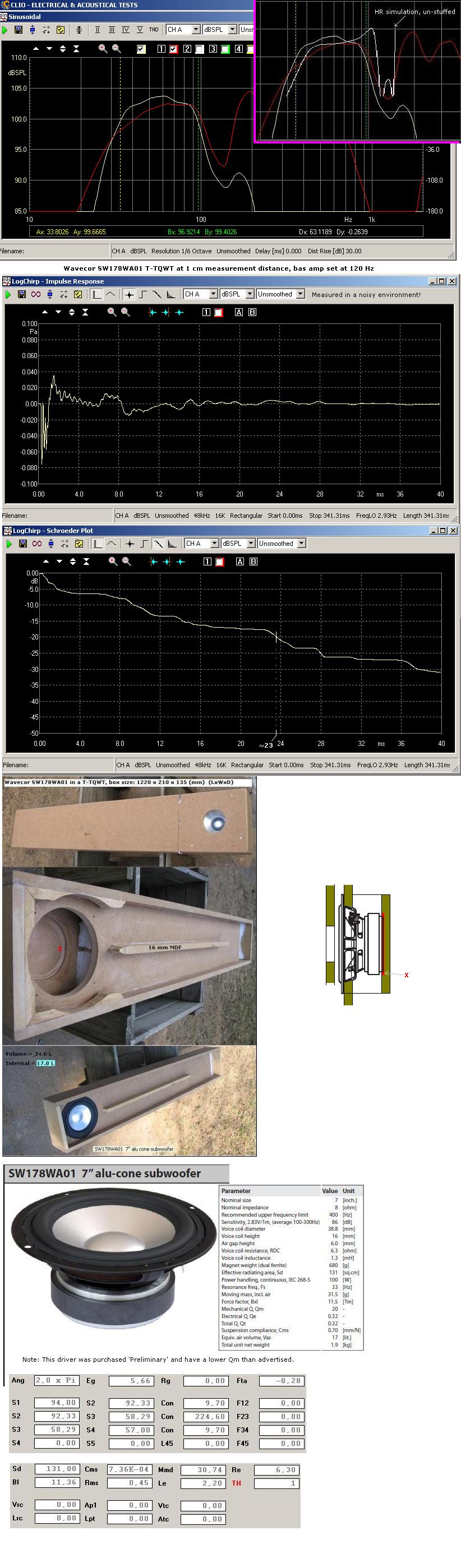

Wow that's quite drastic, and good. It has extended a heap and flattened a lot. That's a huge improvement, I never thought it would be that much!!
The heard improvement is IME real. When I measured* a T-TQWT sub placed at a kitchen floor the presented FR and IR didn't correlate to the absolute smooth sound I heard when only listening at the T-TQWT throw a simple plate sub-amp.It sounded absolute flat(despite the also easy heard refrigerator hum and noise).
*= The submitted picture:
b🙂

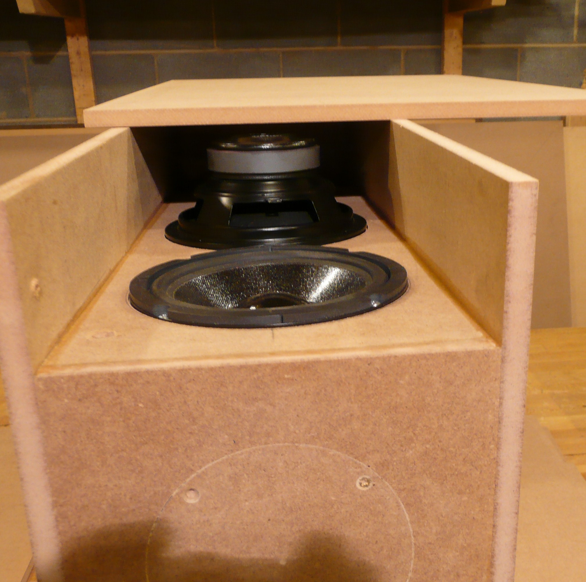

I made a few minor adjustments to the new boxes; they are sounding very nice, way better then expected. The bass is quite powerful and lowered the output setting 10db.
I was really only looking to build a "computer sub" but this went well above that.
The hookup was also somewhat easy, only using the 80Hz sub out from the HT processor right to a stereo amp; 4ohm per side.
I will hook them up the generator, just to get an idea where the bass drops off/out.

I see....that does bring up a question...do some mount the woofers "backwards" as you have shown. I like that idea to help attenuate the "highs". (xover is set at 80hz)
It seemed like that would good idea.
btw, rebuildng one this weekend, another double box.
Hi ODougbo,
Reversing the physical layout of e.g.: every other woofer would result in a reduction of distortion, and with the 8x arrangement you have enough room in the combined duct. Naturally, when one inverts a woofer physically one has to also invert the input polarity to that woofer, so that all drivers operate in unison.

I found that 4 (drivers) on one side of the room and the other 4 (drivers) other the side works the best. That's the way I had it before.
It's a nice little woofer to mess around with, i.e. shallow, good terminals, rubber suround.
It would be fun to build a Iso box, say 4 drivers, where the 2 are now.
