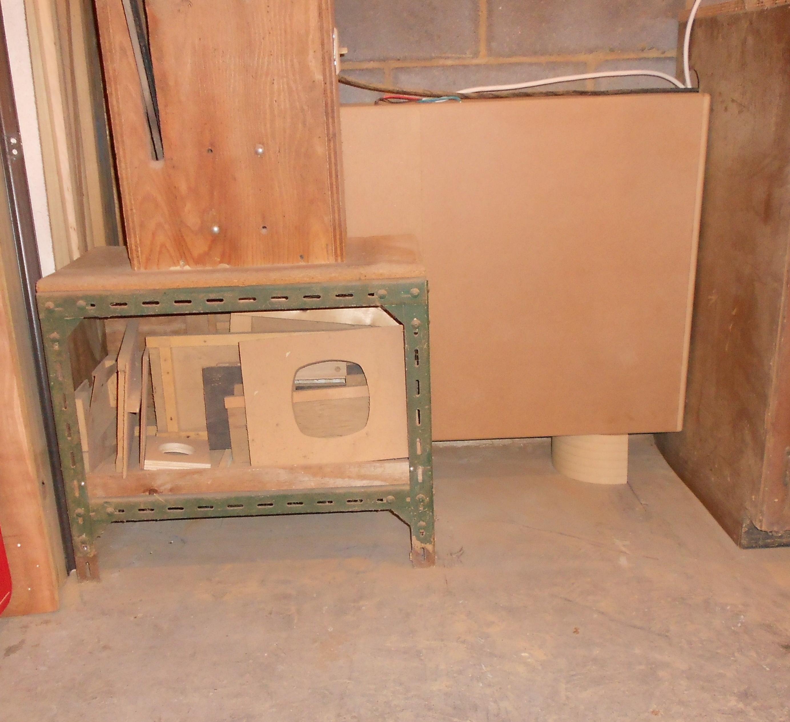

The 6.5" T-TQWTs have a unique (detailed) sound and still loving them.
What a deal:$25 sheet of MDF, and 4 - $8 woofers (PE).
I do need to build one more "standing" box (4 woofers left).
