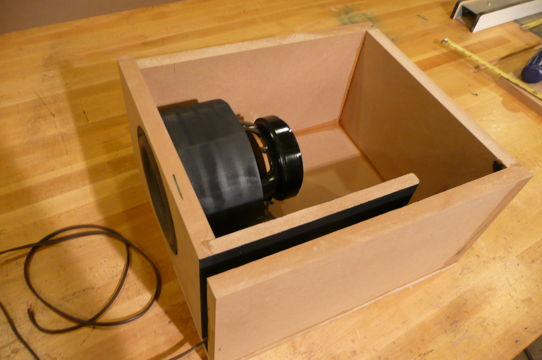

It's not my sub in the picture. It's one Odougbo made about a year ago.

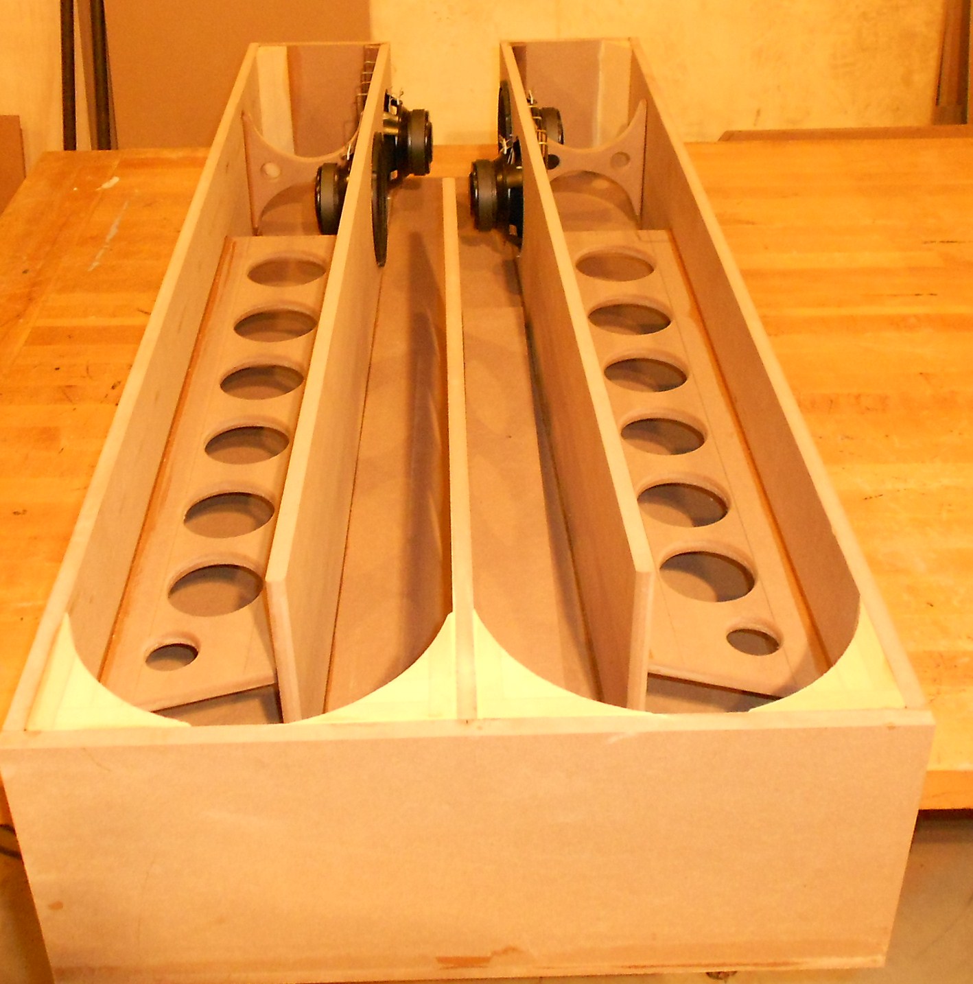

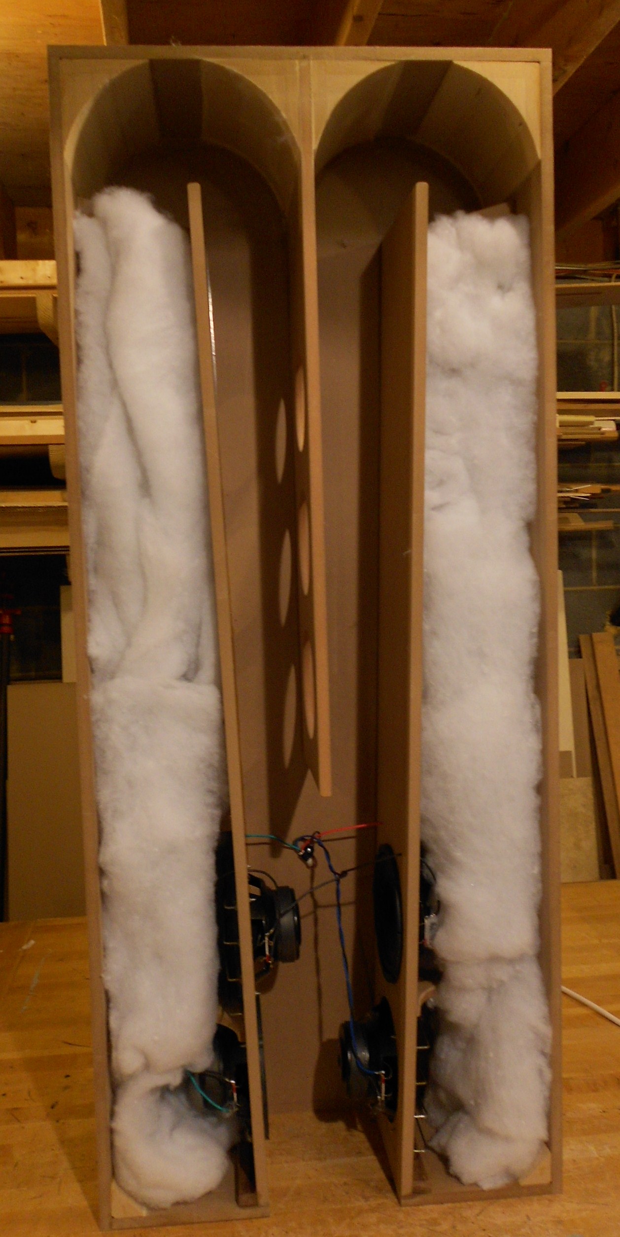

Thanks for the nice pictures. Have you tried different stuffings, e.g.: thinning out the suffing density as you are going away from the speakers, and carrying the stuffing to the middle (or around) of the corner?

so a few months ago i bought the q acoustics 2050 subwoofer, and now they've had time to break in ive noticed i get so much port noise even at low volumes, and its the most annoying thing ! so im thinking about removing the drivers and amplifier, and getting a nice box design done for them ?I did try to graduate the fill; not easy...gravity may help over time (-;

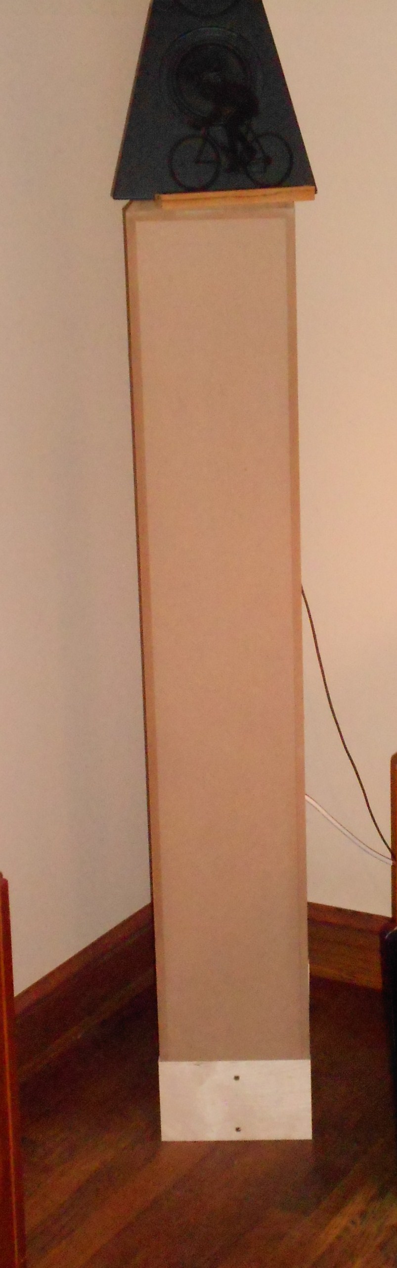

I put the new tall box (2nd) in the opposite corner of the room, I was a little disappointed, there is too much boom, sounds a bit intense instead of a nice bubbly flow. They do make nice rear speaker stands.

Dan, here's a new pic (no fancy feet this time - will cut soon) the combination of the corner and the flanking desks are creating boom (plus the 4 wire cable is 25'). It is a little better now, since I moved things around. I don't think the boxes sound different other than the tall ones point down and fit tighter in the corner.
I did have to lower the bass setting quite a bit when I made the switch; 4db according to the menu.

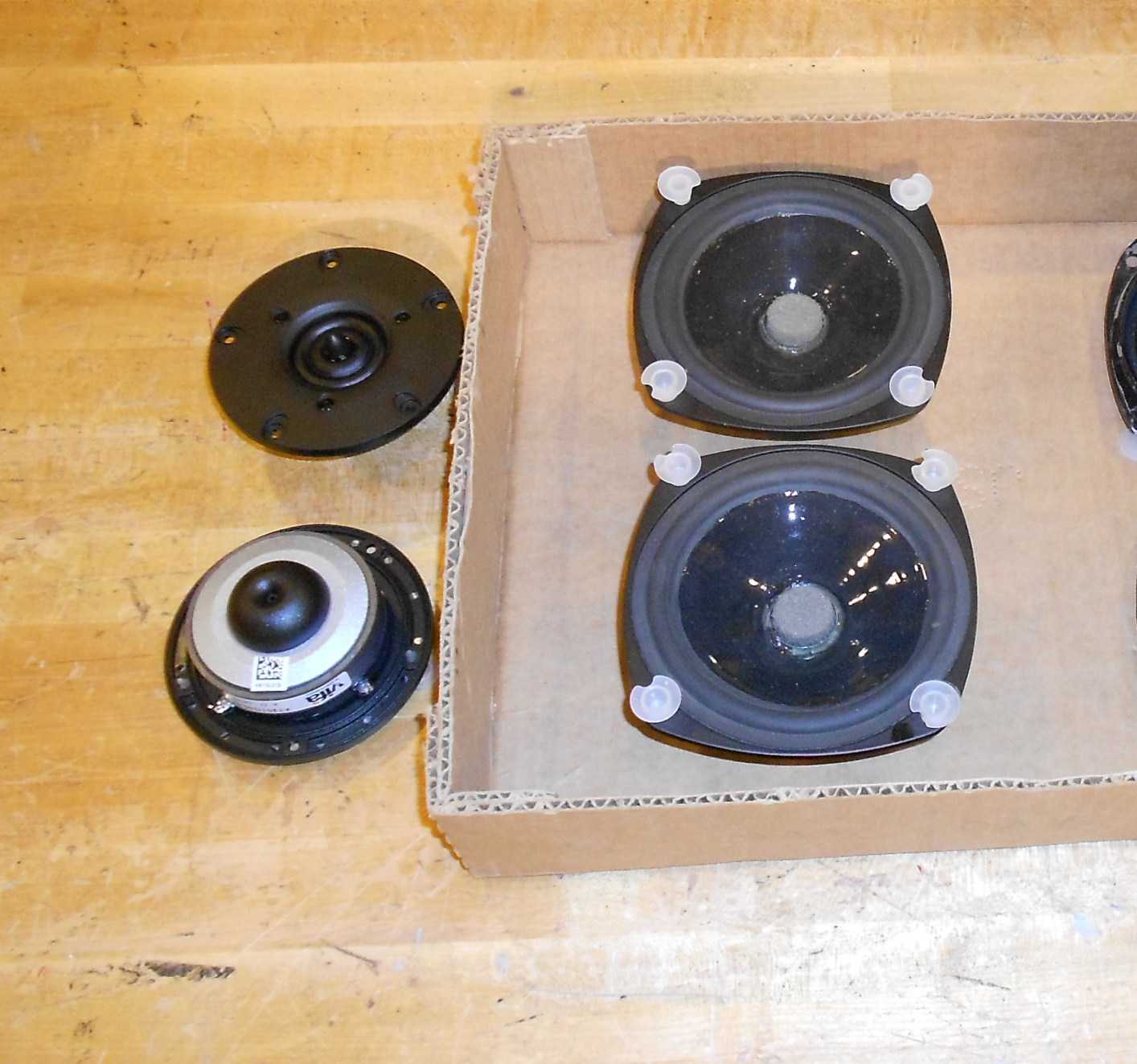

btw. thinking about making new rear boxes, that fit/angle better. I found a pair of 5.25" 1591"s Peerless woofers (super old but never used) and I have the new vifa tweeters. Would love to have a 12db crossover, but doubt that I'd get that right :-/
