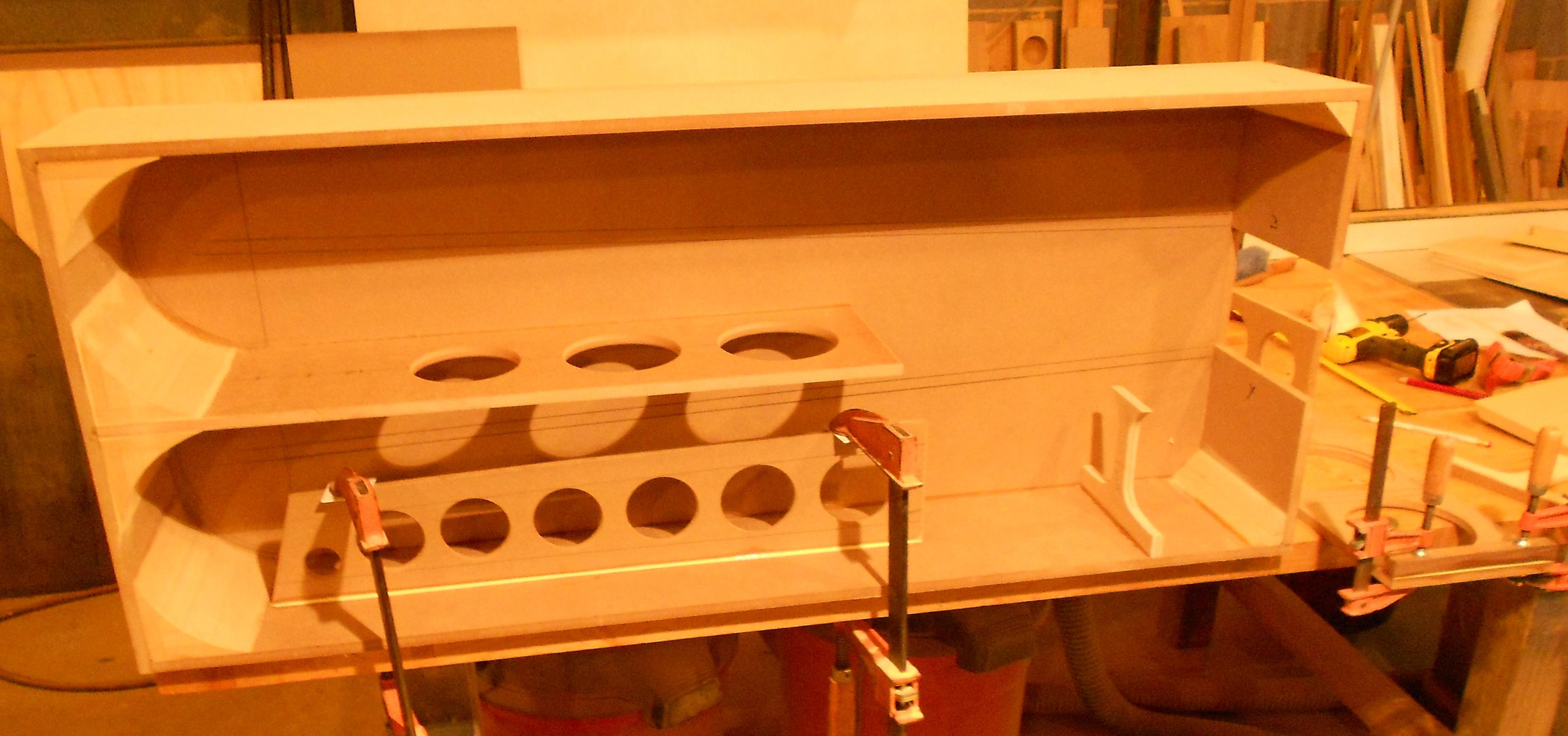

One sheet of 1/2MDF, only a couple of small pieces left over. I did have to glue 2" to the left and right "long" sides, which will have reinforcement anyway.

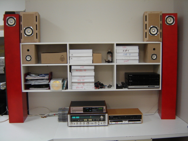

im looking at getting a pair of fostex fe103en's and building a horn using plans on the internet, i know most people use tube amplifiers for fullrange drivers like these, so would my denon pma710ae be okay ?Here are tb46's plans, took me a while to find them.
I tried building several pairs of full range, I found that the very 1st receiver I ever bought worked (Sansui 7070) the best to drive them.

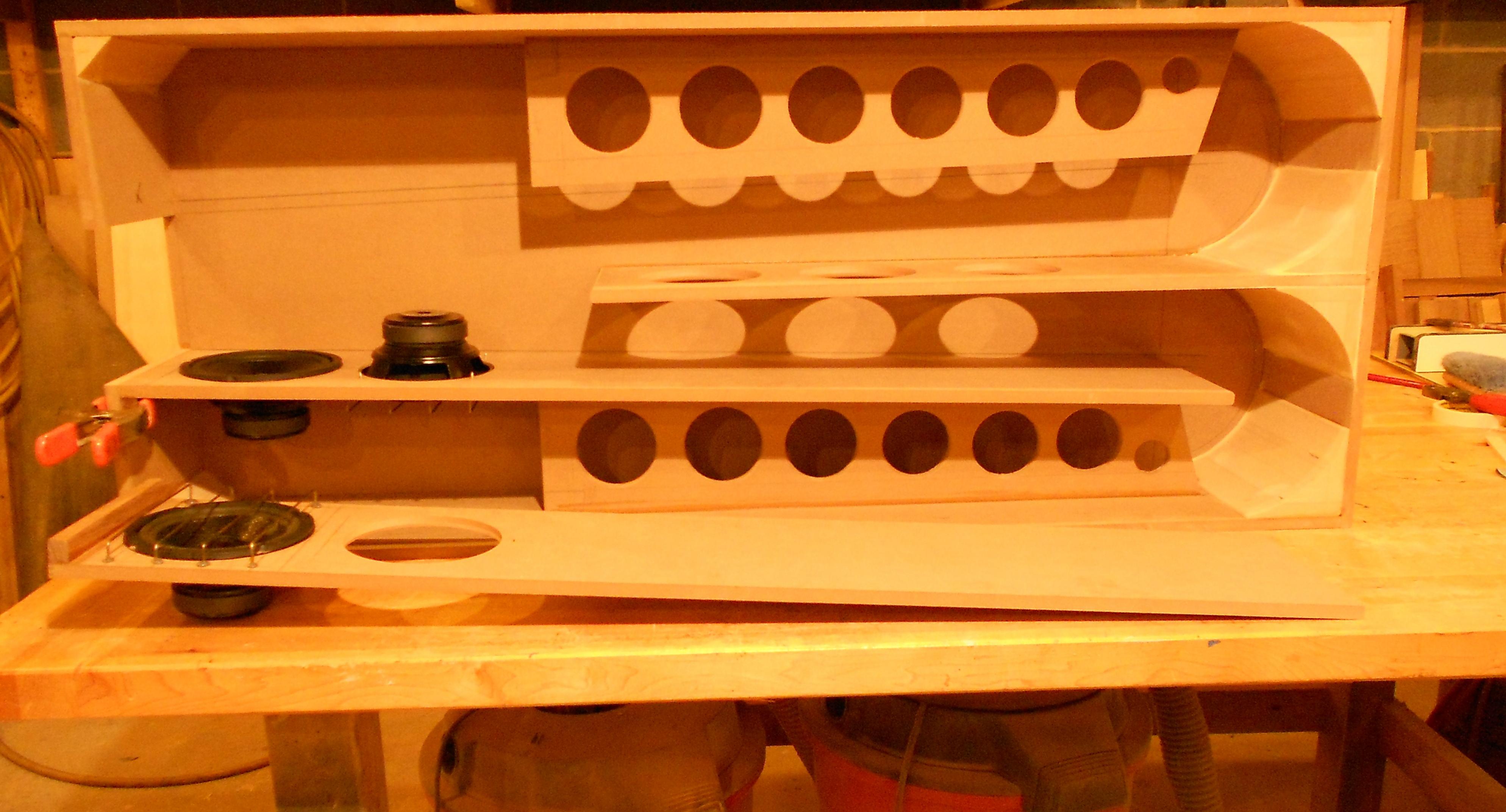

Still working on the second single fold T-TQWT (going slow). My HIFY buddy came over the other day, he couldn't believe the way they sounded 😱
(I have 4 sets/subs completed, working on the 5th)

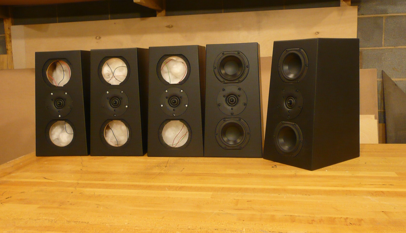

The Full Range? - they are very nice - won't knock your socks off with a transistor amp. I go with the HDS kits from Maidsound.
My buddy that came over has a lot of top/high end equipment and the HDS kits and $8 T-TWQT subs left him speechless. The HDS kits don't have much bass, but they are extremely natural sounding. They do need a couple hundred hours to break in.

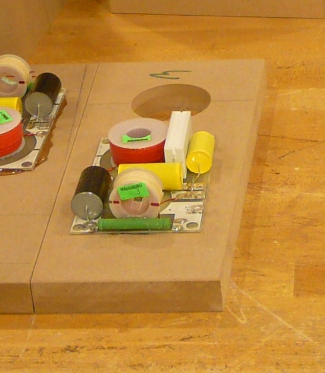

This pic is the pre-made crossover.
btw, the HDS speaker is a sealed box.
