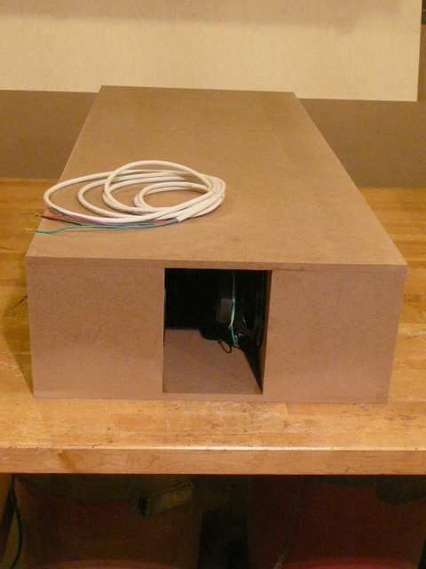

Maybe on the side would be better.
It would be fun to have a stack of these.
They have unusual sound to them (which I like); they crack like a
Bull Whip. 😱

whats the outside dimensions of that box ? it looks greatMaybe on the side would be better.
Bull Whip.

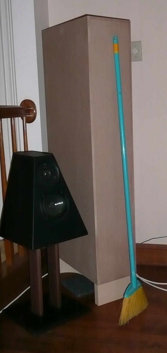

how stable is it standing up like that ?Here's the latest....upside down.
54 1/2" standing
It's not bad, no kids/dogs here though.

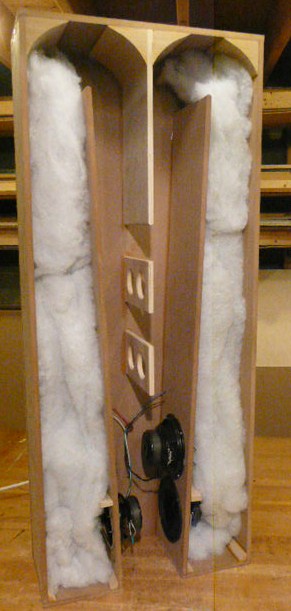

This box is working very nice, a little more detail in the low bass. Also for 1/2" wood, it sure sounds soild!

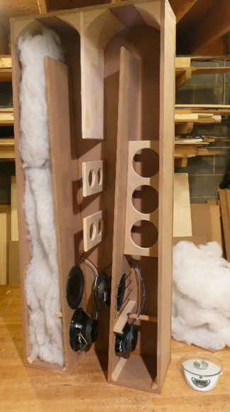

I had a chance to listen to this all weekend, it's a winner. The bass might be a bit stronger than the other 3, maybe because the mouth/woofers are tight into the corner.
Interesting though, I don't feel the box vibrating.

Hi ODougbo,
Praise your bracings ! The T-TQWT is a point pressure source, 😱 not a Vacuum Cleaner in reverse operation!
IMO, You've done a very good designs job, but do you have enough of sub's?

I'm thinking the tall build is the "best deal".....I like that there is a full 100" center line and no worries about the folds.
Agree, Most of the T-TQWT's I have built are single-folded.. What about your main speakers, how do they integrate with the sub's.

The tall thin box with the 4 - 6.5" is good build, pretty easy and costs are low.
Sheet 1/2" $25
4 woofers $32
Fill - $10
AND it makes a good stand up vacuum cleaner!

NICE wood work! I noticed that my T-TQWT doesn't vibrate either. They do have an amazing sound to them.
