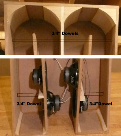

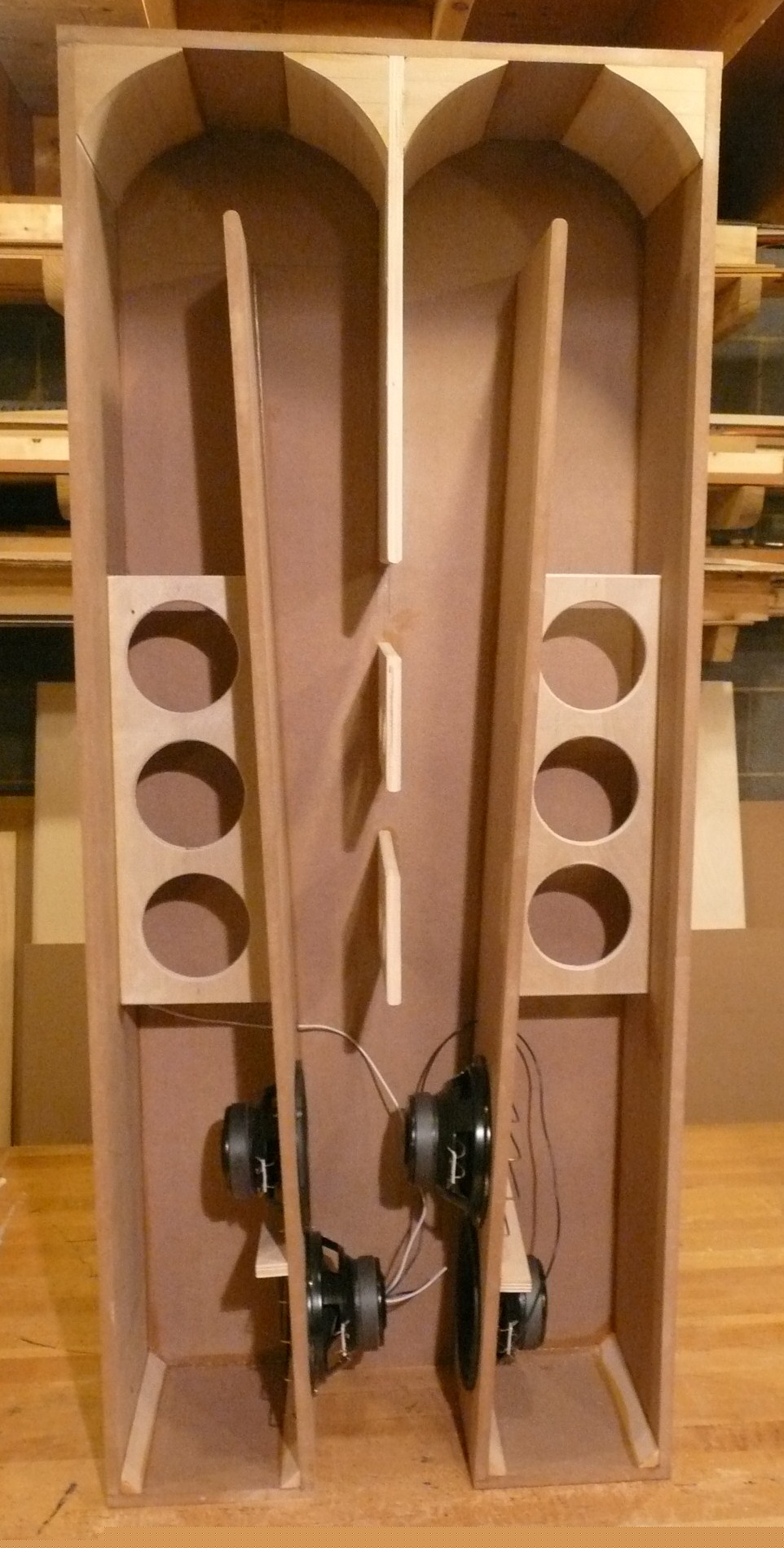

I get :hypno1: looking at it;optical illusion, but it is square.
The woofers are suppose to cancel out something...Oliver will tell us.
Curious if a straight box has an advantage over a pin-ball machine design????
Btw, It was not hard to build. On a 1 -10 scale, I'd give it a 4. About $60 into this.
They sound nice, go deeper than expected, not hard hitting, more of a "soft" bass; very easy to listen too........
