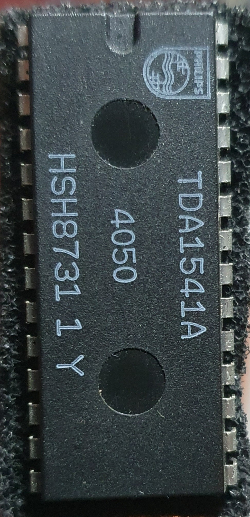

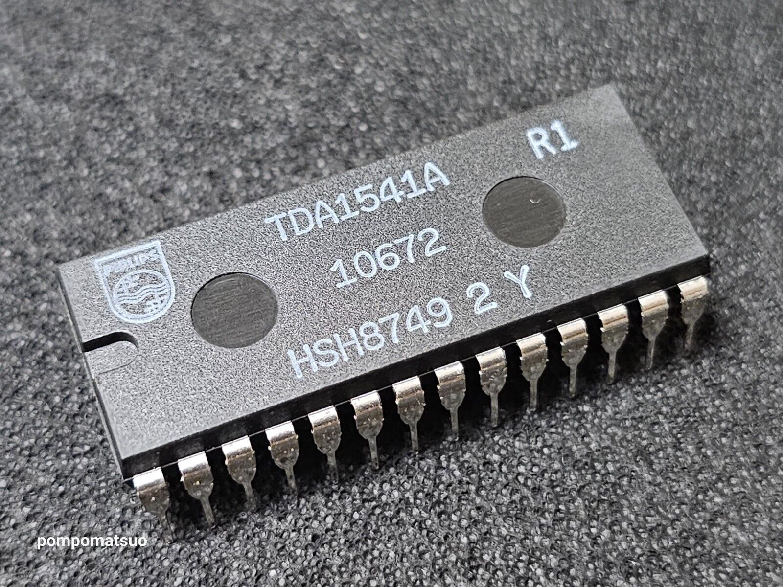

Is this a genuine TDA1541A? Others I've seen have a vertical bar to the left of the Philips logo.

Can anyone shed a light on the following picture and tell me if this could be genuine?
"NOS "New old Stock" Philips DAC Chip.
TDA1541A S2 HSH 0449 2 originally built in Holland.!
As far as i know, these chips are from the last lot of these types.
Made in 2004, on latest Philips Production Line, with advanced technology.
No after band- selection, because the quality was already on the
double crown -level when they came out of the production line.
Only to supply High End OEM-s like Marantz and other audiophile vendors,
with spare parts for there latest CD-players and D/A-s.

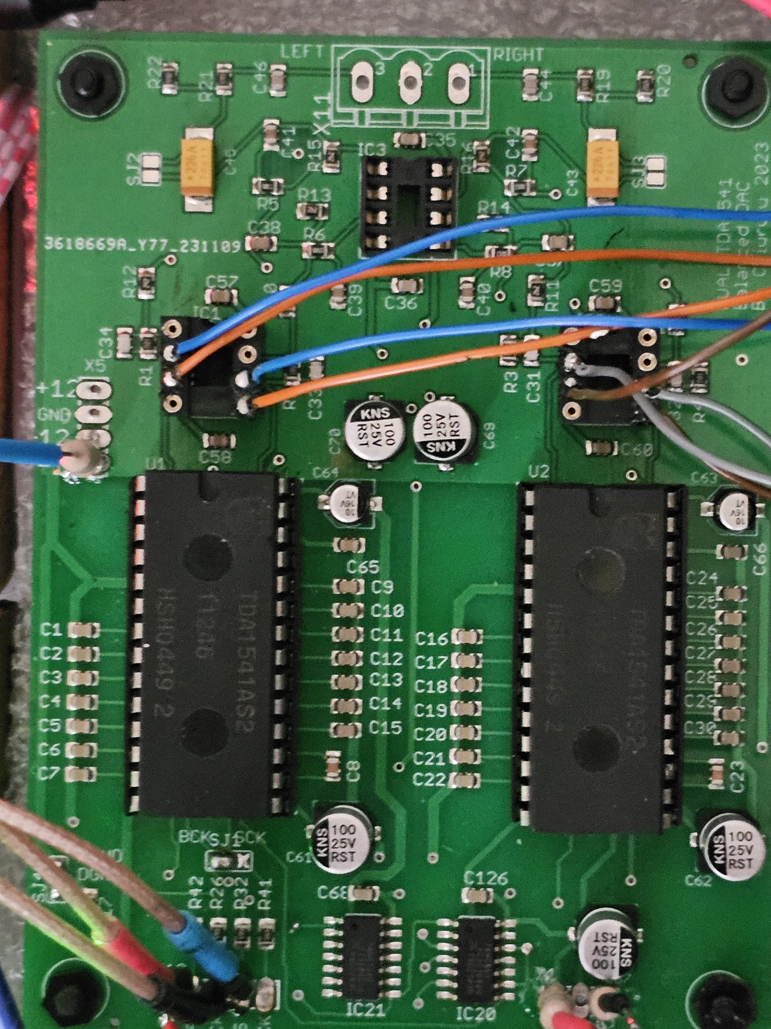

According to the seller the signature on the chip is laser engraved.
Amoung other tda1541a dac chips I also have 3 of these HSH0449 version.
I bought them many years ago at a reliable seller in the Netherlands which had them for years somewhere in stock.
They sound very good, fake or not.

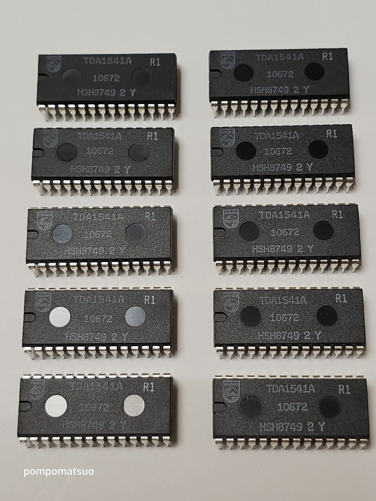

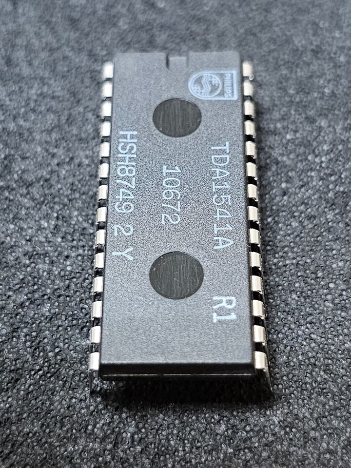

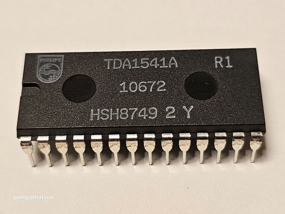

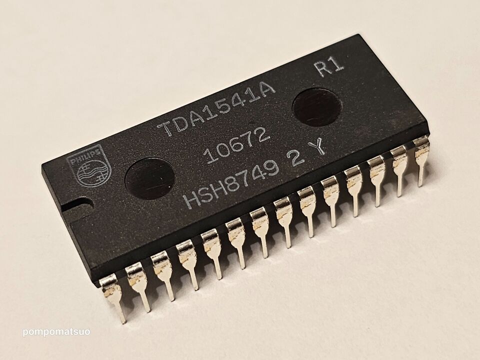

This thread should have long time ago being renamed. It is well known that there are a lot of "fake" "S1", "S2", "R1" and even non-A versions marked as "A" versions, but I do not know of any incident, where there was not a real Philips TDA1541(A) chip/die inside.
So, what remains are remarked ICs.
So, basically they're all genuine Philips, some might be original rejects, some might be lower grades marked S1 or S2, or as the myth goes that R1 was a better grade as non-marked ones.
If they work, especially in simultaneous mode, they are all "original, non-fake" Philips.
I personally can not understand people, who insist on "never used / NOS" - you're guaranteed to be fooled. And you have now benefit other than "virginity".
Fact is, no "out of factory" TDA1541(A) ever was laser marked. So member advr was fooled, those ICs are most likely remarked ordinary TDA1541As - not S1, not S2 and not R1 - but maybe even the older TDA1541 non-A.
Hi Laszlo,
then my sentence "Fact is, no "out of factory" TDA1541(A) ever was laser marked. ..." shall apply. It is very likely that most of the actual offered ICs are pulled from equipment. After the 800°C proban flame that have pulled them out of their original equipment, some of them have given up. I guess nobody in the "aftermarket" QA cares about if they are still working after applying the laser marking 😉 Thats why I don't understand people charging against members here in the forum who are admittingly selling pulled parts - tested - and buy assumingly "NOS" parts from everywhere in the internet. I even was offended in this forum when offering parts (I was assuming "pulled" was standard as of the 2020s).
Best regards, Markus
First I just was glad to get those TDA1541A s1 dacs. They were definitely not pulled from equipment. They were with normal price.
Probably they are A's as when applying the Grundig mod, sound changes.
Real S1 I never heard. No problem for me. I build my one dac /streamer and really enjoying how it sounds.
Ad.

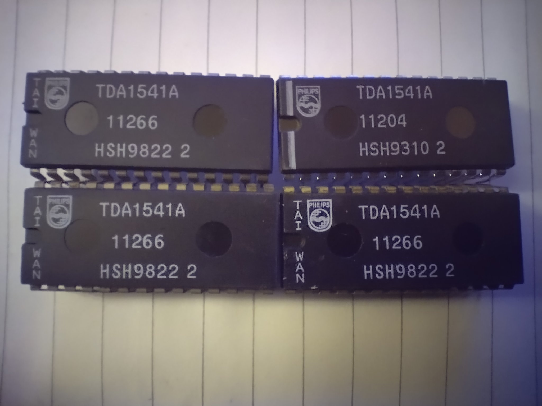

Hi guys I just bought four TDA1541A on eBay because I thought it was a good deal $62 each and plan on making a quad TDA1541A NOS DAC in the future. Are they legit?
Also @lcsaszar I am wondering if you bought it from the same seller. I bought it from a Japanese seller. You said it doesn't work or were the "laser-engraved" ones different from the picture you showed?
By the way these are not my photos these were from the ebay listing
https://www.ebay.com/itm/256175875868
Also should I have gotten the Taiwan version? I want the best sound. Where do I buy them? I'm sure I can still cancel it because the seller seemed nice enough.
