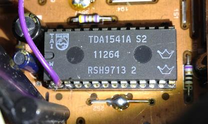

That one is in an old Magnavox CDP, stock OEM, I assume???? So, I posed the question. If you don't want to discuss, ignore the post and don't comment!Why still discussing issue of fake 1541A?

from the print i would say it is fake, but since it sits in the cd player, is it functional?That one is in an old Magnavox CDP, stock OEM, I assume???? So, I posed the question. If you don't want to discuss, ignore the post and don't comment!
I can think of better names for youThanks. Call me eye opener.
In old CD players they didnt use this kind of DIP socket. They use different one IF they are used the socket for the DAC chip at all.
So my tip is that the socket added or changed to that PCB. That is not implicate that the DAC chip is fake.

I bought that Magnavox CDB-473 from eBay (2007/2008??). I also ebay purchased some others Philips CDPs and DAC chips at roughly the same time. I may have added that DIP and replaced the orig 1541 with a 1541A.In old CD players they didnt use this kind of DIP socket. They use different one IF they are used the socket for the DAC chip at all.

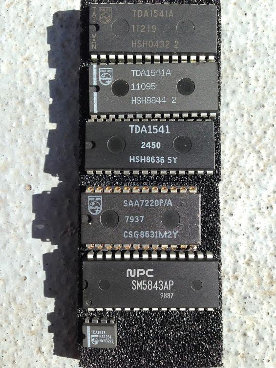

I also ordered this around the same time:
Some thoughts about the fake chips ... I doubt any of them are true fakes. I'm not aware of foundries churning out duped chips on a mass scale. It is very $$ to cast and manuf any ASIC.
Some chips may have been orig (TDA1541) that were sanded and re-labelled. But that's also quite a labor-intensive process. Not sure how much of a market there is for TDA1541As, other than diy projects and some Chinese ebay/Ali kits. Almost no commercial manuf is has been using 1541A since the early 2000. Correct me if I'm wrong.
Also, take a look at this image from my parts bin. Note 1541 chip with no "Philips" brand label.
Theis was de-soldered from a Magnavox player sold in the US. I run into weird no-manuf-label chips like this a lot in Magnavox CDPs. Like the SAA decoder chip which has a strange Motorola code.
