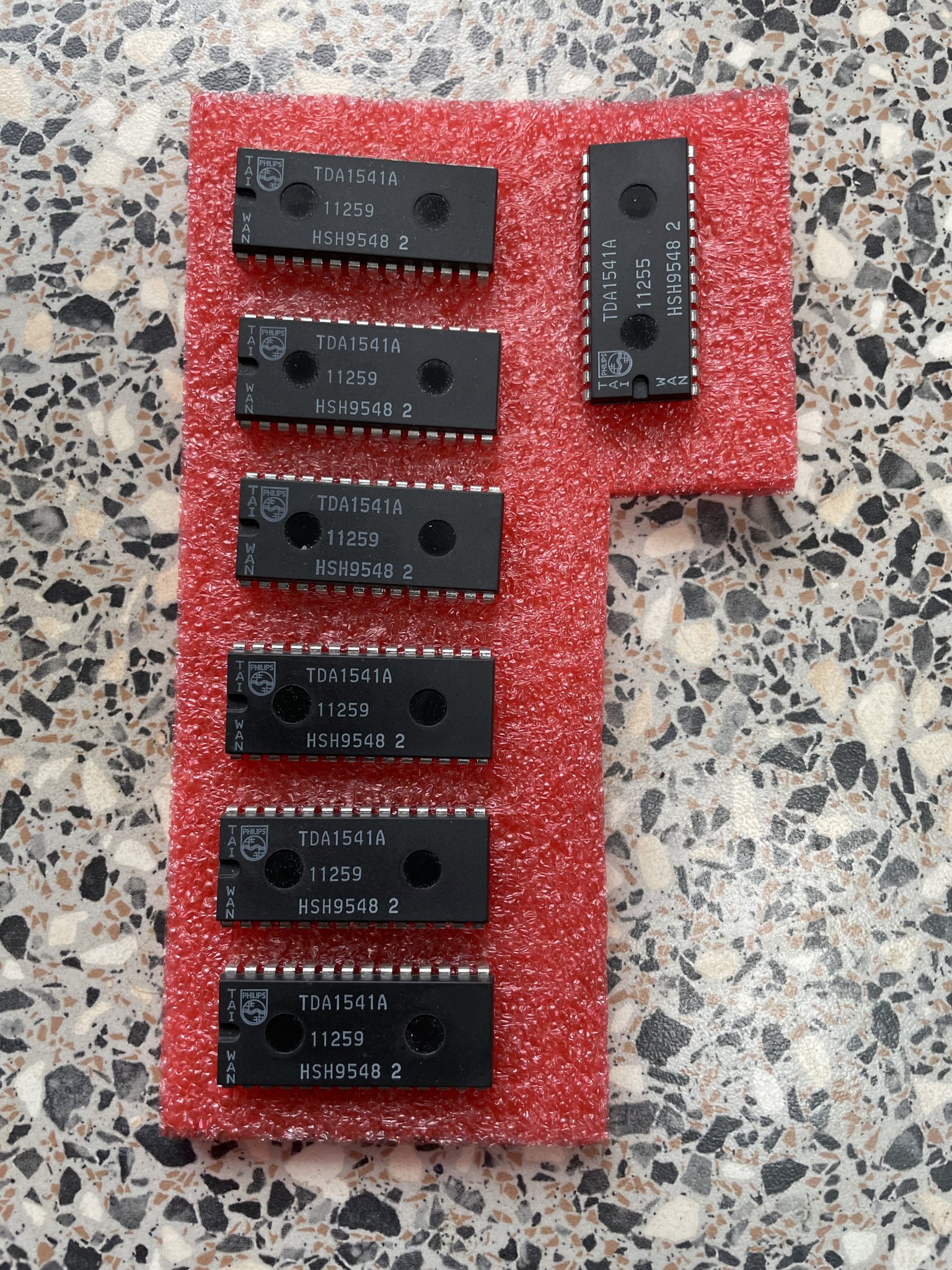

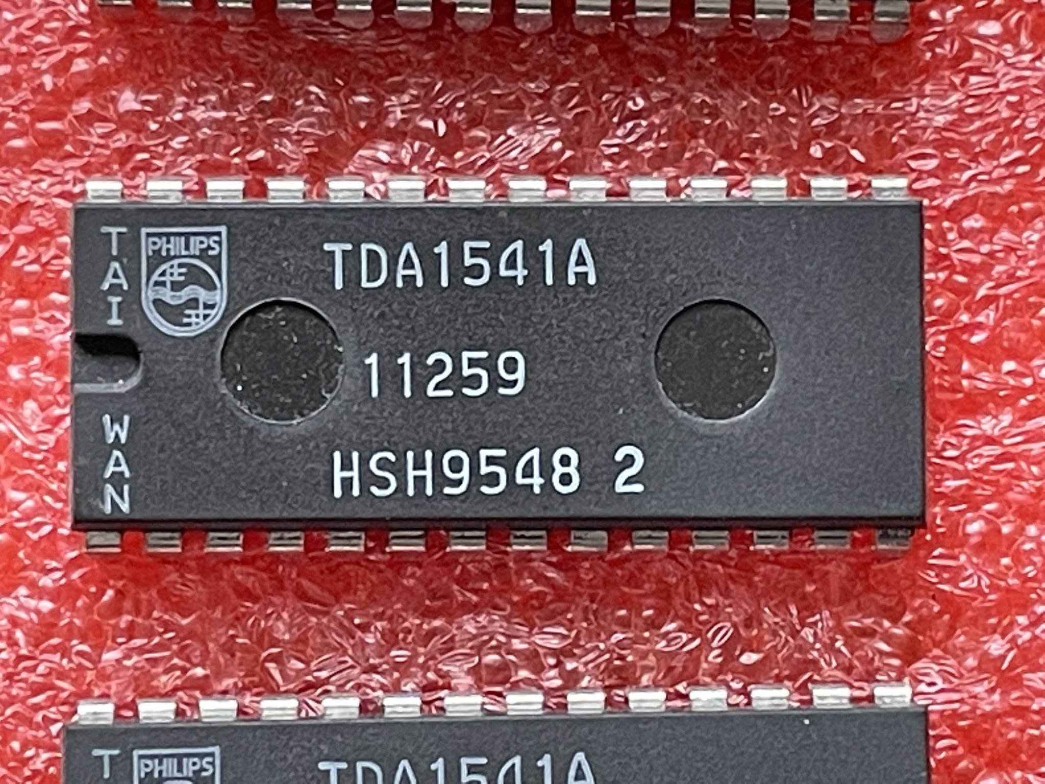

Is this a real TDA1541A?
Why would you transfer money to Chinese scammers?
This IC batch 11335_HSH9628 was never used in a commercial product as far as I know. It was supposedly used in an upgrade by Candeias in a Marantz CDA94. One only has to look at the price for this item on eBay to conclude it is 'remarked'. If it were a genuine IC it would cost at least a few pennies more!
If I were to buy a TDA1541a with Taiwan marking, eBay and Aliexpress are not the markets where you will find a lot of genuine TDA1541s. Most of the time the TDAs are salvaged from broken CD players. The scammers then add stamps to make them look like an S1 or S2.
Look at the Philips Logo stamp because this is the hardest to reproduce for the scammers. Because it is small, it is very hard (almost impossible) to fake this stamp. You can simply compare it to a real one, soldered in place! Always ask the seller for a clear image of the TDA!

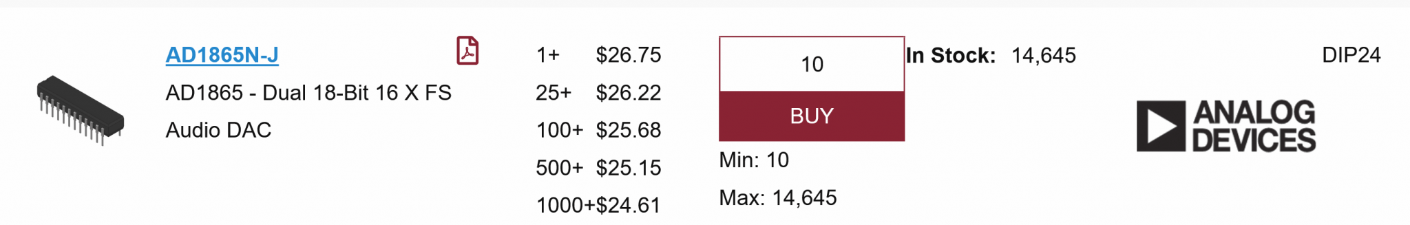

Maybe its time to switch over to an AN1865 DAC with Rochester sourced chips? Still 14,645 of the N-J left :)

Have look at this sample TDA1541A and please comment on "fakeness" issue.
In old CD players they didnt use this kind of DIP socket. They use different one IF they are used the socket for the DAC chip at all.
So my tip is that the socket added or changed to that PCB. That is not implicate that the DAC chip is fake.

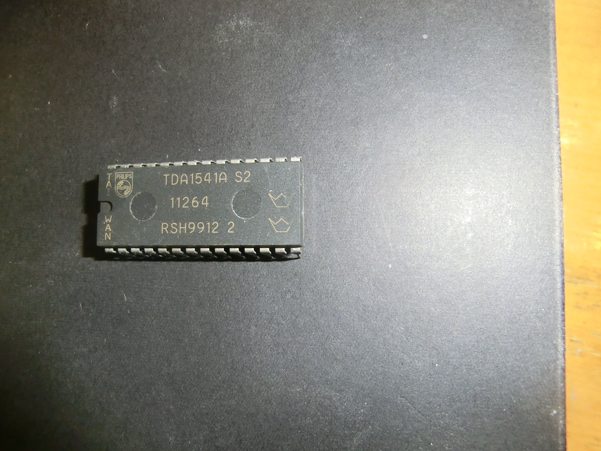

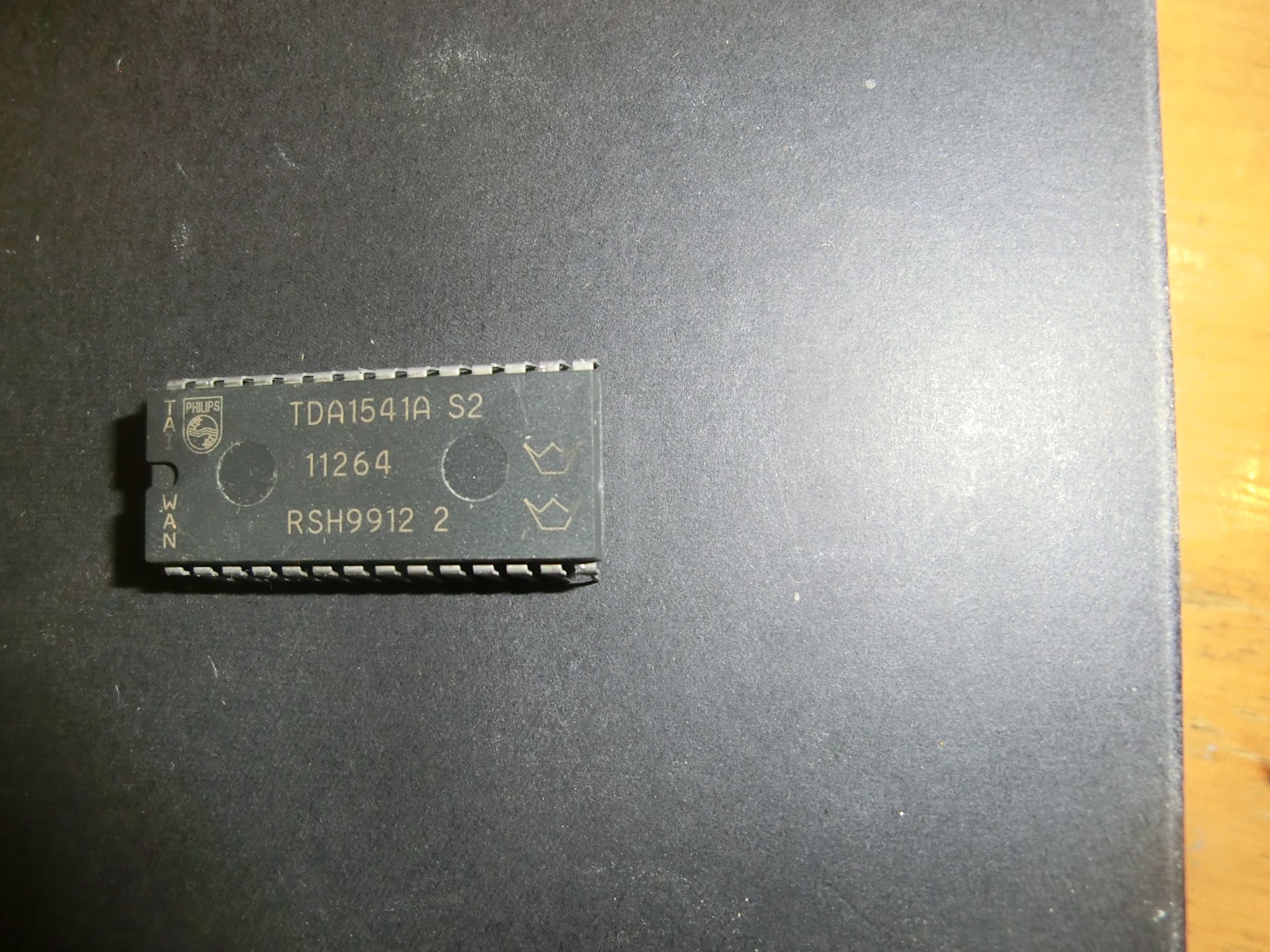

Any thoughts on whether these are genuine? They were part of a job lot of parts acquired from a Audio/Video repair shop that closed down app 10 years ago, so I have no reason to doubt that they are not, but wanted to check?
Note: The close-up pic is taken with an iphone camera in HDR-mode, so the text looks a brighter white than IRL.

I bought that Magnavox CDB-473 from eBay (2007/2008??). I also ebay purchased some others Philips CDPs and DAC chips at roughly the same time. I may have added that DIP and replaced the orig 1541 with a 1541A.
I also ordered this around the same time:
Some thoughts about the fake chips ... I doubt any of them are true fakes. I'm not aware of foundries churning out duped chips on a mass scale. It is very $$ to cast and manuf any ASIC.
Some chips may have been orig (TDA1541) that were sanded and re-labelled. But that's also quite a labor-intensive process. Not sure how much of a market there is for TDA1541As, other than diy projects and some Chinese ebay/Ali kits. Almost no commercial manuf is has been using 1541A since the early 2000. Correct me if I'm wrong.
