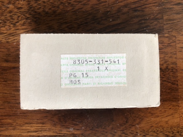

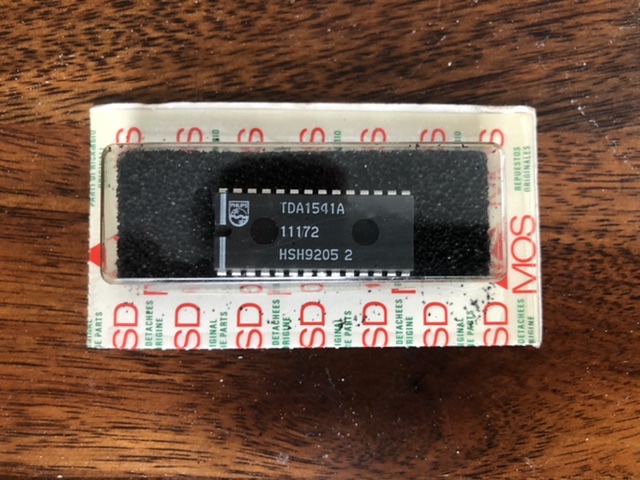

I thought I’d ask here before investing any more money.
I find myself in need of a replacement digital source as my beloved Rotel RCD 855 stoped working a few years back.
I tried sourcing another used 855 to replace it and found one on eBay, but it also appears to have some issues.
I was very happy with the sound of these tda1541a based players, but I think I need something more reliable.
My goal is to build a Shigaclone transport (I have the parts) and I’m interested in ryanj’s D3 circuit to implement the 1541A.
I could try to harvest a chip from one of the 855s, but wasn’t sure if I’d fry it in the process.
I came across a listing for a NOS 1541A in the swap meet. It cost me $45 shipped. It is in what looks like some sort of original blister packaging. The seller was from Italy. I believe he said he sourced from a local electronics supply a while back but never used it.
I’ve attached some pics.
Looking for as much confirmation as is possible that it is real before spending money ordering a D3 and etc to use it.

The print looks ok.
