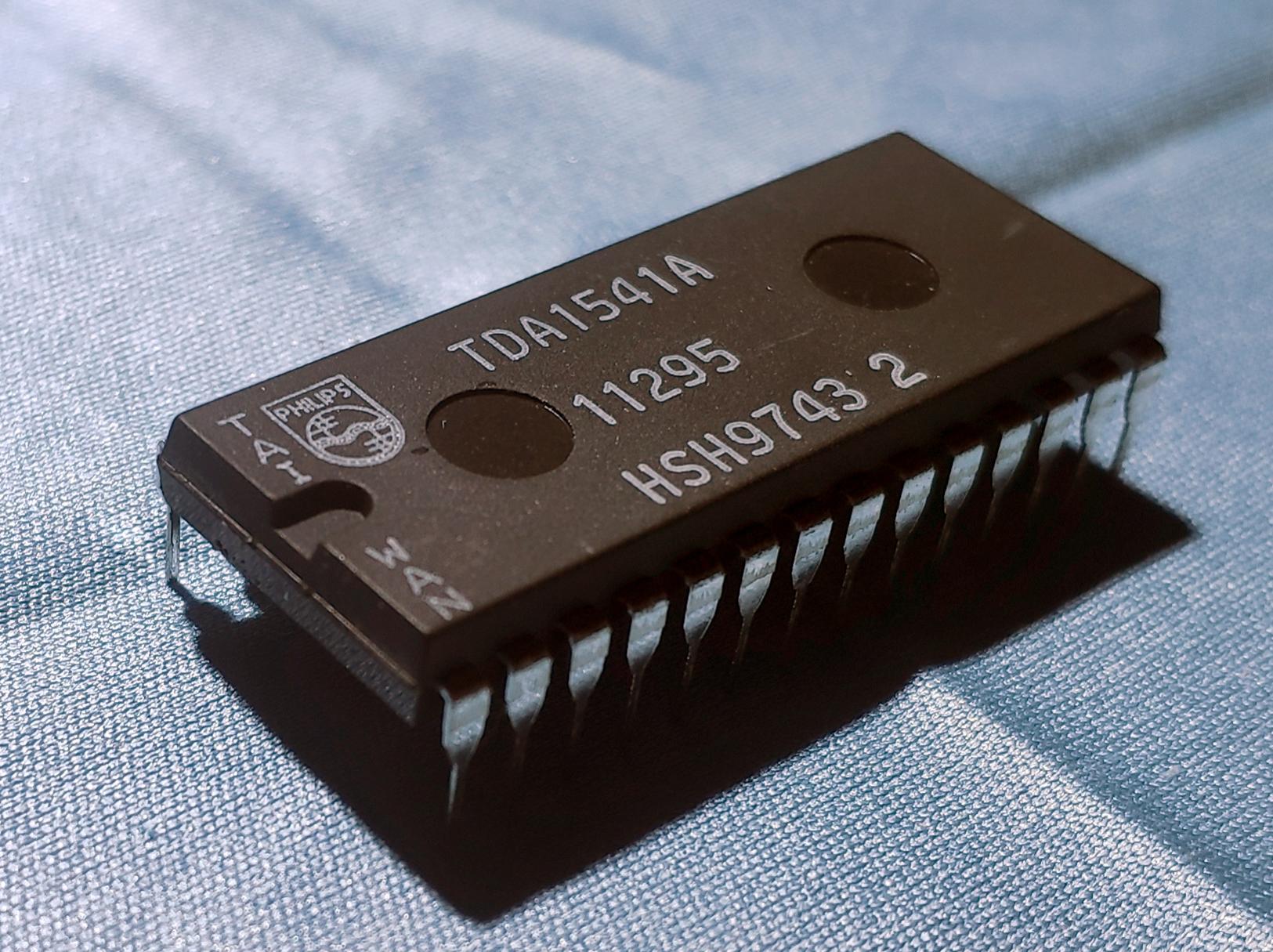

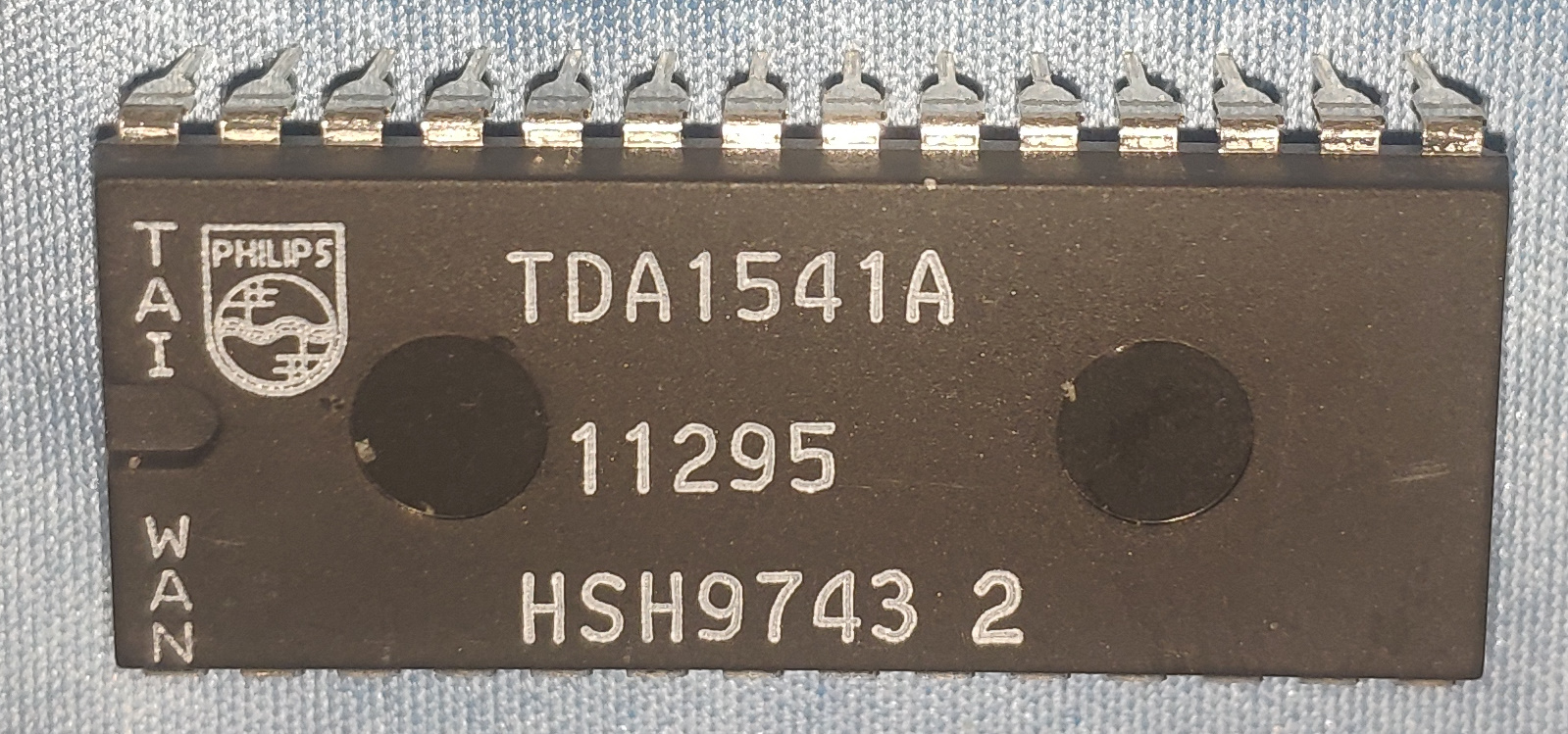

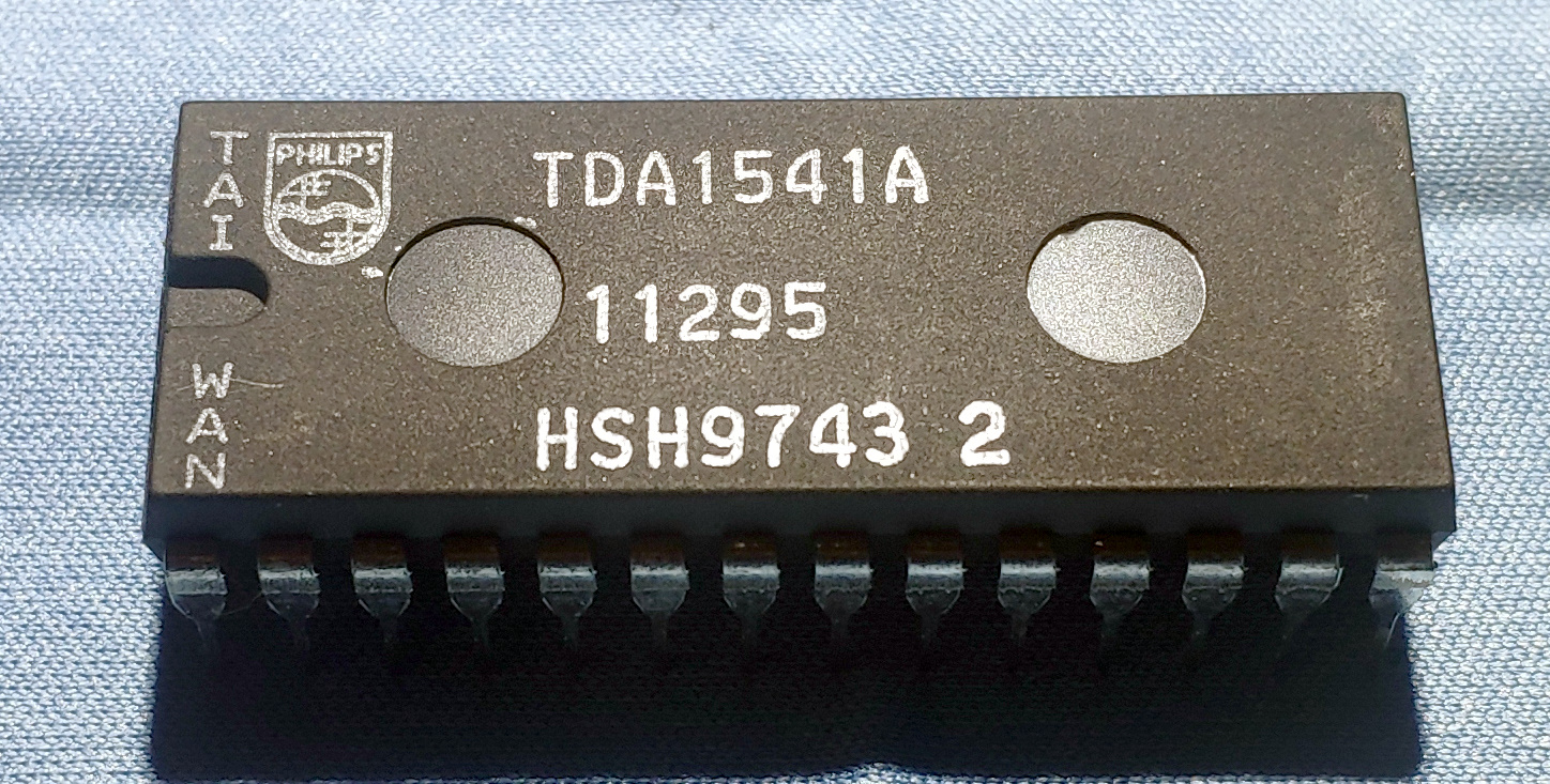

I was curious and thought for €30 I give it a try: from AliX
What did I get? Obviously a real TDA1541, as it is working without any problems in simultaneous mode. I do not know any other chip that could do this.
I have some doubts about the datecode, because I think that all chips from '97 should have the "RSH" code.
What I can say is that it is definitely not black-topped.
If it was re-marked, they did a really good job.

Thanks Jon, good to know.
I'll try to hook up my PCM4222EVM next weekend to perform some measurements. Just listening to it with a HSH8844 on the other channel reveals no difference.

Still, I have doubts regarding the datecode and place of origin - If it is, like my sample, marked with "HSH" it shouldn't be marked with "TAIWAN" as the source of the silicon then must be the Netherlands.
Chips (dice) from Nijmegen that were assembled in "xSx" - Kaohsiung - before weren't marked with "TAIWAN". I thought that only TSMC sourced dice would have been marked with "TAIWAN" on the top of the IC => "Rxx" / "RSH"

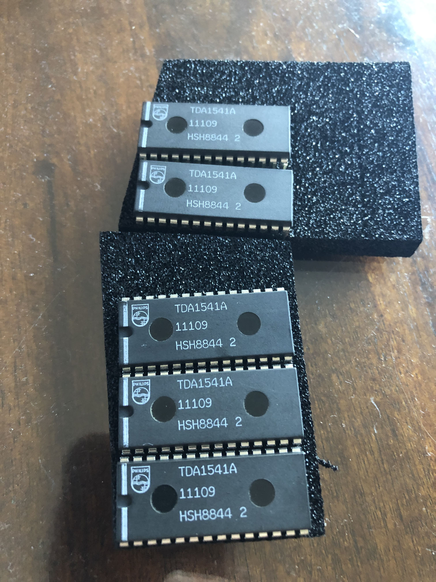

Edit: Anyway, with pleasure I would send original chips also to Serbia (@jorgovanko). I still have all the TDAs except the ones marked "HSH 8844 2" as you can see from one of my previous posts over to sell. €40 per piece. Let me know.
That chip is probably a real Taiwanese chip totally reprinted with a disappointing mash up of aspects of early Dutch markings and later stylistics. This is a nice example of imaginative forgery. Id give it a high distinction for creativity but fail it on poor research and clumsy printing.
Yes, as you purchased it from me.
And it is one of the last remaining 15 pieces, I could buy from the NOS stock of Studer Professional Audio, where I am working.
I have still some offers running in a big auction site...
Probably the other chip on your pictures is a fake? 0815? And no S1?
