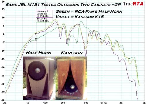

The Karlson was a wonderful example because it is a Litmus test differentiating between those that understand the basics of acoustics and cabinet design and....
It was claimed to do everything and have the best aspects of horns as well as bass reflex. Recently some have tried to explain it as a double tuned system with a back cavity and front cavity (the baffle area under the exponential slot). I think the front volume is too wide open to work as a second cavity and think the cabinet basically works as a bass reflex cavity with an extra resonance(s) chamber.
There are plenty of measurements on the web. I'll attach three. One is from a Jullian Hirsch review. You can tell from his tone that he wasn't impressed by the many claims made about the speaker. (It was nothing if not well marketed.) Note that all three curves show the same basic profile: two deep dips close together and then a third major dip further up the spectrum. These are the resonances of the chamber between the inner baffle and the front exponential surfaces. The Klipsch curve (I think taken by Paul himself) shows the same basic profile. The extra hash on the curve appears to me an in-room measurement. The third set compares it to another reflex cabinet. It shows the same resonances. The LF response looks like the typical differences between different cabinet volumes and tunings.
A cabinet with a series of holes is a reflex cabinet. The holes aren't ideal vents because port resistance will be high and port output will be nonlinear, but it is still a reflex cabinet. An exponentiall shaped slot is not an exponential horn, it doesn't determine area growth. It is decoration. Having an undamped cavity beneath will clearly lead to resonances, as all the curves show. Cut off the front wings and sides forward of the baffle and you will have a decent reflex cabinet.
The BBC monitor with the slot loading of the woofer is nicely done. The volume under the wings is small and the impact on frequency response is minimal. It acts like the diffraction slot on a lot of CD horns, reducing effectiive width and improving dispersion.

Enclosures like the Karlson have their own character and are a whole lot of fun to play around with different drivers. I would love to try an RJ sometime.
The Karlson might not do everything as it was advertised, nor would I ever expect it to, but it does work as a "coupler" IMHO. The fact that cone motion stay quite low for high SPL's makes for a very clean sound. I EQ'ed some peaks and dips on mine, but not 100% as not to lose all of the character.

"there are plenty of measurements on the web"
By this statement Dave S implies that he has never heard one. I suspect that by the same reasoning that he reckons that SET are absolutely the pits too.
I suspect he never listens to music and only listens to the system. Such are the ways of those who are afflicted with measuritis.
There are plenty of systems that look "fabulous" on paper yet sound horrible in real life but hey they cannot be horrible because the measurements tell me something else.
A sine test does not tell anything about intermodulation, transient response, dynamics. Neither does a simple impedance test. A sound system is a synergy of the different components.
Same thing that the scientists reckon that the bumblebee cannot fly either.
If you are a true scientist then I would think that you would first verify the test results for yourself before relying on hearsay and someone else's interpretation.
Since you have never ever build one or tested one we can safely ignore your "hearsay knowledge".
