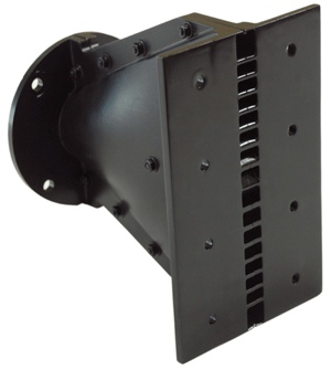

These are becoming popular with pro sound line arrays. A multipath waveguide couples one driver to a line exit with equal length paths.
Equal areas but different exit shapes. The goal is to prevent extra delay time to the ends vs. the middle.

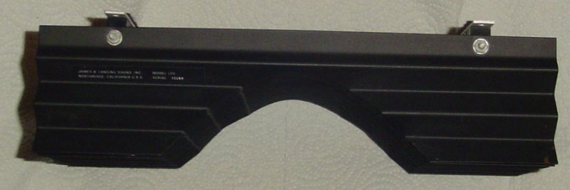

JBL used the term "Waveguide" going back to the LSR Series from the middle 90's. They then went on to the PT Waveguides in the AE Series. They still make Bi-Radial Horns and make a point of differentiating between them and waveguides and use them in their TOTL Commercial speakers. They being the Everest 2, the K2 Series 9900, 9800 and the Array Series.
All the PT's are used in commercial JBL Pro SR boxes but having used them they can sound just fine at home.
Hello David

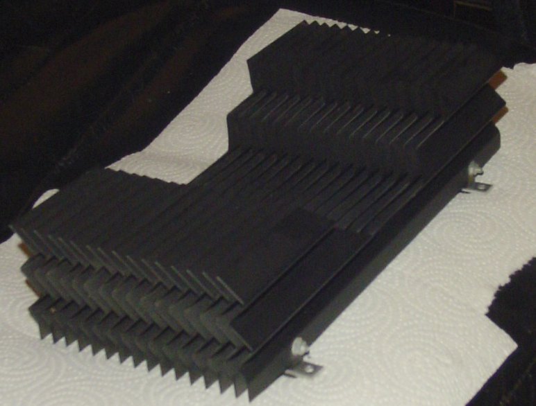

My personal favorite are the serpentines. The look great and seem to work OK as well. I will link the paper on them from the Lansing Heritage site for anyone interested. Here's a picture of the smallest serpentine to get a better fell for how they work. I use them on my 4344's.
ACOUSTICAL LENS
