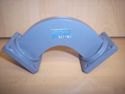

Hi Earl,
In the context of the current discussion, by radiation I mean the unguided propagation of energy. A waveguide by definition "guides" energy from one point to another.

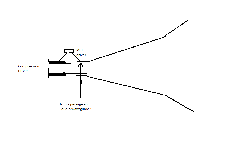

Not sure how well the waveguide below would perform as a horn loudspeaker... .

I simply do not understand the first sentence (waveguides don't radiate sound?).
"All waveguides are horns"
Kind regards,
David
Kind regards,
David
As an Acoustic Waveguide, it would not work very well.
To confuse the issue, is the passage from the comp. driver to horn a waveguide and is the arrowed passage a waveguide? This type of horn has a patent.
jamikl
This type of design does not work very well, I've tried it. The junction of the HF and LF devices is basically a large point of diffraction and reflection.

- is this a horn or a waveguide?
