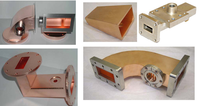

Wasn't Karlson, creator of the wonderful enclosure called the "Karlson," an expert on radar waveguides and designed his box accordingly? Of course, I am not sure if it really is a waveguide or a horn.
Where the term really came from.
RF waveguides.
David S.
"Waveguide" was probably coined for RF waveguides.. still, the name itself is self explanatory and is NOT a term of art (..it has broad meaning in a number of fields).
