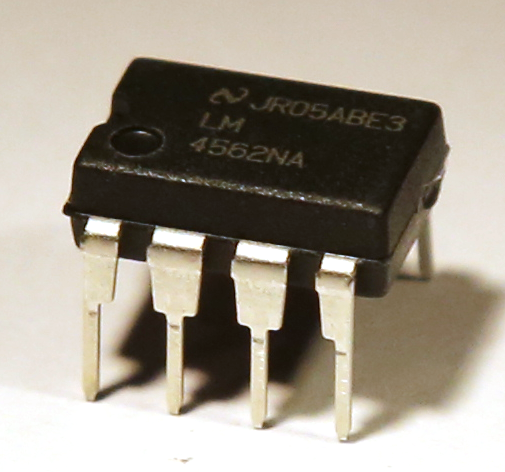

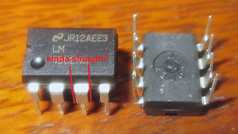

Is this a fake LM4562NA?
Please take a look to the attachment.
I got this for about 2.5 US$/pcs from local supplier.
The strange thing is, if LM4562 has 10mA Quiescent current, why my NE5532(Iq=4.5mA) is more hot(warmer) than LM4562?
Is it new TI batch marking now have 8 digit? JR12AEE3 ??
Is the leg seems genuine?
The other strange thing if it fake is, why it sound more detail than my NE5532..
I'm sooo confused! :scratch1:

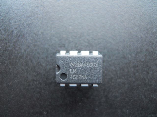

It looks dubious to me. The lettering isn't perfect for one thing, some appear to be at an angle and some out of line. The 5532 has a higher Iq than 4.5ma. 10 to 12 ma would be typical for the total combined current of the two amps in one package. A 4562 and 5532 probably run at around the same temperature from what I remember of them.
Hi Mooly,
you see the right IC have a words on it: K O R E A 12 (and X in the midle)
the left IC have : K O R E A 13 (and X in the midle)
why are there have different bottom body mark/stamp for the same batch JR12AEE3 ?
but, I don't quite care anymore, they sound pretty good!
my ears don't eat number, they eat good music.. 😛
regards!

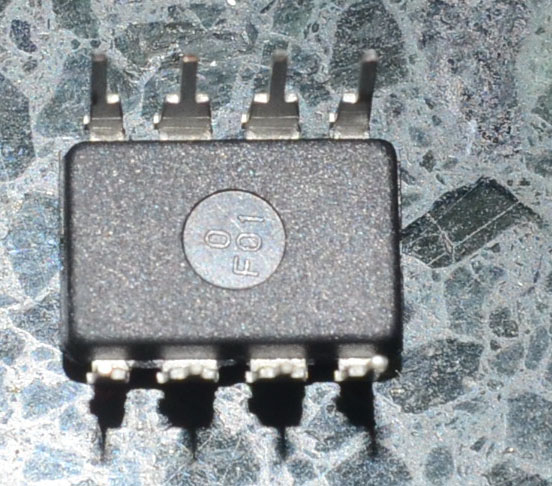

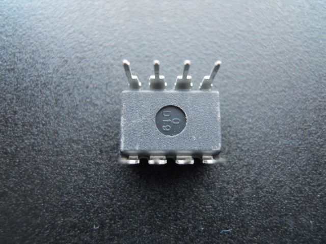

I got curious and so took some close ups of the 4562's I have and tbh the same things I criticise in yours are apparent in mine too.
They are physically a little different but in fairness having seen mine I wouldn't like to say.

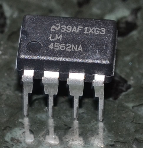

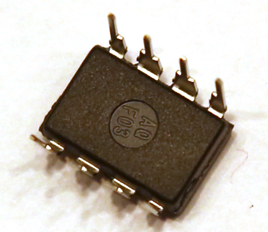

This is the ones I bought in Digikey, hopefully it's real!!! I bought it like 4 months ago.
Guys, you have better eyes than me. The only difference is the Korea at the back.

Look just like mine, and for what it's worth, I've been doing business with Digi-Key ever since their start-up, have spent literally thousands of dollars there and I've never had a problem.

Yes 4 uA is leakage current, 400 uA is certainly not a low noise part.
Maybe they are TL062's at around 400uA. The thing is though, they could be anything, they could be sub standard versions of what they originally were, you just don't know.
Chalk it up to experience and bin them would be my advice.

If they sound good keep them, would be my advice. Just use them at a higher impedance and voltage level than a real one.
Ya I will keep them just in case. 😉

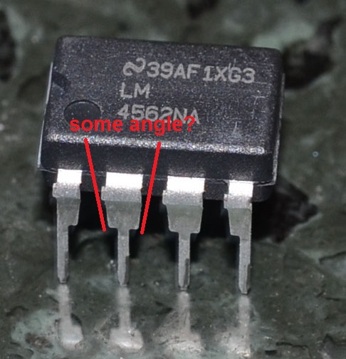

This is what I see physically, the leg...
* price don't lies
