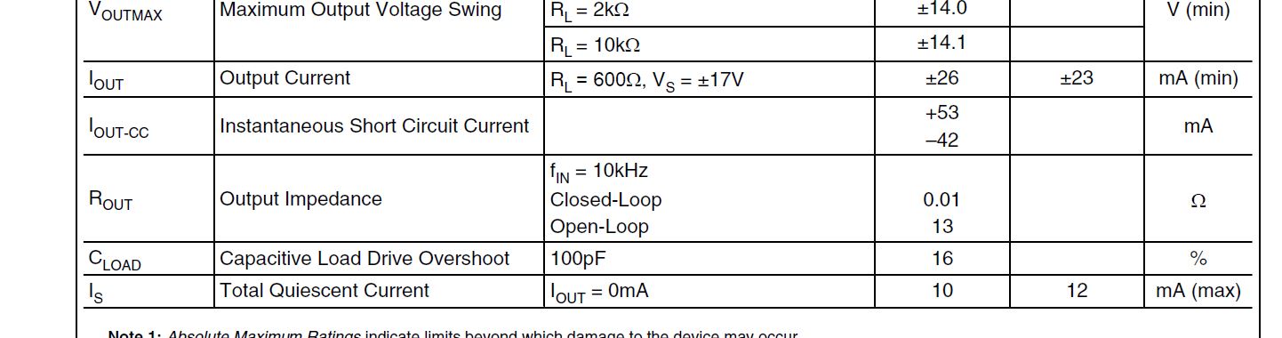

The data sheet doesn't give a min Iq unfortunately.

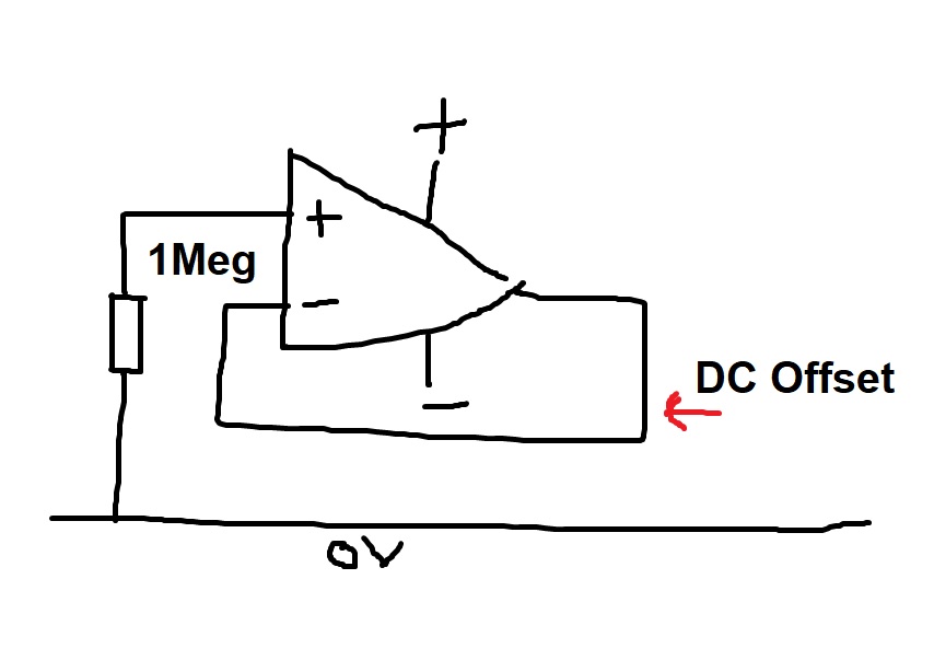

Input bias current is very much lower for the 4562 and so you could try add a 1meg resistor between ground and the + input and then comparing the DC offset for your 4562 vs the 5532.

DC offset is the DC voltage appearing at the output of the amplifier. Configure it like this and compare the opamps.

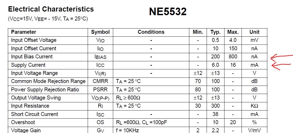

The 5532 has an input bias current of around 200na typically. That will develop 200 millivolts at the +input (with the 1 Meg resistor as shown) and that will get amplified by the chip which is configured for a gain of 1.

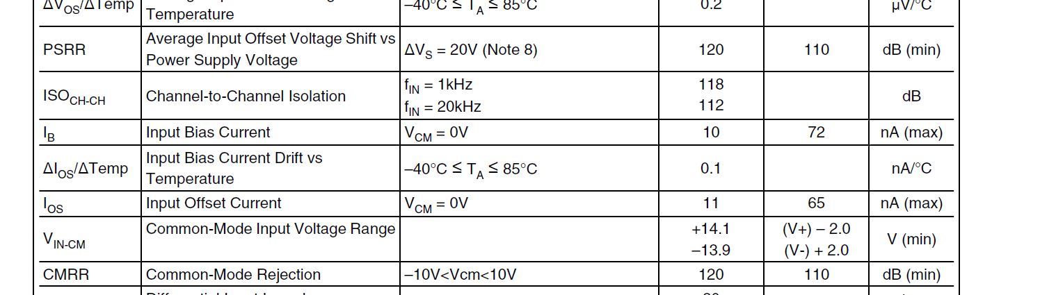

The 4562 has a typical input bias current of 10na which would develop just 10 millivolts.

Well, if you have the measurement capability, a LM4562 specs much better than a NE5532 in terms of slew rate (20v/µsec vs. 9), THD (-130 db vs. -94), and CMRR (-120 db vs. 100). Whether or not any of that is actually audible is debatable.

As per the diagram, attached 1 Meg resistor at +input, then measure the voltage across the 1 Meg resistor; NE5532 shows 1.3 millivolts, LM4562 shows 112 millivolts.

Maybe you have... or... perhaps they are both fake. Try measuring at the opamp output rather than the input.
"Measuring Opamp output", with reference to your diagram
- measure "DC offset" - Red Arrow marker against 0v?
Measure between the 0V line and the opamp output.
I drew that circuit based on how you said you had them wired in post #39 with output connected to - input. Its the classic buffer configuration.

For the 5532 an offset of -200mv to -800mv would have been within range. -450mv looked pretty much middle ground tbh. Iq looked pretty much correct to.
The 4562 looked reasonable too. Are you looking at Iq on that one ?

I guess I was looking at the "typical" without noting the "max" on bias current. The 4562's quiescent current is a bit high, though. Eh?
