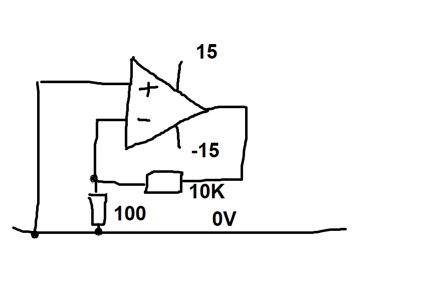

Hence I might suggest to put the opamp at high gain, 100 is enough, short the input and look at offset voltage as an alternative for your approach (Vos is amplified by gain).
Being an amateur here - need some help if anyone can:
- Draw a diagram to illustrate how to set up this test
- Where to probe to test
- What are measurements for real/fake NE5532, LM4562?
Thanks!
I think vacuphile means like this.
Iq should be within spec (similar to the values I measured) and the offset should be no higher than around 70 millivolts for the LM4562. The 5532 should be no higher than around 400mv. The offset is measured at the opamp output. Again, the offsets should be similar to my measurements I posted earlier.

Just to include here your earlier post for easy following:I think vacuphile means like this.
NE5532: Iq = 7.50ma. Voffset = -450 mv
LM4562: Iq = 14.2ma. Voffset = + 27mv
My earlier post & now the DC offset measure for high gain 100:
Supply +- 15v (using voltage divider from 31.0v)
NE5532: (2 Op-amp in package)
Quiescent Current ~ 8 ma. (this is as per Iq in datasheet)
DC offset measured at Output ~ -10 & 20 millivolts (10K resistor between Output to -input, 100 resistor -input to 0v)
1st batch of LM4562: (2 Op-amp in package)
DC offset measured at Output ~ -4 & 28 millivolts (10K resistor between Output to -input, 100 resistor -input to 0v)
2nd batch of LM4562: (2 Op-amp in package)
Quiescent Current ~ 4 ma
DC offset measured at Output ~ 0.4 & 0.54 volts (10K resistor between Output to -input, 100 resistor -input to 0v)

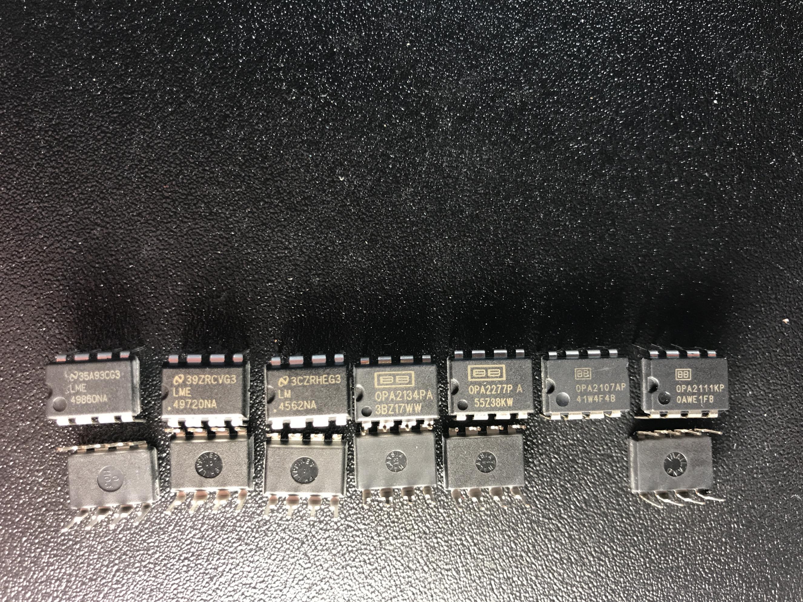

I am going crazy from those chips:
1st Batch LM4562 (4 chip samples):
-1.097v~160mv
(test circuit with Op-amp=17.1ma , test circuit without Op-amp=9.2 => Op-amp=8ma)
2nd Batch LM4562 (4 chip samples):
120mv~700mv
(test circuit with Op-amp=13.1ma , test circuit without Op-amp=9.2 => Op-amp=4ma)
Maybe they are "Incredible Hulks" Op-amp

I don't understand the with and without opamp bit. I'm assuming you mean your resistive divider is drawing the constant 9ma ?
The wide range of offsets you quote for each batch is further 'proof' they are suspect. They should all fall within a narrow range.
Buy some samples from an authorised distributer and retest using those as a guide 🙂
That different result was just came from using different method!Just to include here your earlier post for easy following:
My earlier post & now the DC offset measure for high gain 100:Code:NE5532: Iq = 7.50ma. Voffset = -450 mv LM4562: Iq = 14.2ma. Voffset = + 27mv
Code:The 5532 has to good an offset to be a 5532.
Your NE5532 is OK I assume. LTspice help me address this 😀.
It just that Molly's method will give higher output DC offset.
