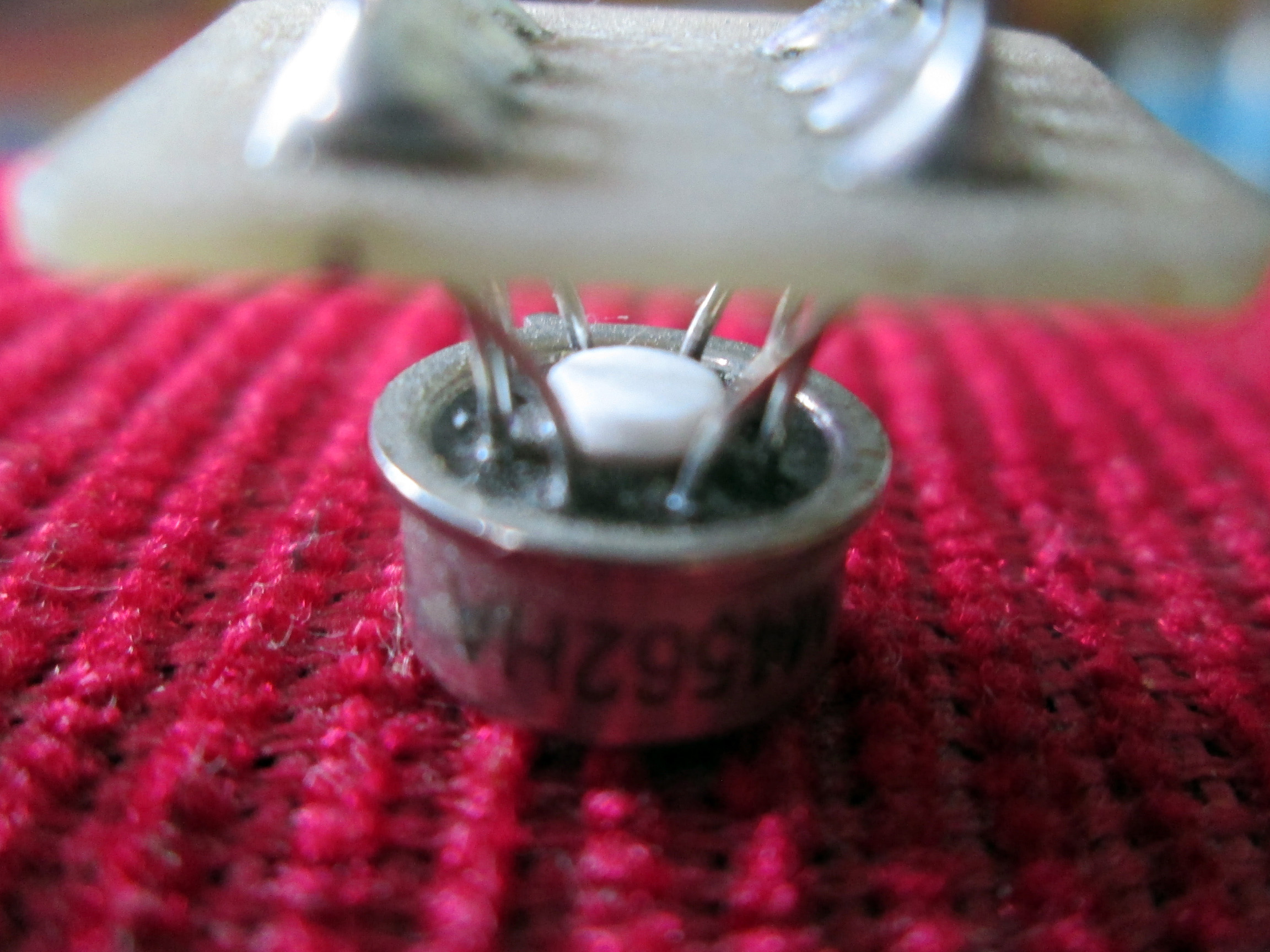

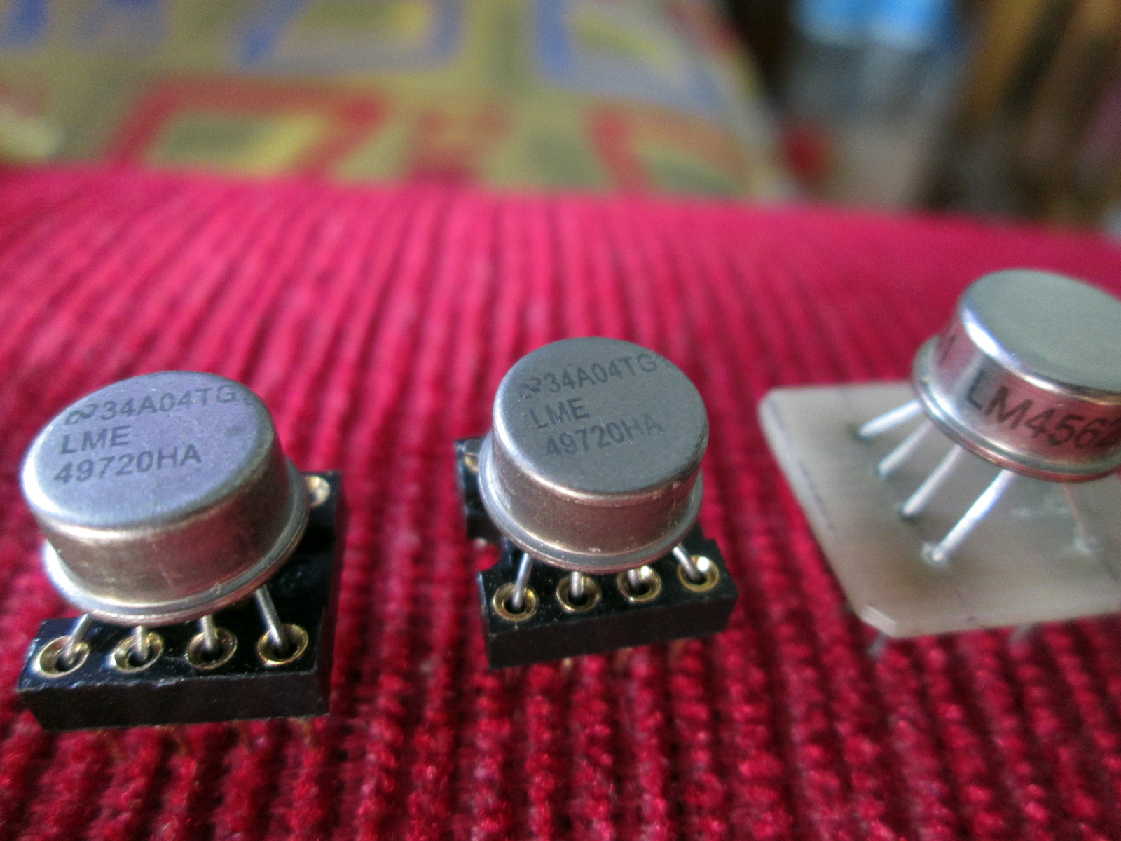

Just checked my cheap LME49720HA (about US$7.7 I guess), and compared to my LM4562HA (maybe about US$13).
LME49720HA buy from china, LM4562HA from digikey.
You know what? The LME49720HA looks like an OLD Can OpAmp.. the body and the leg wasn't as clean as the LM4562HA. The marking not as bold as the LM4562HA.
LME49720HA has an Iq of less than 1mA total... !! Maybe its a second hand LM358H or the like..

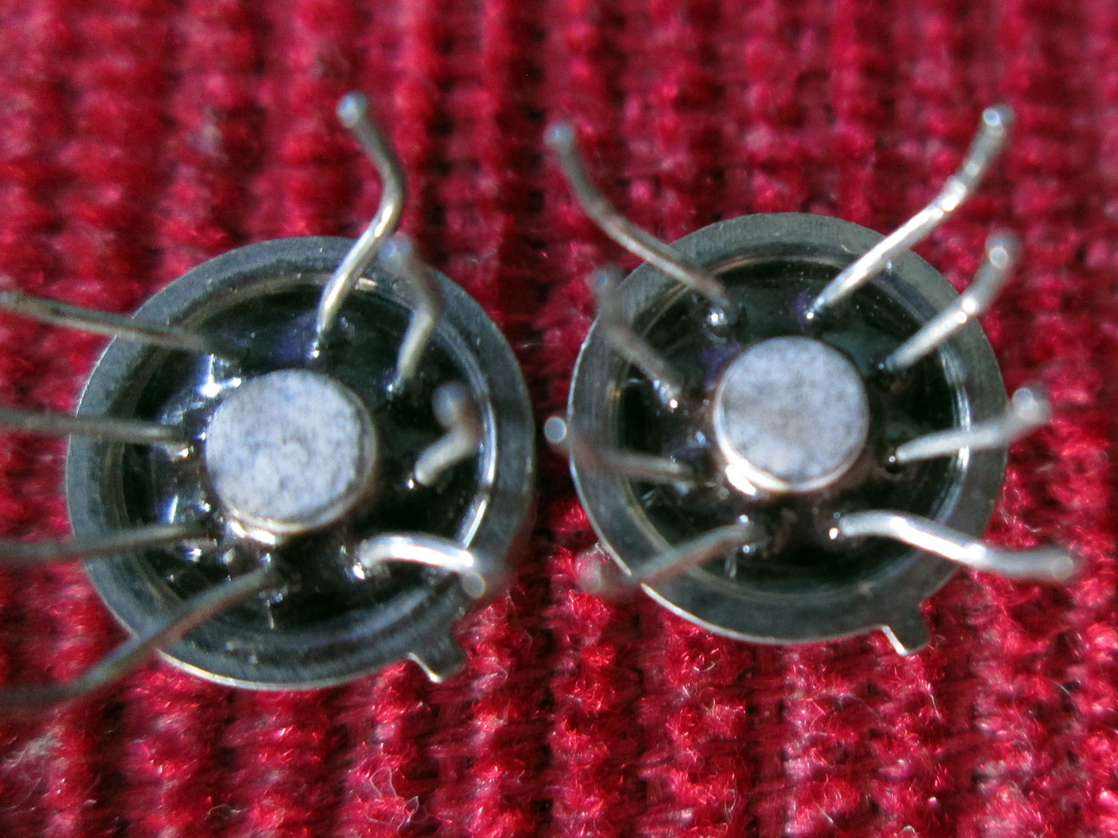

no edit button there, so I upload the picture here.
the two identical Cans OpAmp are "fake" LME49720HA, the other one is original LM4562HA (but a dead OpAmp because of oscillation).
the body & the seating plane of the fake LME49720HA looks dirty whereas it should be a new items.
Iq of less than 1mA, I guess it's a second hand LM358H or the like.
this is a proof, although they may be sell so little quantity, on a not-common type Op Amp, they do counterfeit them.

Kroto, if you look carefully at the first picture you posted, you can see what appears to be scrape marks on the top of the IC from the pin 1/8 end to the 4/5 end -- left-to-right in your picture. That makes me suspect that the original marking was 'sanded' off and replaced by new marking. Also, the molded "Korea" on the bottom is odd as I believe that National's assembly is in Malaysia, though it's possible that post-acquisition TI may have moved it.
