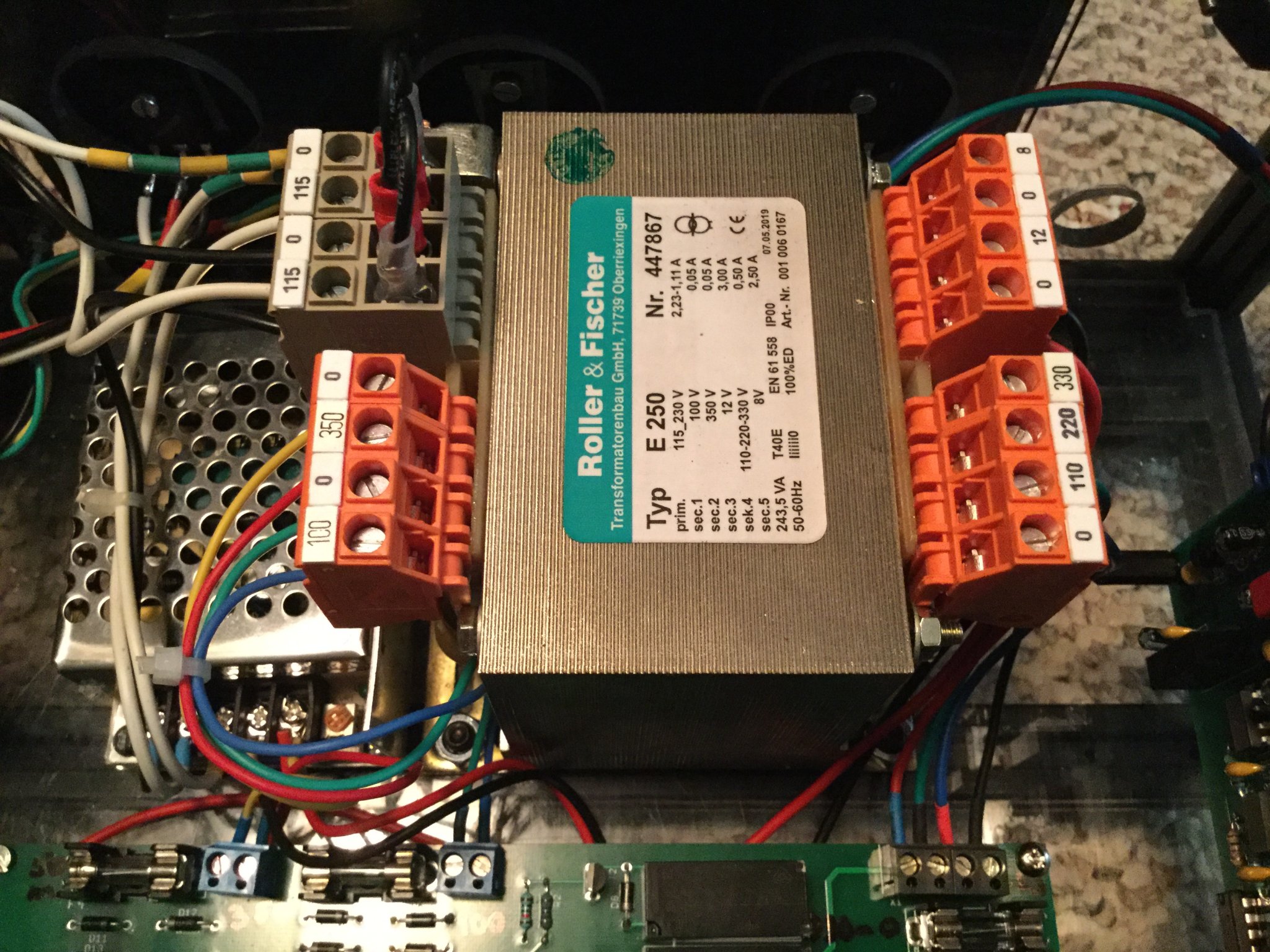

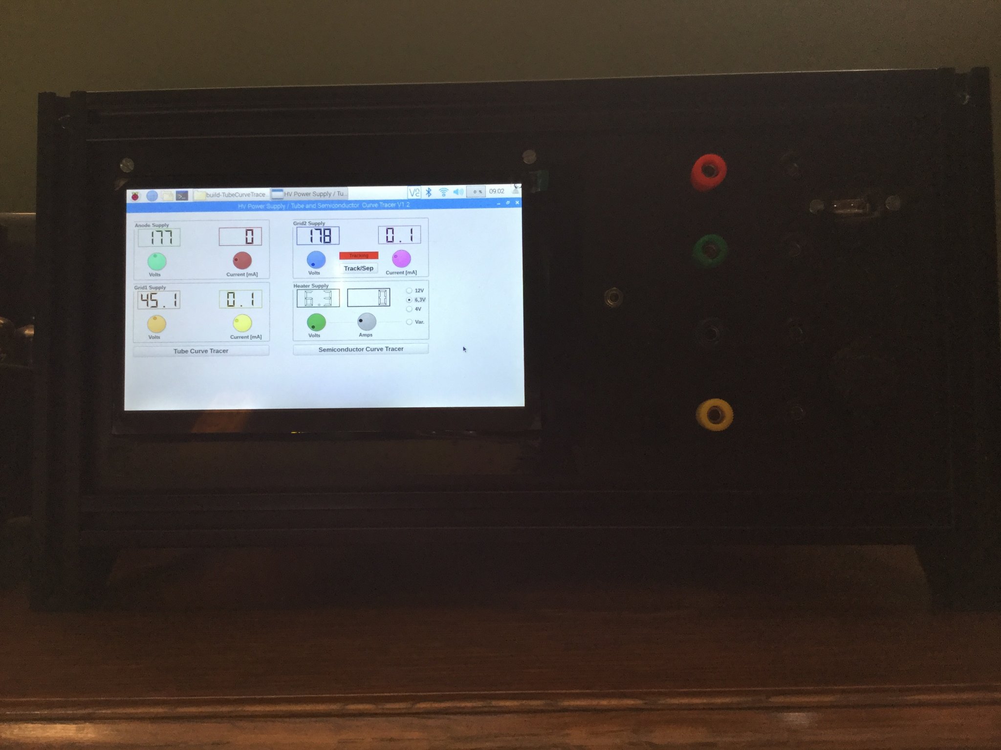

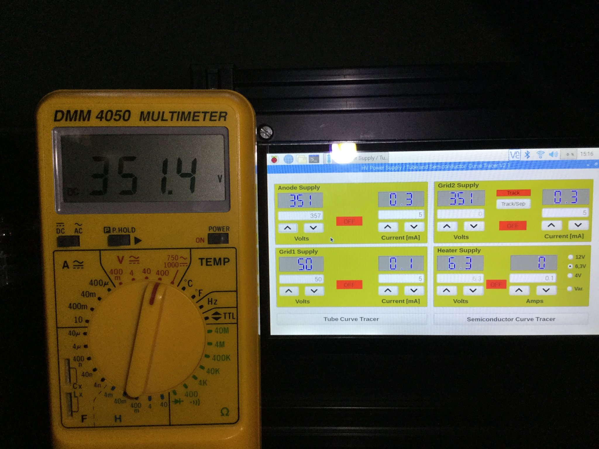

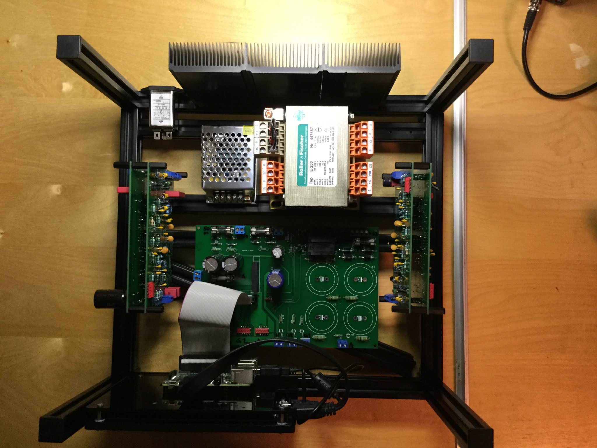

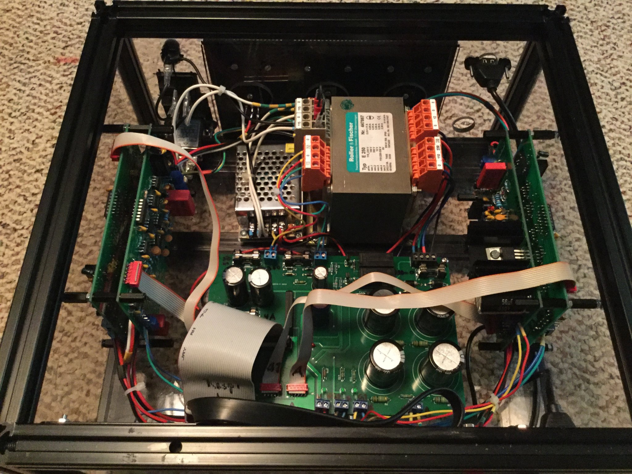

I have build and —made upgrades— (hard- and software-wise) of this unit from an old Elektor article. (https://www.elektormagazine.com/lab...emiconductor-curve-tracer#/comments/labs/1527). LOTs of Kudos to Rainer Schuster who’s been an excellent help!
A YT video explaining the unit:
I have modified PCB and schematic and did some changes to the source code (a good start is also the source code provided by another fellow user on the Elektor board). I also wrote a Python GUI for the remote supply, so, if you like you can use ist as a stand-alone power supply. I also made a LTSpice model for the analog part of the RemoteSupply, so one can setup different voltages. Some pics attached.
If you’re interested we can make this a project….
p.s. I stand corrected: only 12-bit ADC/DAC (which, IMHO, is sufficient) and a RPi with 7” touch display, no Arduino. Unit runs completely standalone. Display can be omitted and RPi accessed/controlled via VNC…

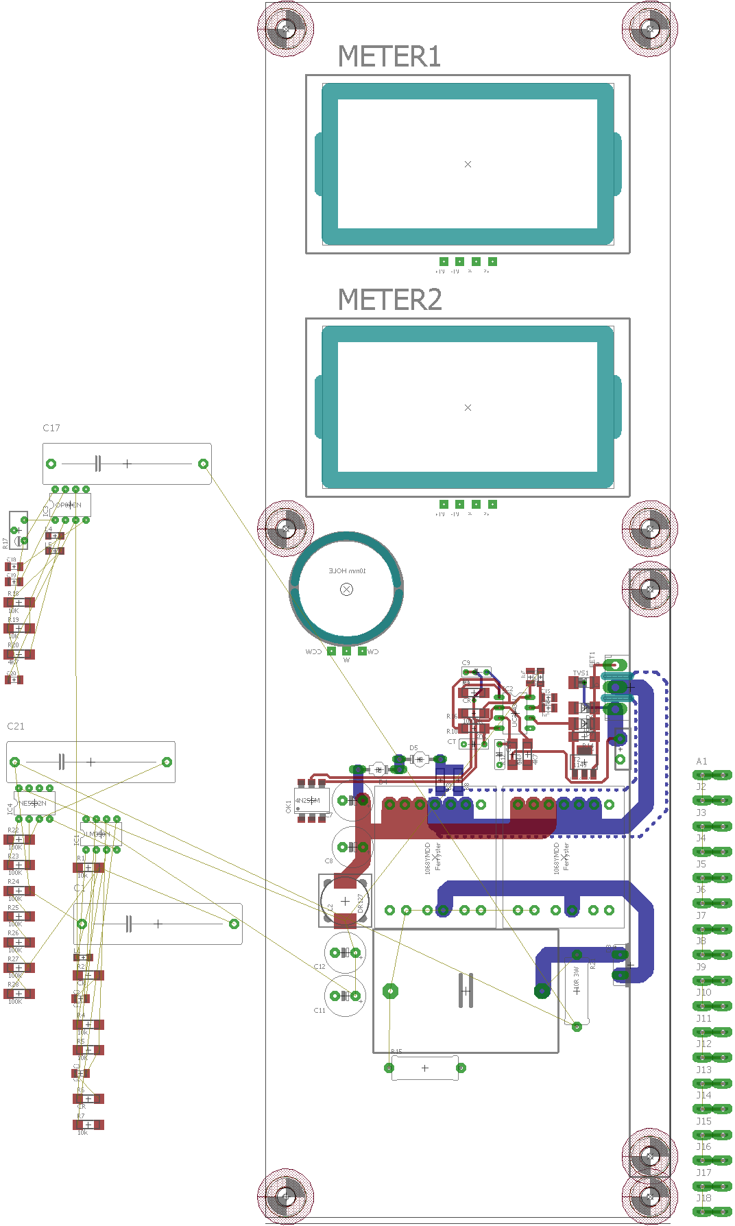

See attached a screen grab from the tester i was working on. My idea was to use a single 24VDC power bus from a standard off the shelf mean well. So you dont have to deal with mains voltage. And the supplies use a standardized mechanical template.
Every supply is current and voltage controlled with CC/CV indication. This is a must for most of the supplies as it protects both the equipment and tubes from damage.
