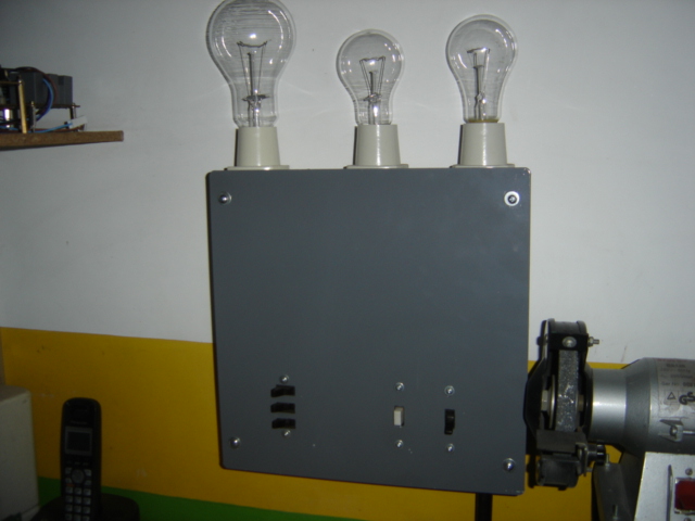

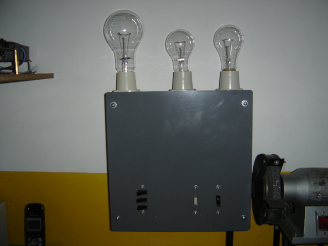

Thank you Osvaldo to point that,
In fact I have a current limited supply, a Light bulb tester (basically a 300w filament bulb in serie with the mains live)
Hi, thisndently switchable with the 3 black switches at the bottom left corner, it may be paralleled to give 100, 200, 300, 400 500 and 600W in series. The outlets are below the work bench. Note here the supply is 220VAC (Under normal conditions).
