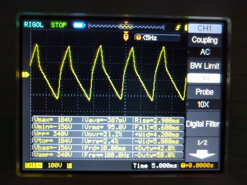

I posted a scope measurement of my 5Z3P rectifier earlier and the trace seems odd to me, shouldn't it be a semi-sinus with only positive voltage and twice the mains frequency?
I got twice the mains frequency (230V 50hz) but the trace is weird and seems to yield a negative voltage too...
EDIT: arrrrgh I just realized I took the measure in AC Coupling, no wonder the traces and measures are bonkers ......stupid

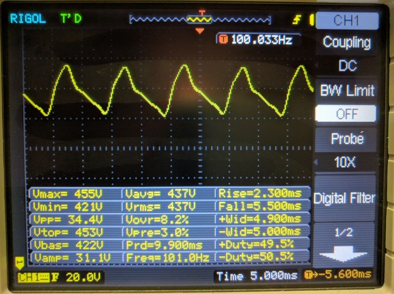

Measurement done again but in DC coupling
Seems fine to me...

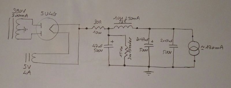

You mentioned a Choke input filter in your amp topology (Rectifier, Choke, Capacitor).
(Usually that kind of filter continues on with a Resistor and 2nd Capacitor).
But the Raphaelite CSK30 schematic you posted uses a Capacitor input filter (Rectifier, Capacitor, Choke, Capacitor).
Are you using the original circuit in the schematic, or are you using a choke
input filter?

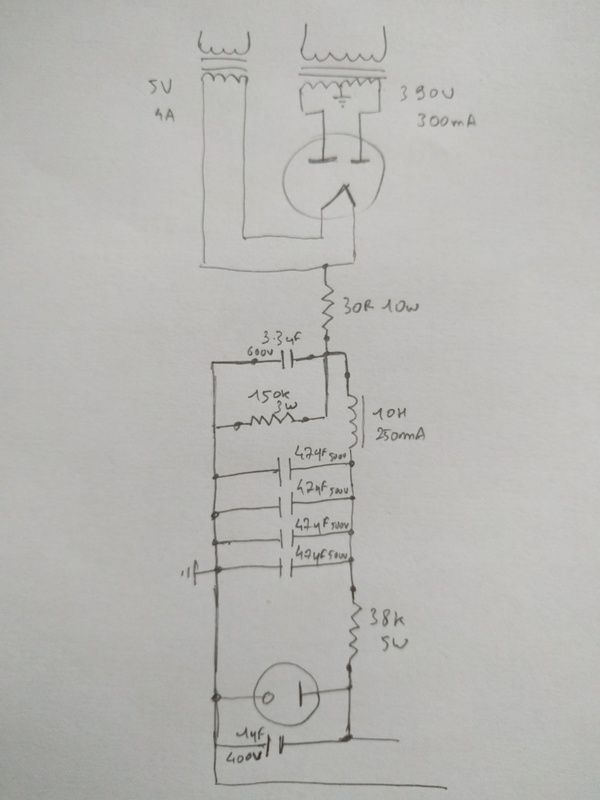

you're right about the input filter, the first component after the rectifier+res(// to regulators) is the first 47uf cap of the double 47uf 500V cap then the choke.
Shall it be possible to:
1. putting a 2.2 or 3.3uf 600v PP cap first, then the choke, then the two double 47uf caps?
2. converting the capacitor input filter to a choke input filter (choke, then first double 47uf cap, then resistor, then second 47uf cap)?

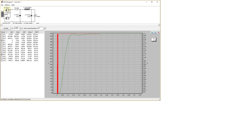

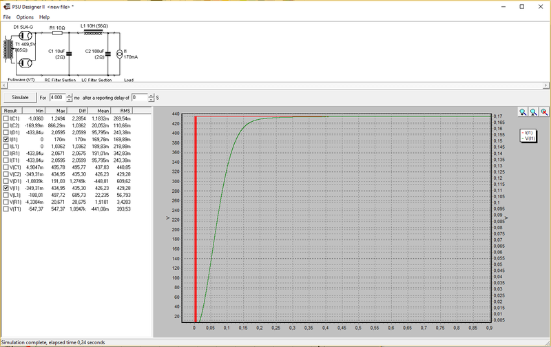

I tried a simulation in PSUD
However, what do you think about changing the capacitor input filter?

First the original schematic
And the simulation in PSUdesigner (green is voltage, red current)
not so bad, but a little bump in voltage and the mighty 47uf first cap
Now a new simulation with some parts values modifications:
Seems much better and with only a 10uf as first cap.
Here the two modified schematics I came out with:
1
With the 10uf first cap and a 47r res in series with the HT center tap for higher plate winding impedance.
2
Same as the first one, but with the addition of a virtual center tap for the filament winding (idea taken from the Emissionlab 5u4g data-sheet), I don't know if this is right like this.
