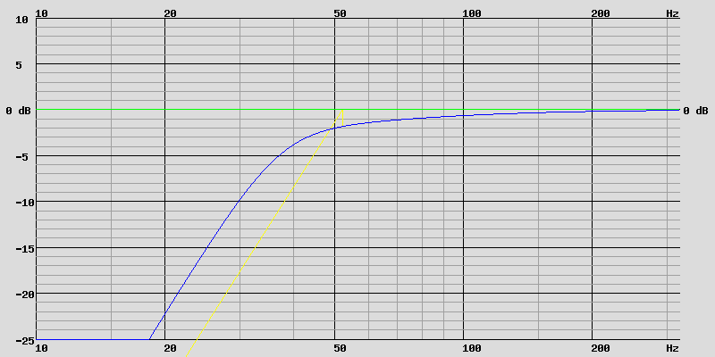

Recently, I checked if the MB15X301 could work in my cabs (also a 2-way).
It won't do 30Hz, but it's an interesting driver nonetheless.
  • RCF MB 15X301, VB = 192.0 L, FB = 37.0 Hz, le 0 dB correspond à 97.4 dB-2.83V.png

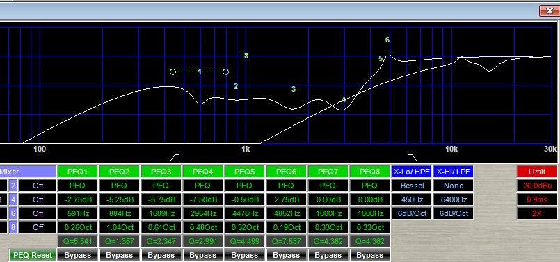

My experience with the BMS 4592ND is that it just needs EQing. The figure below for the midrange diaphragm output channels of 4592ND on a K-402 horn. There are three more input PEQs for the crossover interference bands:
attachment.php
Chris
Thank you so much for your post ErnieM! I really appreciate you organizing the tactic, it’s all new to me, so I needed the oversight.
