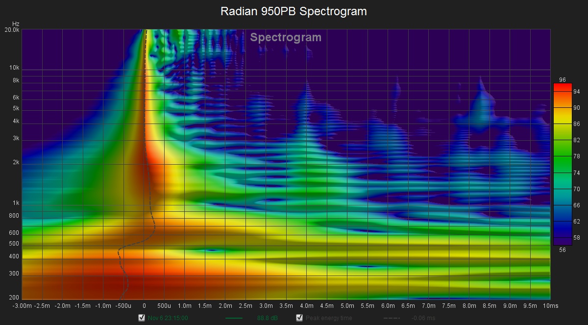

I'm guessing the break up would show in the form of heightened THD to which I have not found a distortion graph for Radian yet.

Nice review of the radian 950 I’m considering
Test Bench: Radian Audio Engineering 950PB and 760NEOPB Compression Drivers | audioXpress

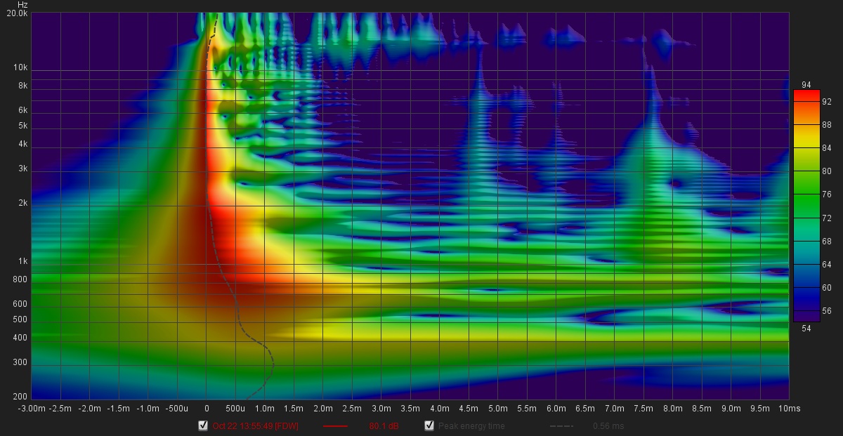

I usually look at a spectrogram of the 10-20 kHz region (SPL vs. freq. vs. time). It's usually quite easy to spot there, especially if you use a bit higher SPL (90-100 dB at 1m). Below you see a spectrogram of a P.Audio BM-D750 driver (rebranded as a Klipsch K-69-A) on a K-402 horn, showing the distinctive 13.8 kHz non-pistonic breakup mode, above which you also see a phase lag, chattering echoes across the 8-20 kHz band, and loss of SPL above the breakup mode frequency:I'm guessing the break up would show in the form of heightened THD to which I have not found a distortion graph for Radian yet.
Chris
Room EQ Wizard, V5.20 Beta 6. There are options for scale: flipping the axes so that the vertical axis is frequency, dark background, etc.Hi Chris, what software are you using to generate these plots?
