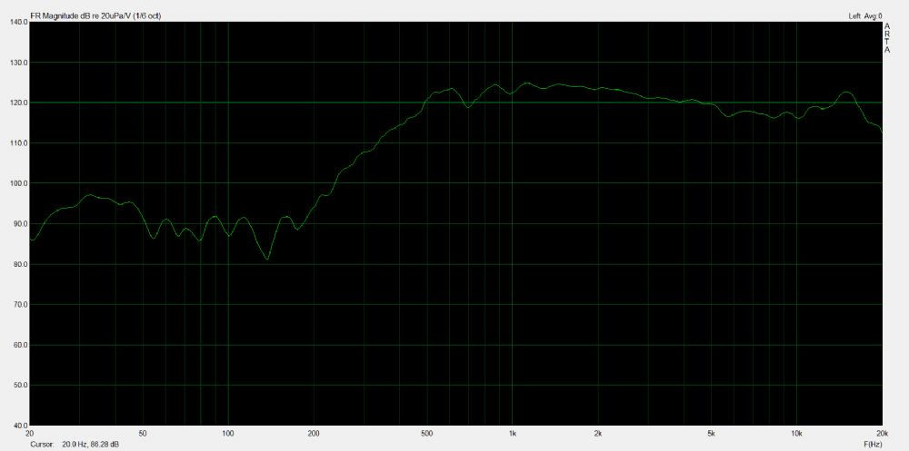

I haven't ruled out the Radian lm8k, that might be worthy of building a horn for. I find it strange that there's no information on the internet about this driver though, can't believe no one tried it in a two.
Or this?
Does 600Hz easily with the HF950 Horn and I bet it'll take 400Hz with a K402 or similar sized horn.
Raw reponse on a custom 60x40 horn about the size of a XT1464 (No EQ, no HPF):
