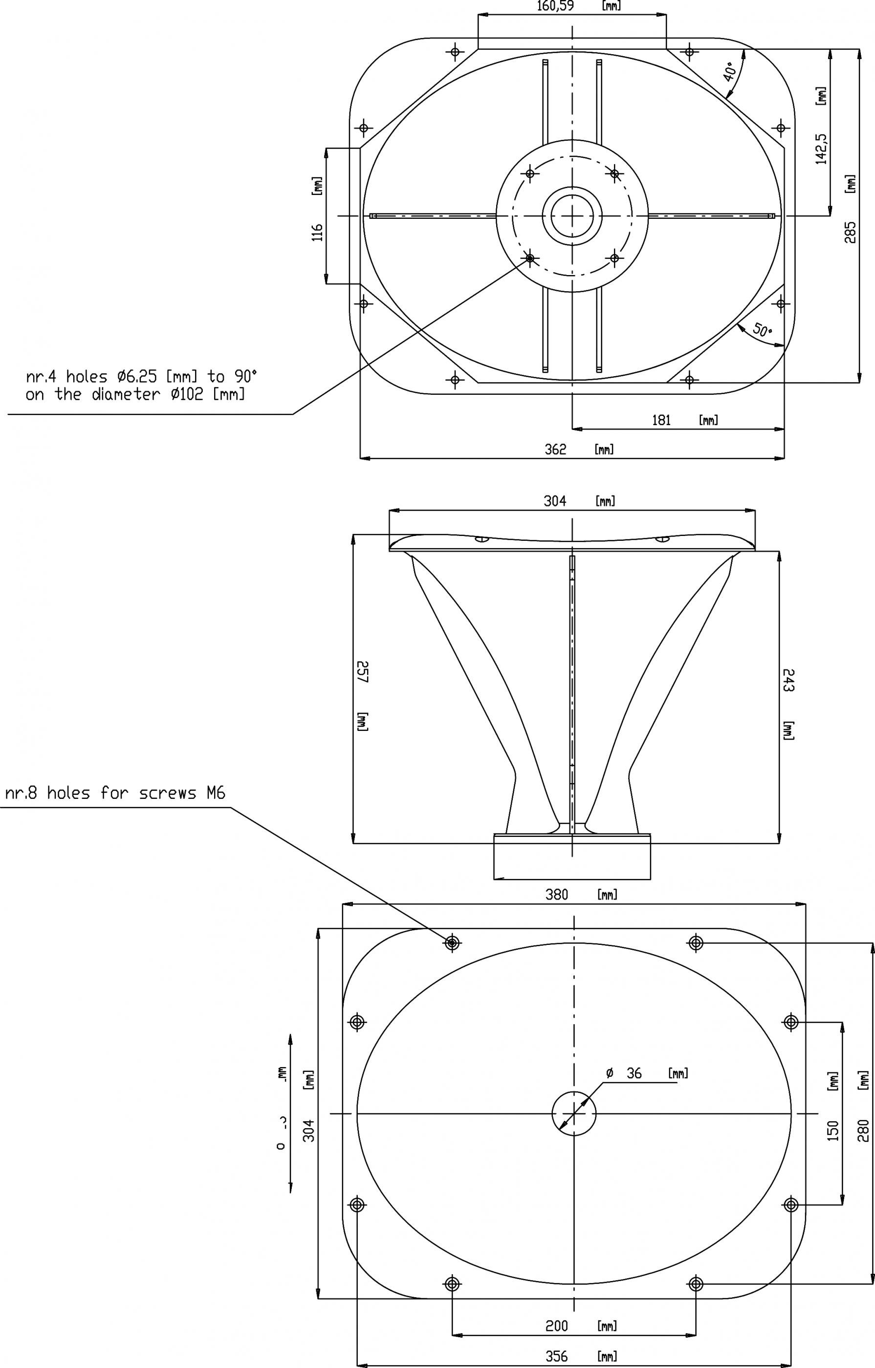

See the sketch of the xt1464 below. In the middle drawing it appears that there is a constriction in the throat? Am I looking at that right? After all the work I went to to match the compression driver exit angle with the horn throat angle, such a constriction seems like a terrible thing. Hopefully I'm misunderstanding something.
Edit: otherwise seems like it measures great. It's long enough to give adequate output on the high end to still use SET amp, and seems to extend down to 500hz usable with some cd's and a little eq.
Almost appears to be a hidden dispersion slot.
No number of small enhancements eliminates the relatively severe time-domain distortions inherent to the application of a diffraction slot to achieve high VHF dispersion."
This was discussed a few months ago. It's not what it looks like. In hand reports show no constriction in the throat.

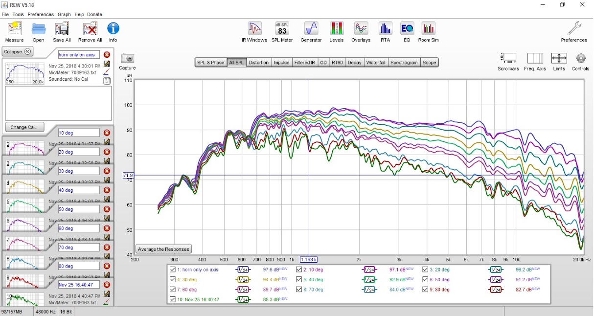

Just when you thought you knew a driver....this graph does not look as pretty as the one on the Radian website. *Facepalm* maybe its the horn...Radian does specify they used a horn with a wider angle 120 x 40 be exact. TO bad they didn't have enough sense to specify the actual brand/model...I'll call them I guess.
All 4" non-beryllium diaphragms look rough above 10khz(though that RCF looks pretty good considering). If you want the best, save up for the Be version and call it a day.
Those plots are also misleading as well since the drivers aren't EQ'd flat before measuring. The 950 graphs show a huge dip in the upper octave frequency response curves. This will look better in the waterfall plots of course.
