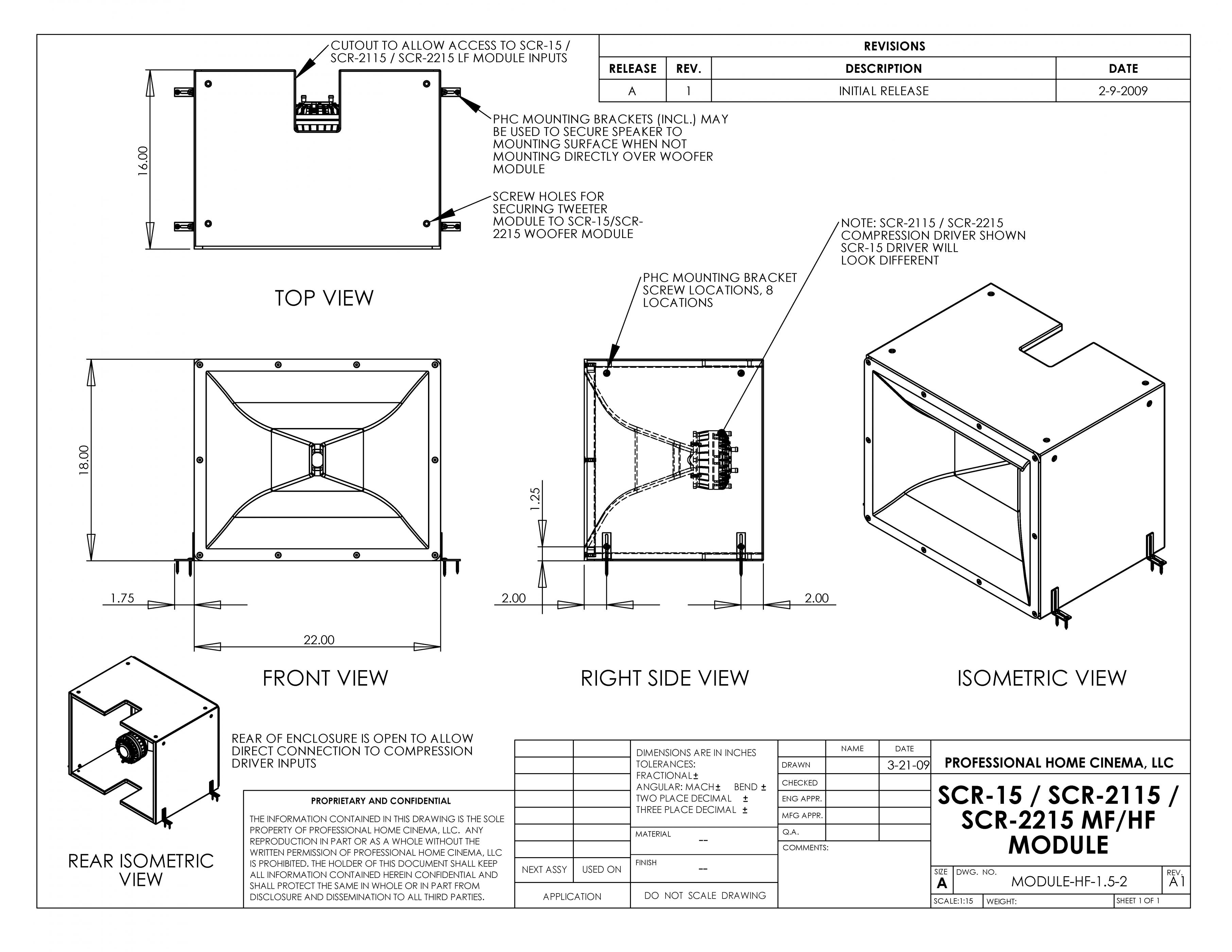

most interesting is the 22" width horn as this is larger than the similar horns I am able to find which max out around 17" width.
+1 to that... Maybe I should just buy a phonograph horn, :D
So I think I'll be able to eventually settle on a horn and driver based upon the depths of this thread, though I keep eyeballing this guy Beyma TPL-150/H AMT Tweeter, I'll likely get the radian 951 (or similar) and the biggest 90X40 horn I can find. I called them several times today, no answer.
My bass amp is a crown CTS 1200.....I kinda like the quad 303 for the tops, but its not grounded....any suggestions on a grounded signaled amp for the tops....one that doesn't cost a fortune that is?
That horn isn't difficult to clone: straight sidewalls and conical top/bottom with a large flare. I would smooth out the slot.
It's basically a triangle with a slit, through which the curved top and bottom enter the mouth.
From
