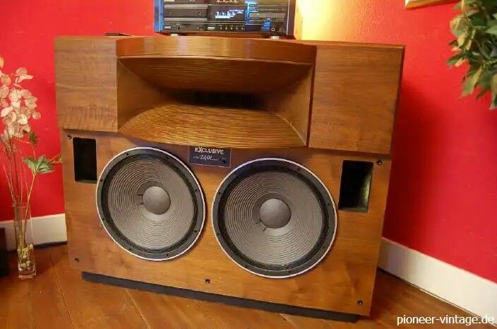

A 2" compression driver crossing at 500hz for club levels, are you crazy ?
The horn would be say 36" wide alone !!
Like the giant butt crack jbl theater horns!!!!
Jbl went away from setups like that to horn loaded mids because of distortion reasons.
Otherwise, 750hz (low to me or not crossed steep enough).
May be time for a 3 way.
