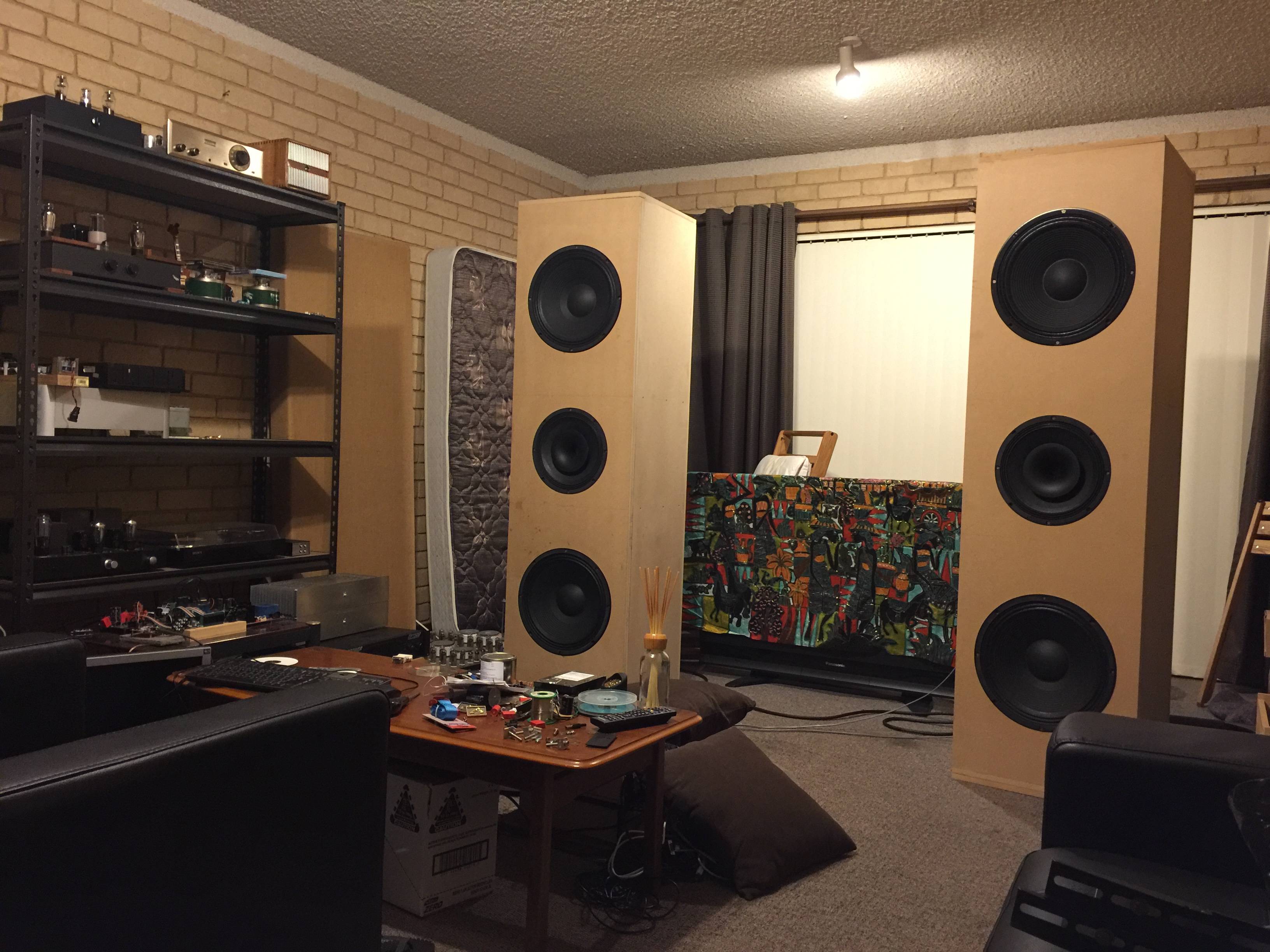

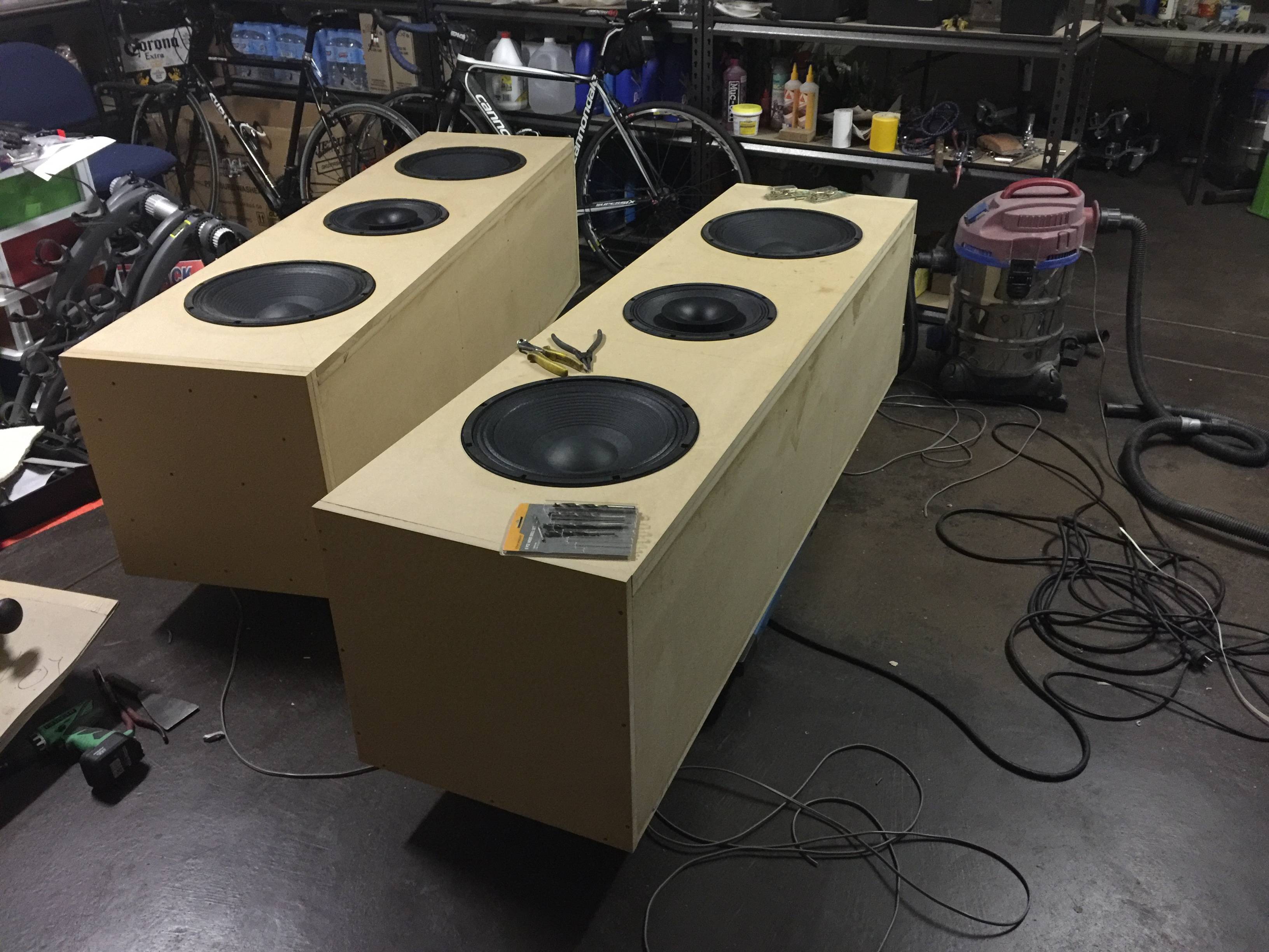

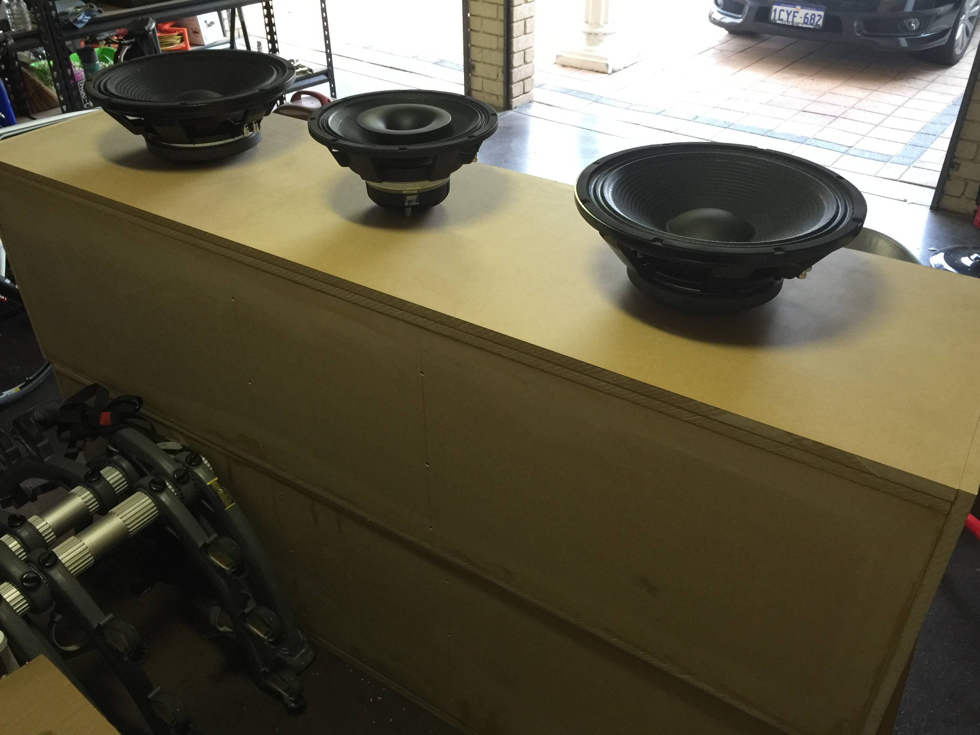

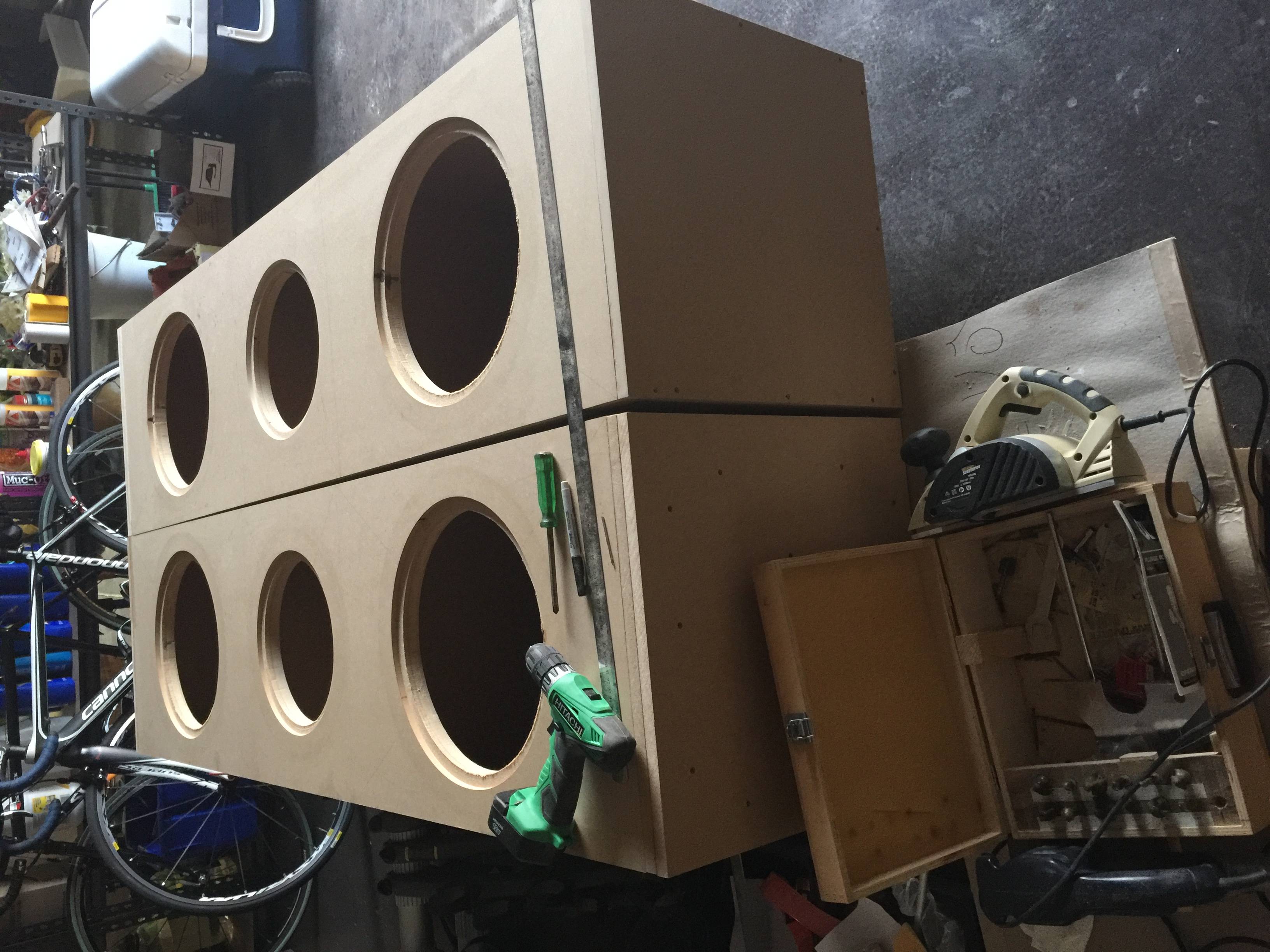

Xo by ear. Coax enclosure about 70L. I may open a seperate thread to help improve the config. Here are couple of photos of the speaker build. I got distracted with other things and left them unfinished. Only recently decided to get back to them after few years.
Going to order the Faitals just for fun anyway (the woofers currently too cheap with local supplier to pass up). Will swap the 12” coaxial with ph-4220 90x40’ horn paired with Faital hf108r. I’ll likely ask for help to optimise the setup!

You'll need to measure these in order to optimize the crossovers of the coaxials and to acoustically blend the coaxials with the woofers.
