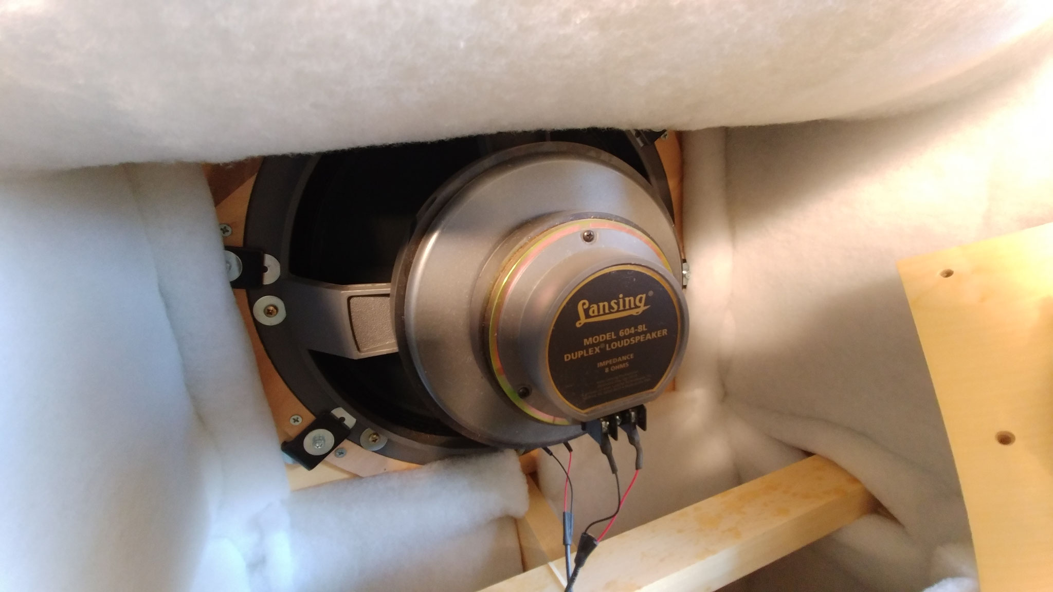

Xo by ear. Coax enclosure about 70L. I may open a seperate thread to help improve the config. Here are couple of photos of the speaker build. I got distracted with other things and left them unfinished. Only recently decided to get back to them after few years.
It would definitely be wise to measure the Response outside in order to properly set up the crossover and frequency response correction.
70 liters closed-box is rather large for this woofer when used as a low-mid.
The build qualitiy is nice. But with this choice of drivers you would have the chance to build a "real" D'appolito by mounting them as close as possible. Keep in mind that this will be even more important as soon as you use a horn instead of the coax which makes using an even higher crossover necessary.
Leaving such large boxes unfinished is not a bad thing as long as the x-over is not fully sorted out because you might have to schlepp them inside and out a few times in order to measure and tune them.
Regards
Charles

Drivers are indeed wide apart, which would probably result in lobing issues.
tuyen may consider replacing the baffle.
70L is quite big, but a quick sim revealed no issues. However, I would use this driver in a BR configuration.
The 15G40 is a typical PA woofer. It won't go very low, no matter the type or size of cab it's mounted in. It does play quite loud though.
It's true, the Faital 15PR400 or PH500 are much better suited for midwoofer duties and could also be used without subs.

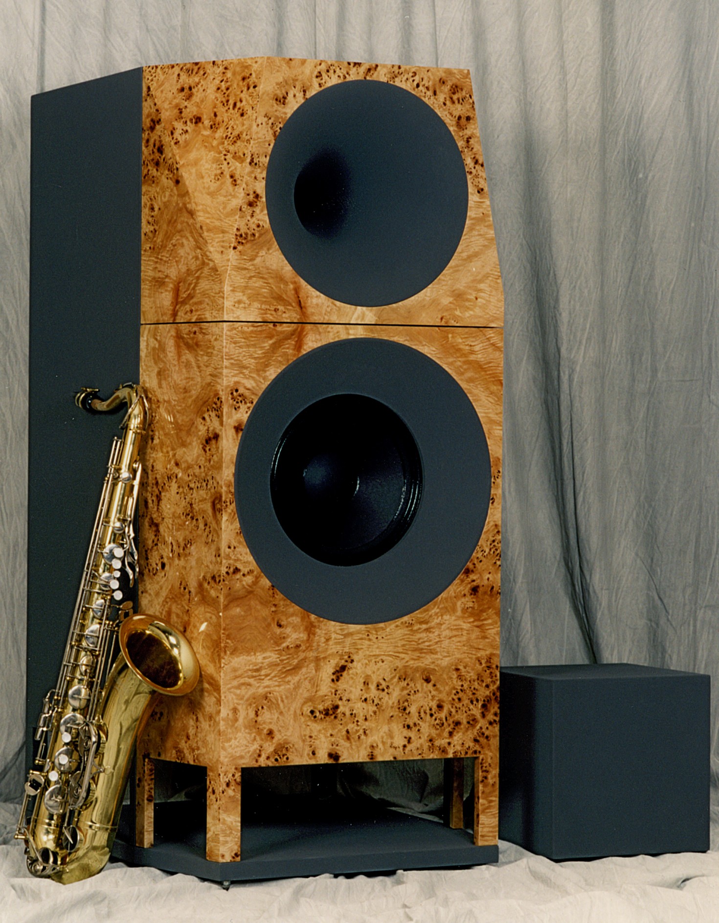

The 2-way below was produced by the same manufacturer that made the Altec Duplex loaded horn speaker above.
Both the 12" woofer and 1" compression driver are Beyma units.
Behind the Tractrix is presumably the CP380M, crossed at an ultra low 650Hz.
Try this with another contemporary 1" comp. driver.

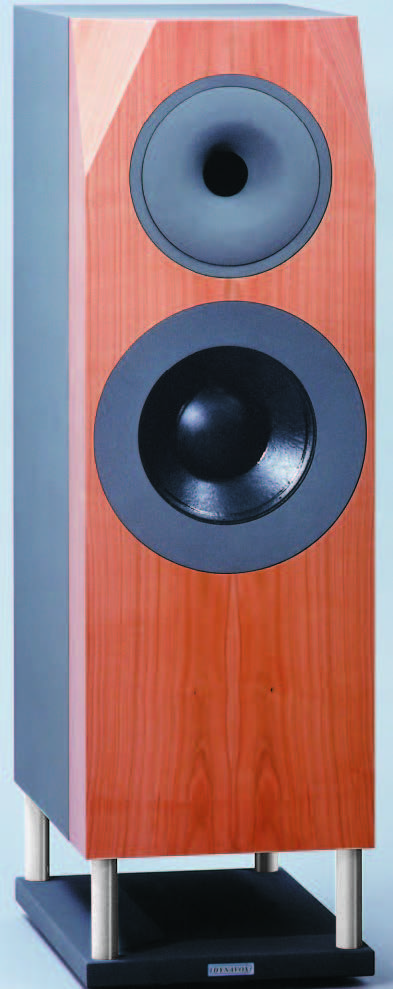

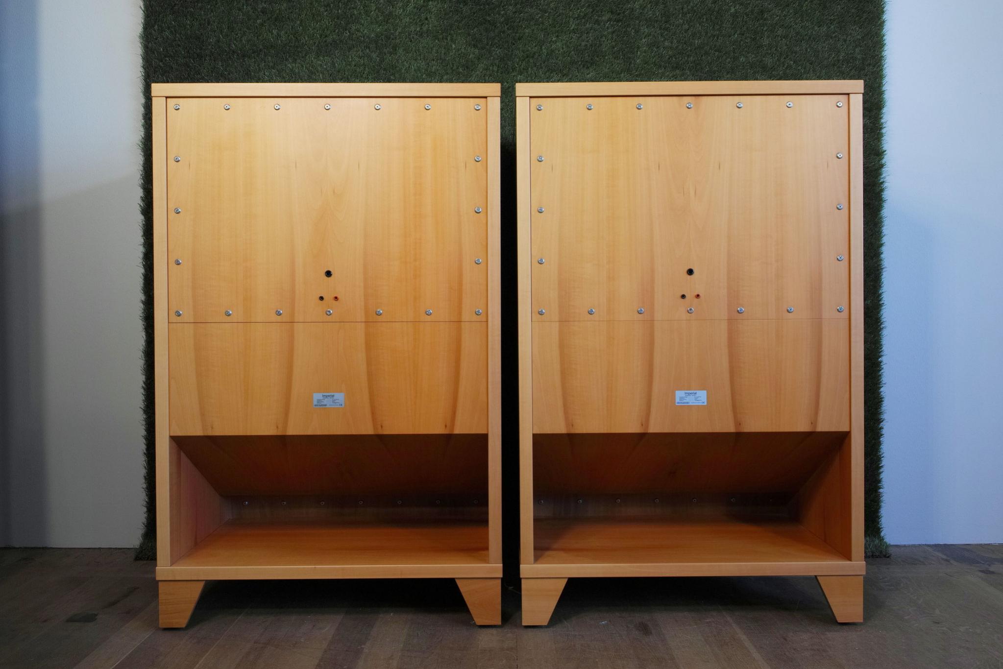

Smaller brother of the previous 2-way.
Technical details
Technical details
- Principle: 2-way full range horn loudspeaker
- low / mid tone: 30cm, cellulose membrane, cast basket
- treble: 260mm TRX (Tractrix) horn
- Transition frequency: 1100Hz
- Lower cutoff frequency (-3dB): 35Hz
- Efficiency: 99dB / 1W / 1m
- Impedance: 8 ohms
- load capacity: 150W
- Recommended Amplifier Power: 3 - 100 watts
- Recommended room size: 20 - 60sqm
- Recommended installation: close to the wall (20 - 50cm)
- Dimensions: H 1250 x W 430 x D 600mm
After looking at all these commercial designs. I think I made my cabinets too big and drivers spaced too far apart from each other.

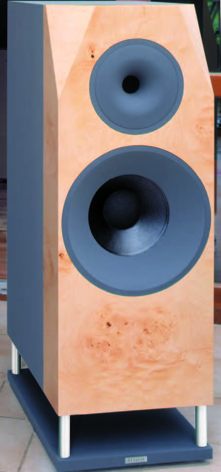

And for the sake of completeness, the smallest of the range.
Technical details
Technical details
- low / mid tone: 25cm, cellulose membrane, cast basket
- treble: 230mm TRX (Tractrix) horn
- Transition frequency: 1300Hz
- Lower cutoff frequency (-3dB): 38Hz
- Efficiency: 96dB / 1W / 1m
- Impedance: 8 ohms
- Recommended room size: 12 - 25sqm
- Dimensions: H 1100 x W 330 x D 550mm
- Weight: 55kg / piece

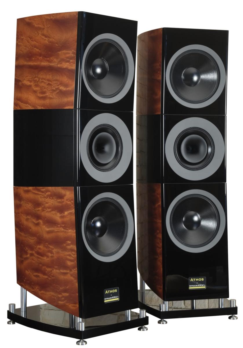

This one is from the same manufacturer, his latest product:
Why am I posting these?
Because I think these designs fit within the thread, could be a source of inspiration and are not too difficult to recreate.
