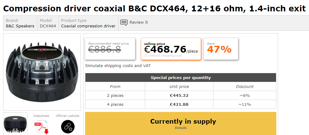

do you have any info/experience with DCX464 vs 4594nd for HIFI?
464 is new I know but you seem to have up to date info on many new things 🙂
It's new and I know it's being tested.
As expected initial reviews/tests will be published in the coming months.
"Compression drivers are the linchpin of a PA system: operating at wavelengths too small to readily couple with other drivers, they alone have to fight distance and atmospheric losses to deliver concert sound pressure levels to ever larger audiences.
Enter the DCX464 coaxial ring radiator, designed from scratch to advance the state of the art. The DCX464’s midrange diaphragm covers 300Hz – 5.5kHz with 110dB sensitivity, and its 100mm voice coil handles 220 watts. The 64mm coil high frequency diaphragm covers 3 – 18kHz with 112.5dB sensitivity and handles 160 watts. A patent pending midrange integrator allows both diaphragms to work in harmony over a wide bandwidth, for greater combined output and crossover flexibility. All this energy arrives at a 1.4” throat, from the most compact package that can be designed today."
It's just a marketing quote... yet, there's little reason to doubt the claims.
The DCM/DCX50 were and are still highly regarded.
The DCX464 ought to be considerably better.
Uhm...I see there's a dedicated thread B&C DCX464. The item costs about 1000$. Any 50 $ tweeter for hifi will play 20dB less and have 1/10 power. That's ok ( for me)

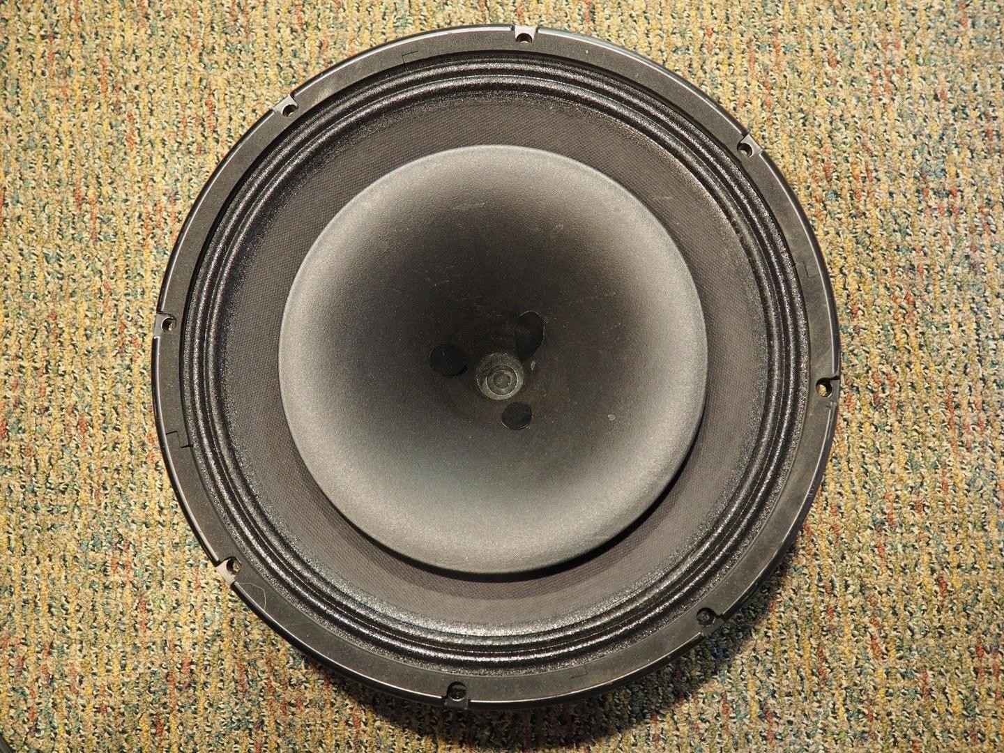

Could you tell us a little more about the waveguide around the 15CXN88?
Any measurements?
I assume you don't have any immediate neighbours?
Any measurements?
I live on a big lake where folks are accustomed to a bit of noise, that... and great neighbors who love seeing me enjoy audio so much. Never stay loud long....

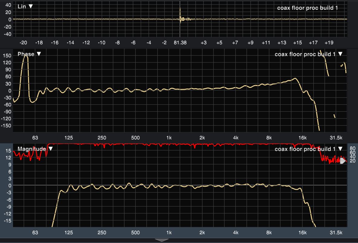

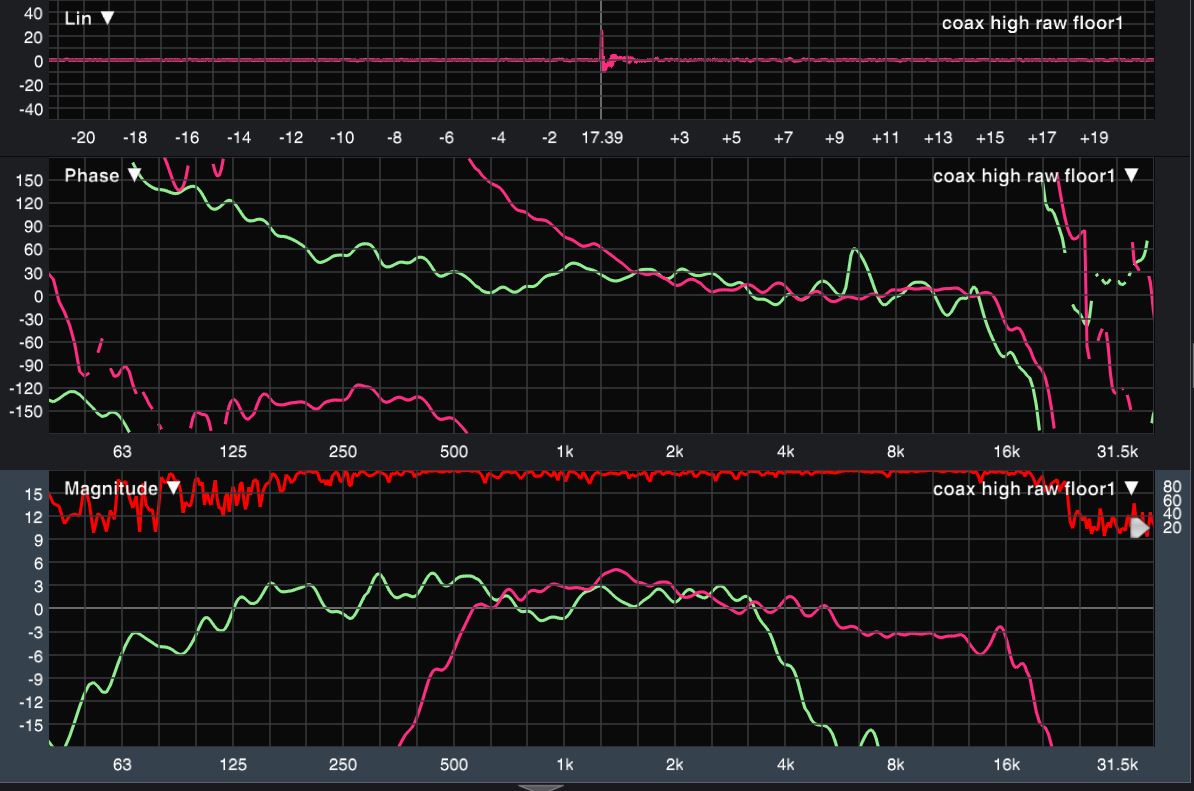

The foamboard waveguide shown in the previous pict still isn't working the way I've hoped.
So right now I'm using the driver flush mounted in the same box, same ports etc....
Raw low and high plots are below,
along with a processed trace using a miniDSP PWR-ICE 250 plate amp. Oh, and I highpass steep at 100Hz....
