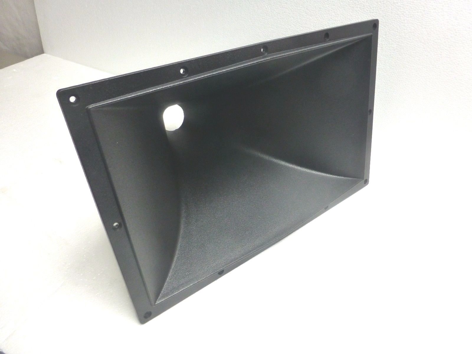

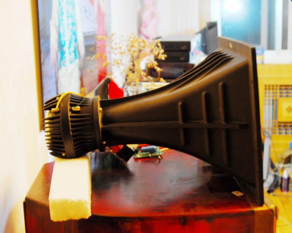

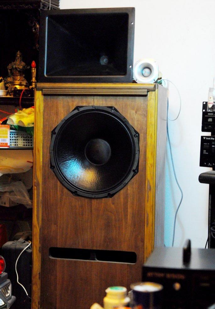

I have a Selenium 4750 90x40 2 inch horn so it suits me. However the build quality of the horn is atrocious. Looks like a child joined the horn with the throat. Package was marked "Proudly made by Harmon/JBL" 😱
For the moment I'm an outcast, I have put Visaton FRS 5X in them😱)

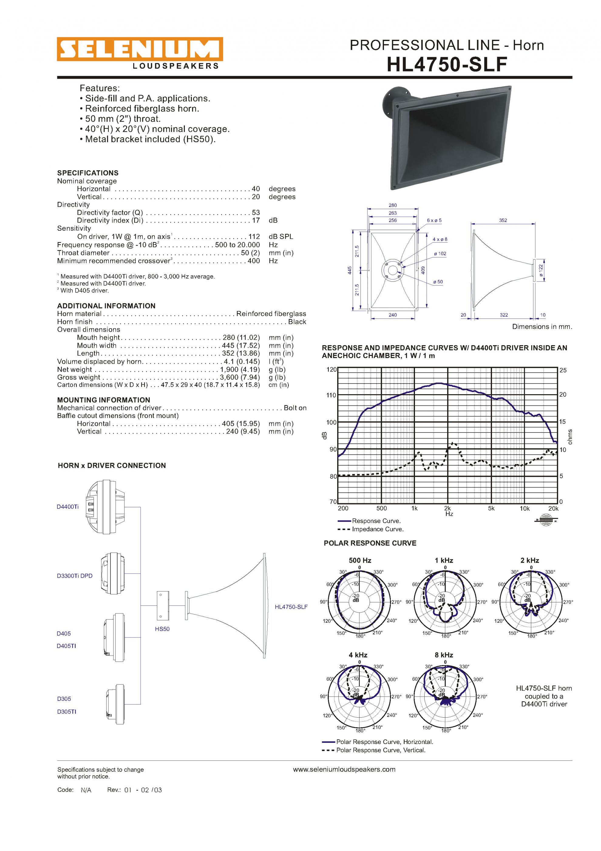

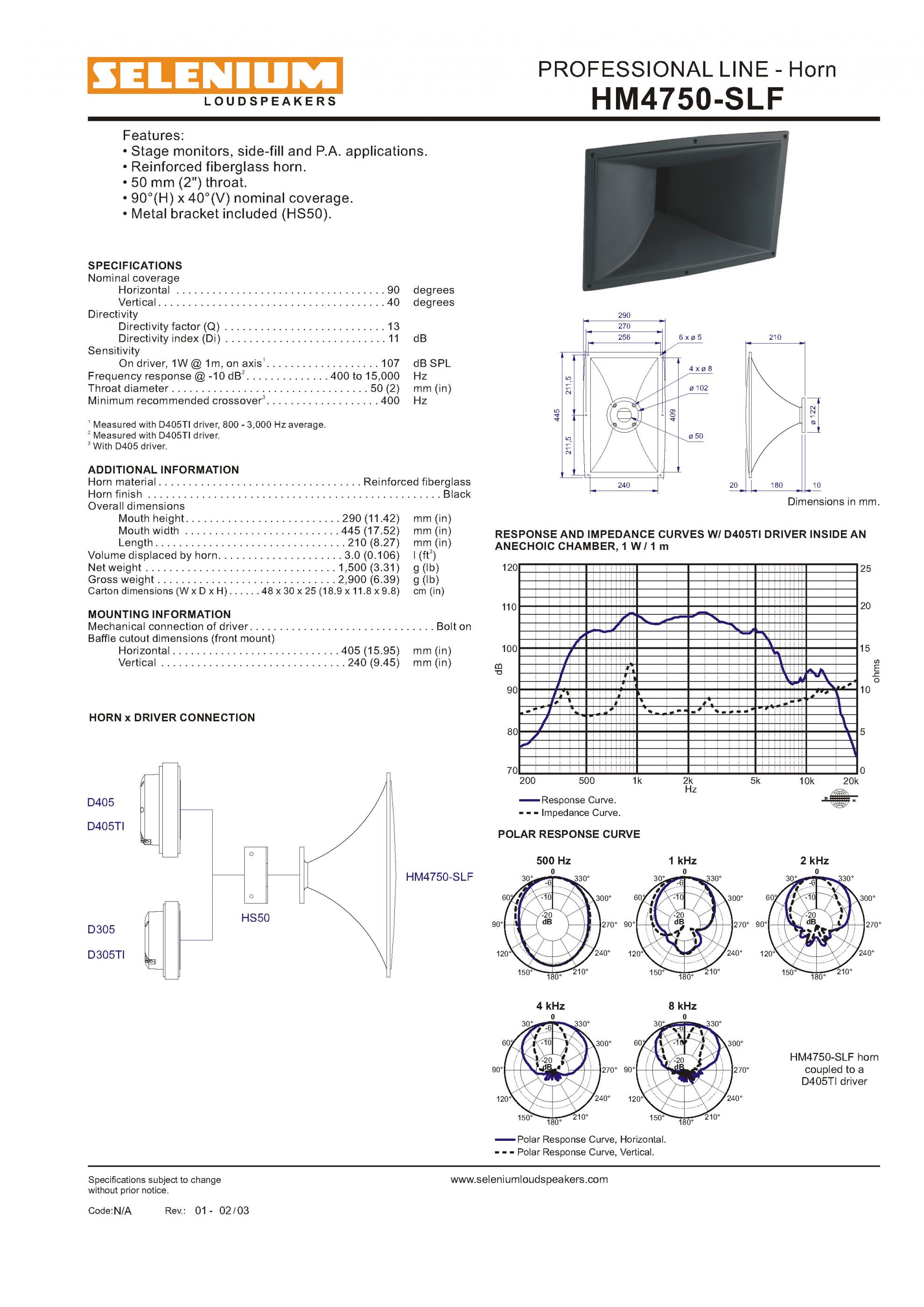

The HM4750-SLF is bi-radial horn with slot.
The HL4750SLF is basically a slightly modified/upgraded JBL 2386.
If you can live with a slightly higher cut-off and get a wider dispersion as a bonus, this truncated clone is a better deal:
The 4750 is basically a slightly modified/upgraded JBL 2384, except for build quality/durability.
It's also very expensive.
If you can live with a higher cut-off and get wider dispersion as a bonus, this truncated clone is a much better deal:
This is the one I have:
JBL Selenium HM4750-SLF 2" Throat Bolt On Large Fiberglass Bi Radial Horn 90x40 | eBay

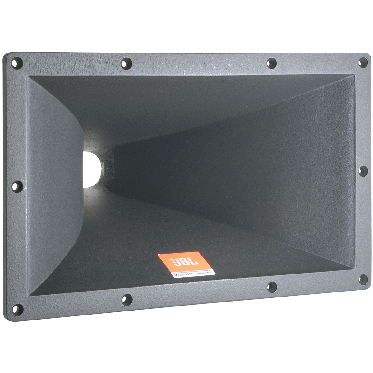

2386, check the throat.
Tip: compare it to the K402 throat.

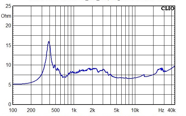

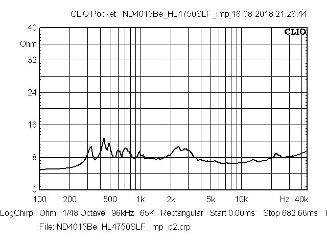

What I mean is in what horn the driver feels more comfotable. Compare the two impedance measurements:
The XT1464 does not load the driver perfectly:
While the Selenium does:
You are absolutely right! The adapter is misaligned and not really planar but the horn itself is quite properly damped.
But also the XT1464 and the LTH142 are plactic bombs and have an unacceptable build quality.

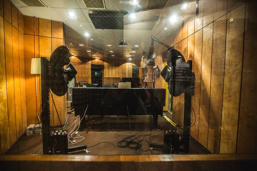

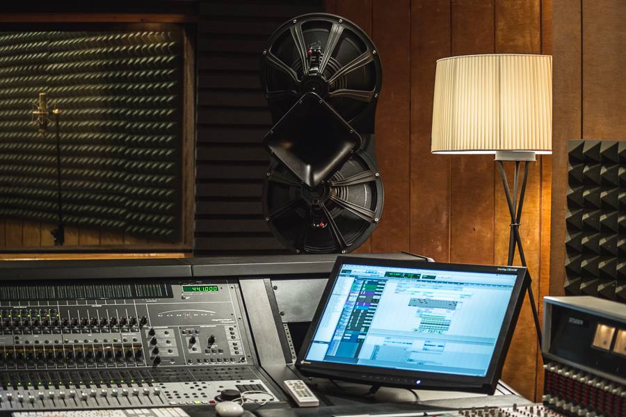

I'm still intrigued by the Reflector design. Would be cool to make a low budget version of it. Of course you could buy all the same components for much less than the asking price, but I'm thinking of something even more budget friendly: XT1464 with HF146 as a basis. Now finding half decent budget 15" or 18" woofers is tricky. The best bang for buck I could find was Oberton 18B450. They are €165,- a pop. You'd then need just under € 1000,- for only the drivers of one side.
If you'd clone the P1805, it would save you 4 woofers. This seems also easier to build and looks less intrusive as well.
True that. It would also give the opportunity to use some better woofers (Faital 18HF500 for instance). However narrowing the "baffle" will compromise the low end quite a bit versus the 4 woofer version. On the other hand, I've had a single 15" OB running for a while, and that wasn't too bad either. Another advantage is the fact that you can upgrade this thing to a 4 woofer version quite easily.
A larger coaxial woofer would be a lot better, especially if it match the directivity of the horn at te XO point IMHO.
But that's the point.... the xo.
I expect the xo to be asymetrical with unusual slopes > there are some hints to be found in the reviews of the Bespokes.
Furthermore I don't think the concept is based on a traditional 'handover' between the horn and the woofers.
The way I see it is this: the woofers literally the create the fundament/background from which the mid-highs emerge (this implies gentle slopes).
The lack of panels eliminates associated reflections, resonances etc. and the woofers practically enfold the horn which, with the aid of dsp should result in point source like behaviour.
Moreover, the woofers and the horn acoustically 'float' in the room, therefore they're not so much sound emitting objects, but rather sound emitting sources.
