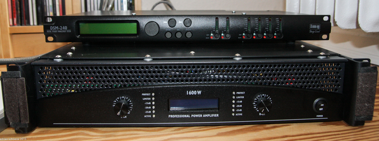

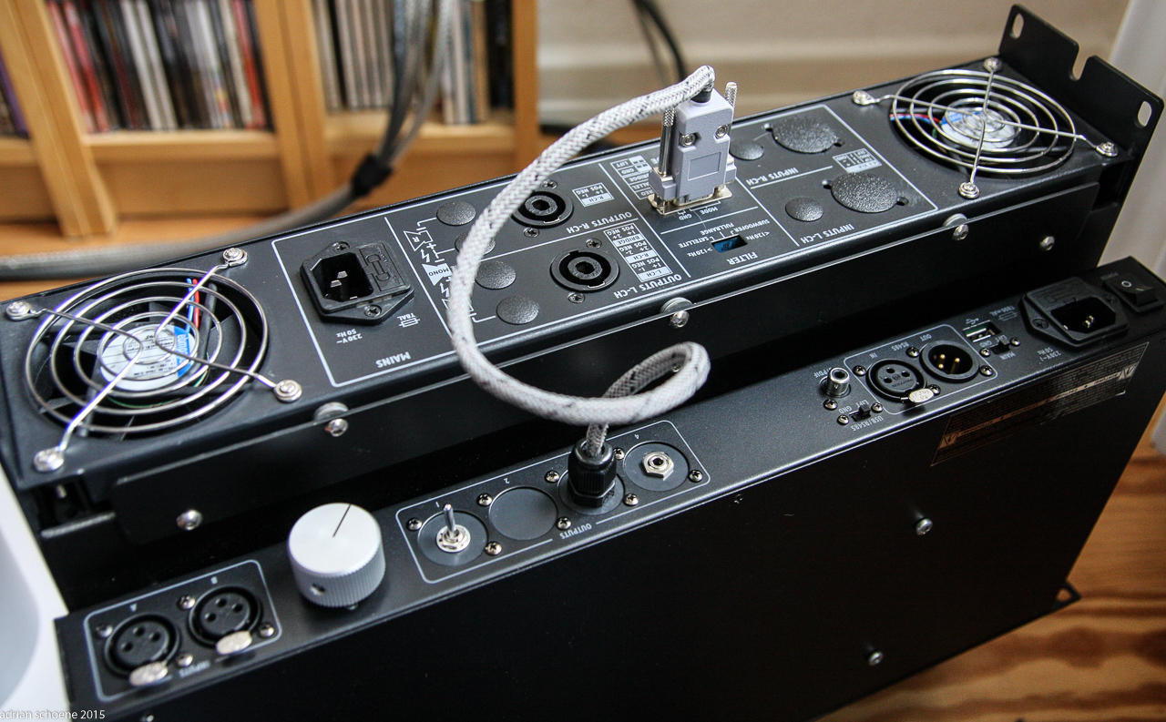

This is the Bullfrog "Active Kit" by the way.
The amp is modded (stripped), which is clearly visible and for the comp. driver a small German 2x10 Watt Class A amp is built into the case of the Monacor power amp. The Class A draws power from the same power supply.

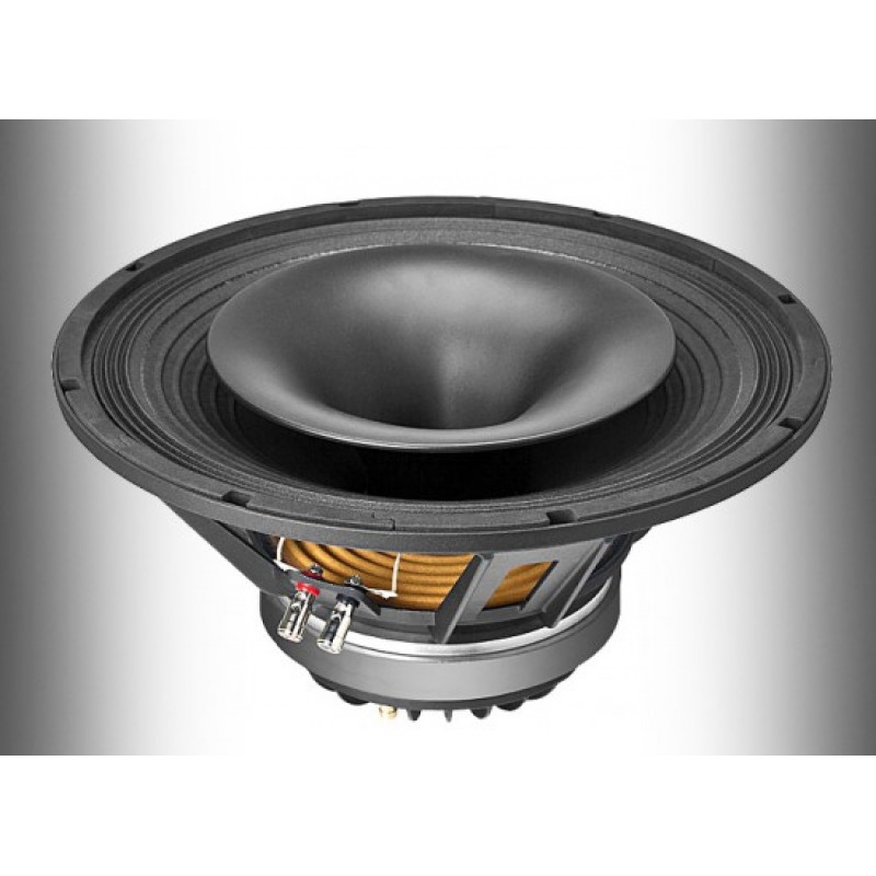

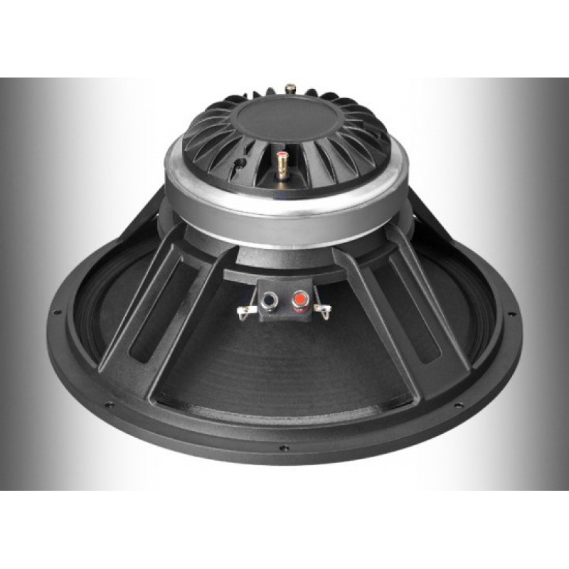

Slightly cheaper alternative 15" coaxial with 3" compression driver.
This would be my preference.
Frequency range 40-18000 Hz
Recommended Fc 1200 Hz
Power handling 400 + 80 W
Max power 800 + 160 W
Sensitivity 99 + 107 dB
Voice coil diametre 3 + 3.00 inch
Dispersion 40° x 60°
Fs 38 Hz
Re 5.1 ohm
Qts 0.28
Qes 0.3
Qms 5.8
EBP 127
EBP criteria Vented box
VAS 246 L
ƞ 3.7 %
Xmax 4.5 mm
Xvar 6 mm
Mms 82 gr
Le 0.9 mH
BL 17.8 Txm
Flux density 1.15T / 1.9 T
Basket Aluminium
Fil bobine Copper + Aluminium
Diaphragm former material Titane
Voice coil former Glass fiber

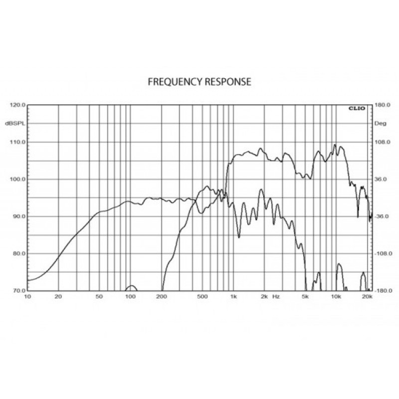

Another interesting coax from an Eastern European manufacturer.
In a stage monitor test, including monitors with the B&C and RCF drivers, this coax was praised for its hifi sound quality.

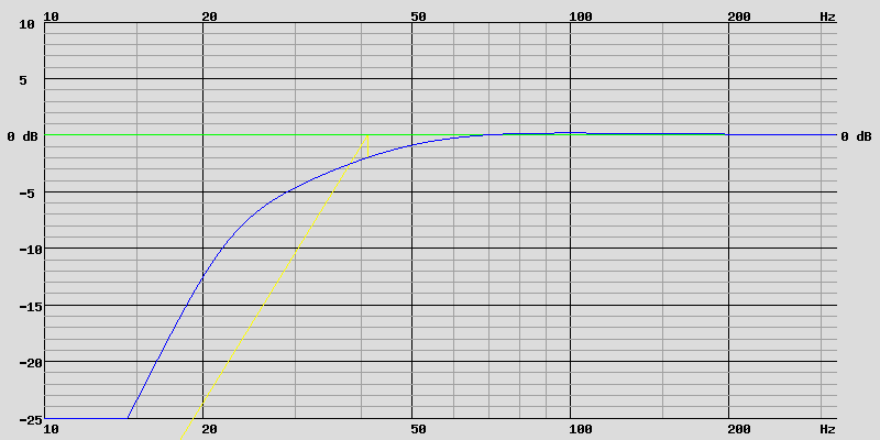

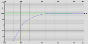

2.8" diaphragm in the comp. driver and the woofer facilitates fullrange applications in a big cab > last image shows the driver in 190L, Fb @ 28Hz.
Doesn't go very loud though.
MAG AUDIO CX15-2, VB = 192.0 L, FB = 28.0 Hz, le 0 dB correspond à 95.3 dB.png6.6 KB · Views: 146

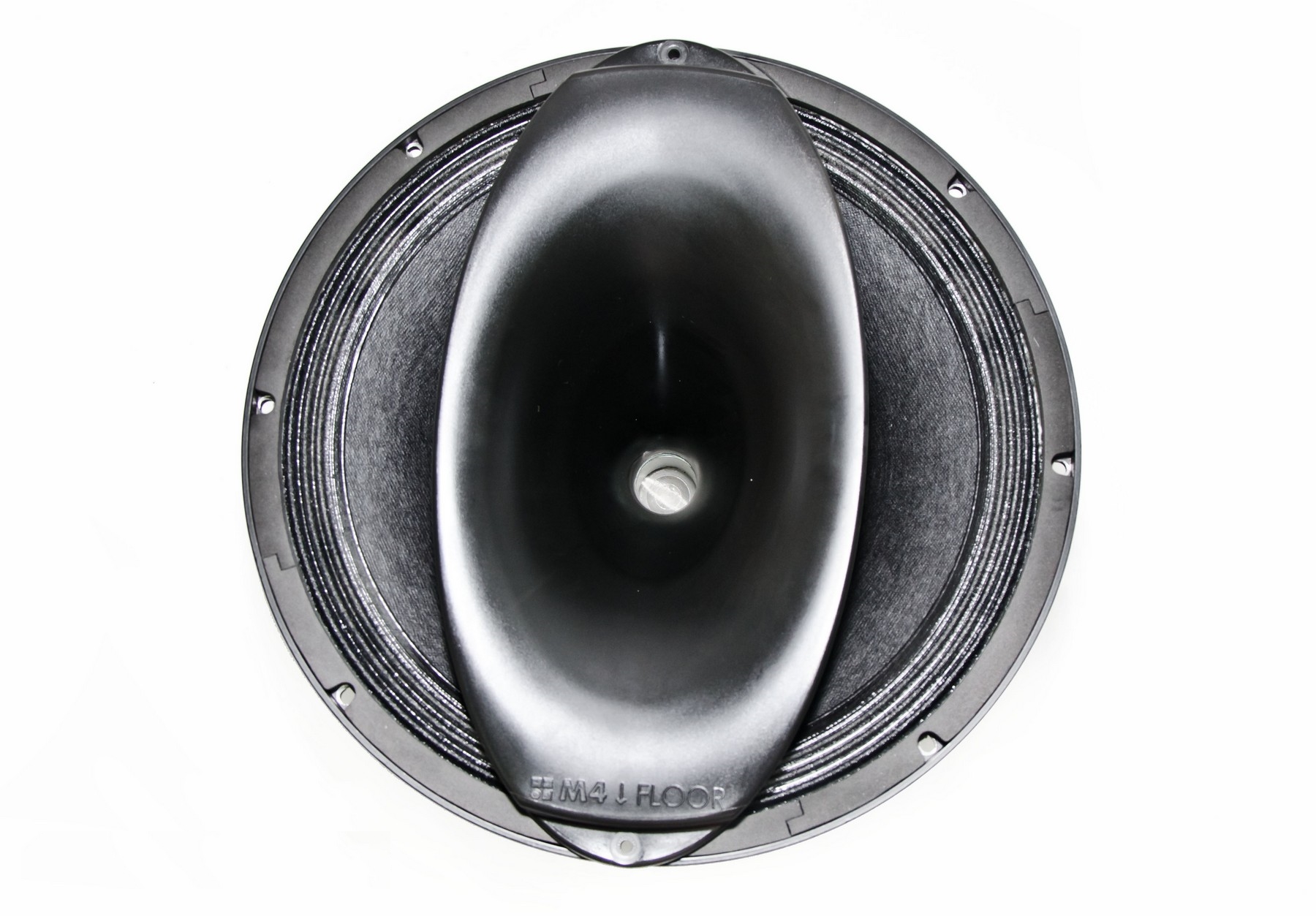

Personally, I like d&b audiotechnik a lot, but it's not exactly cheap stuff.
Their M4 uses the B&C 15HCX76, albeit with d&b's own 70x50 horn.

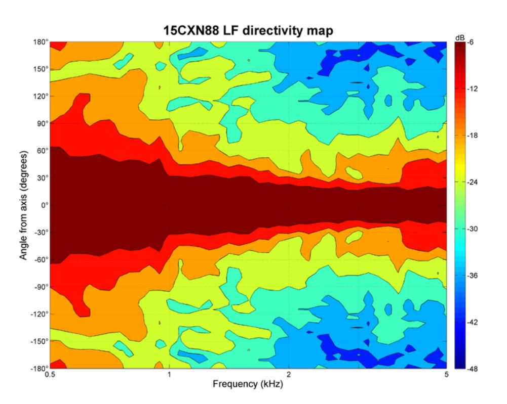

Cool project Mark!
I bet that sub will shake the walls big time.
The directivity of the 15CXN88 isn't bad at all, given the lack of a horn.

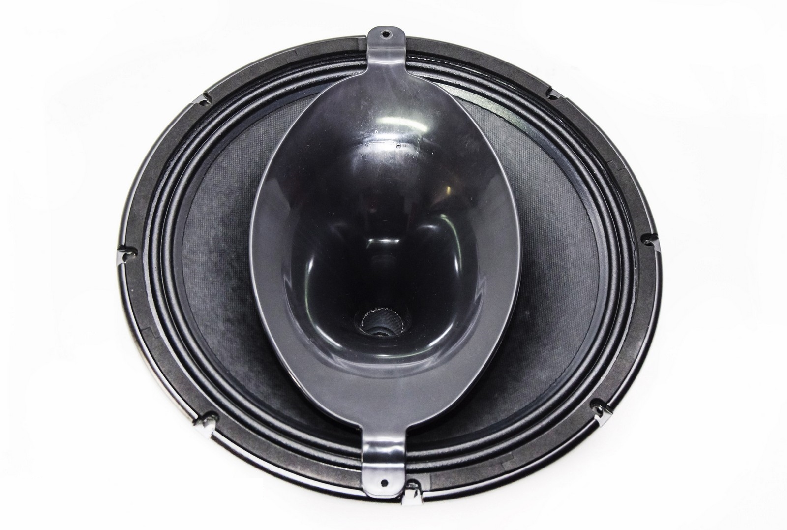

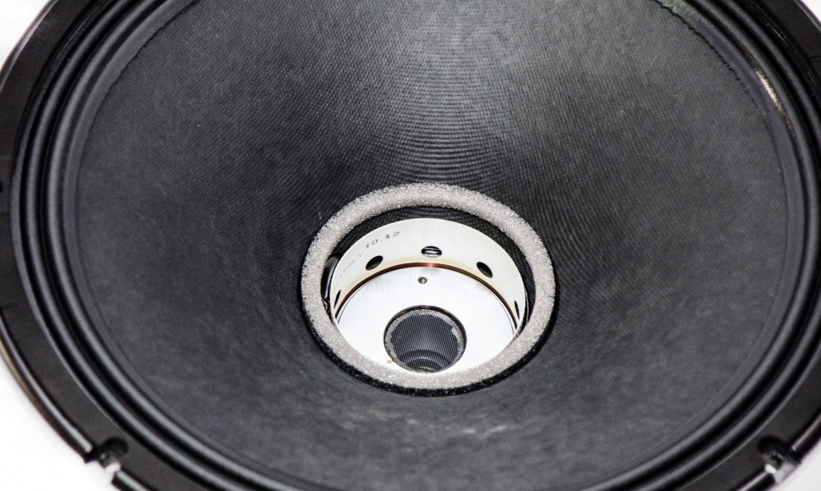

Once again the CX15N351 without horn.
Do you know if horn could be easily removed?
