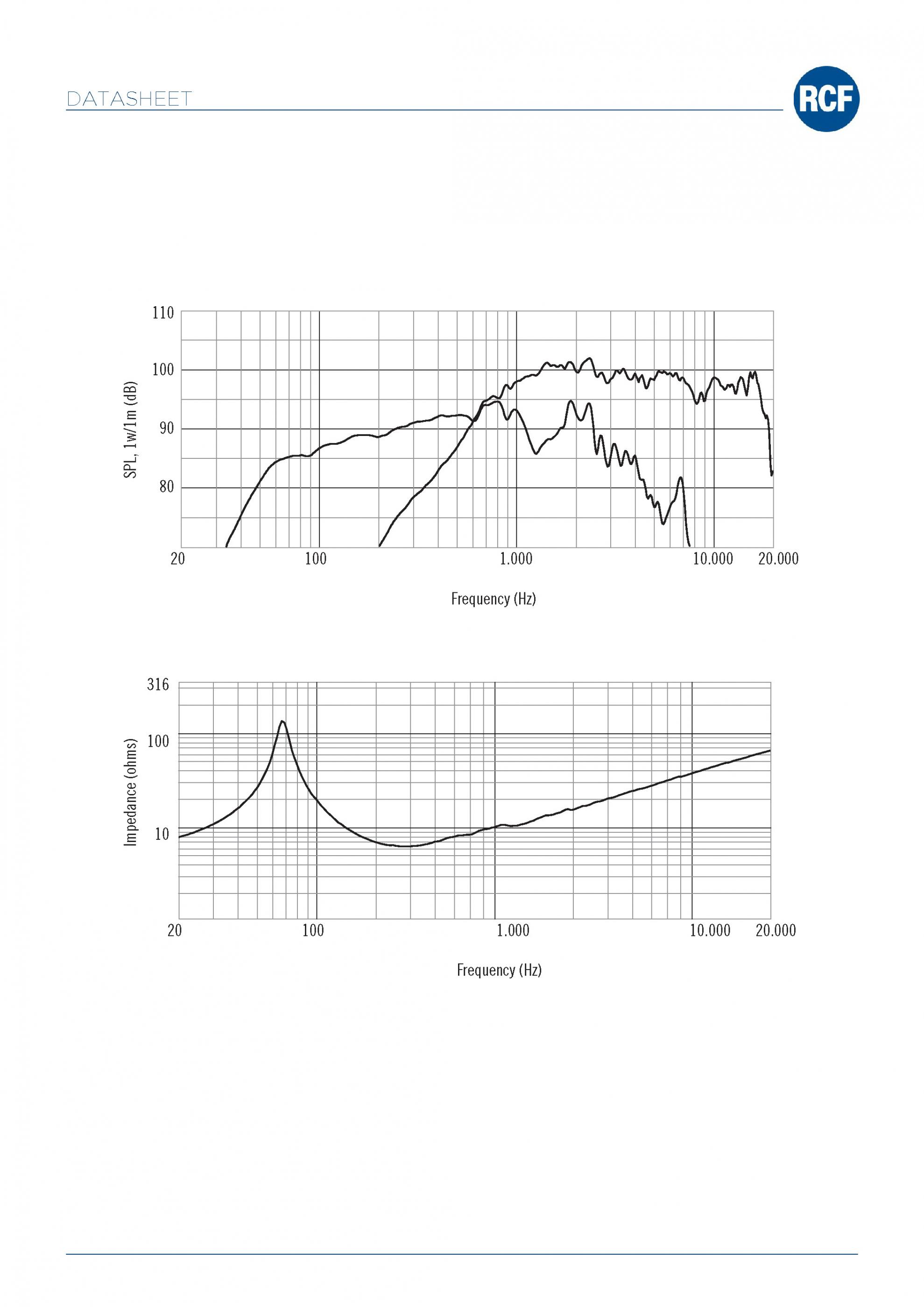

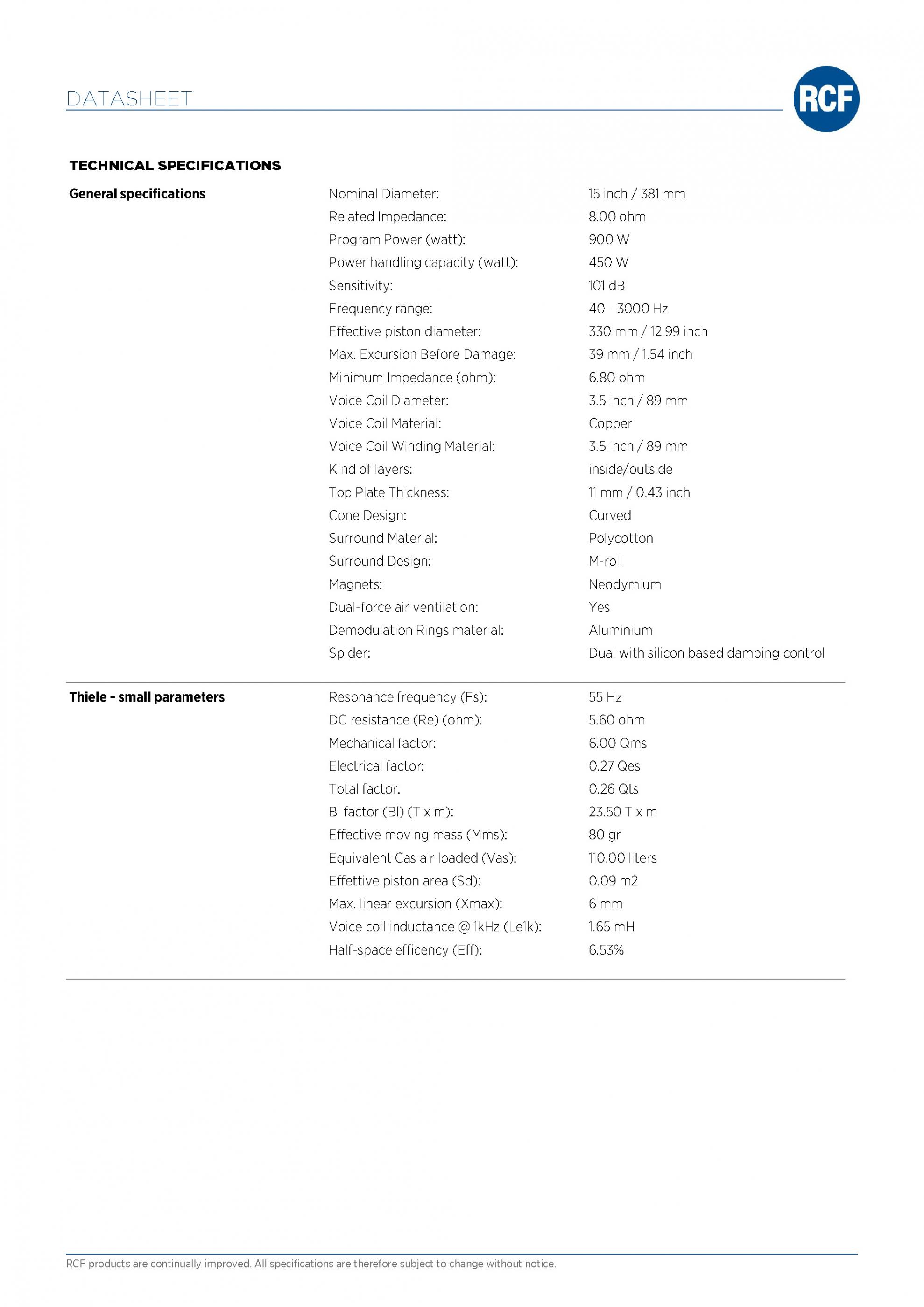

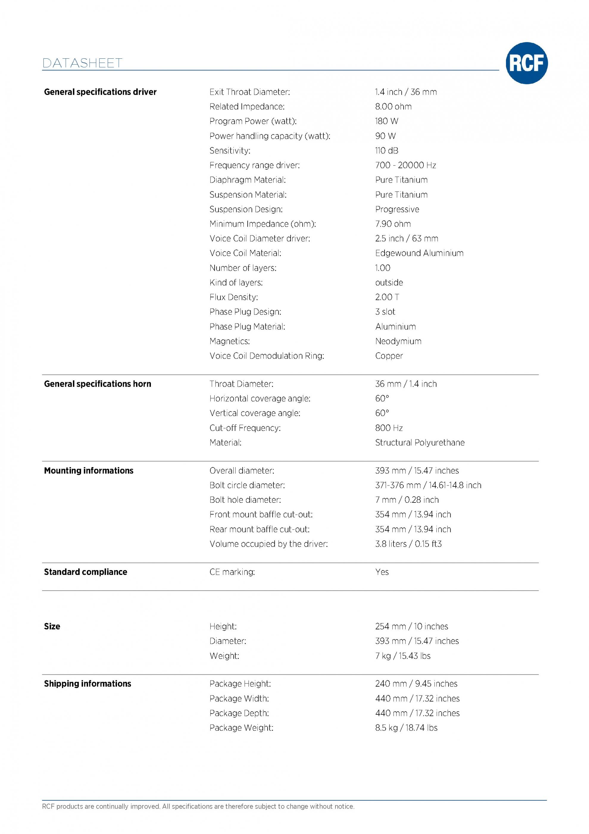

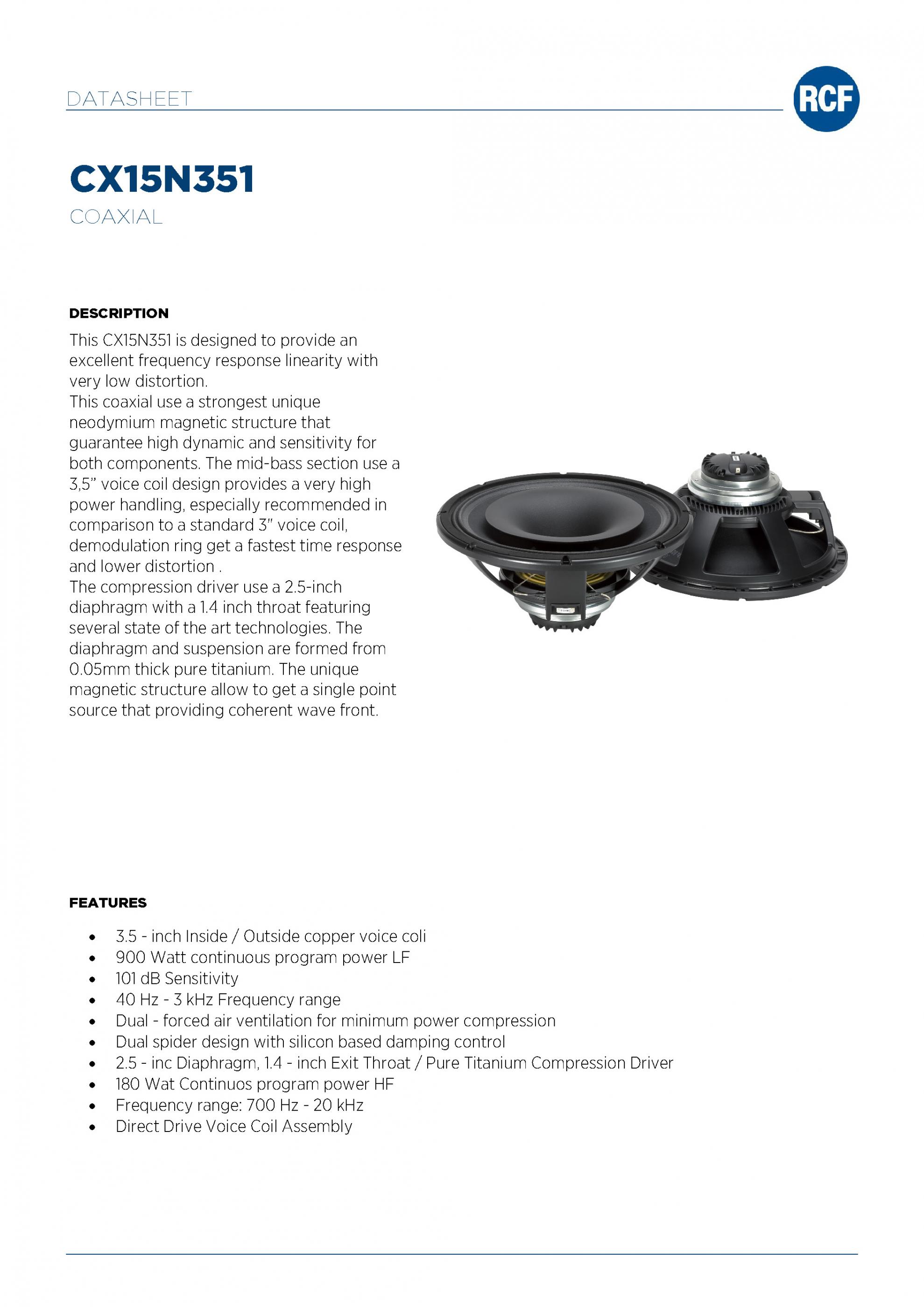

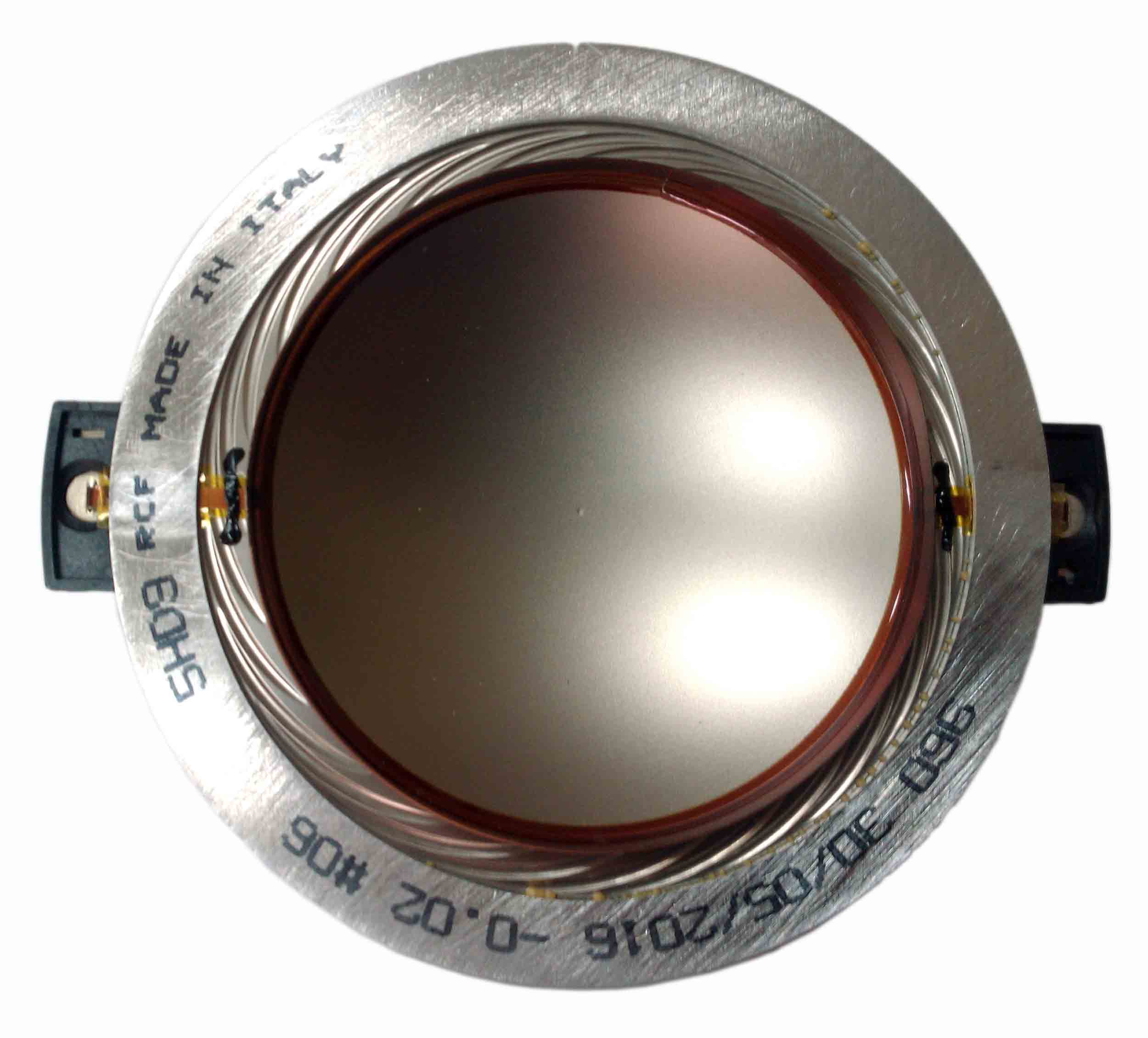

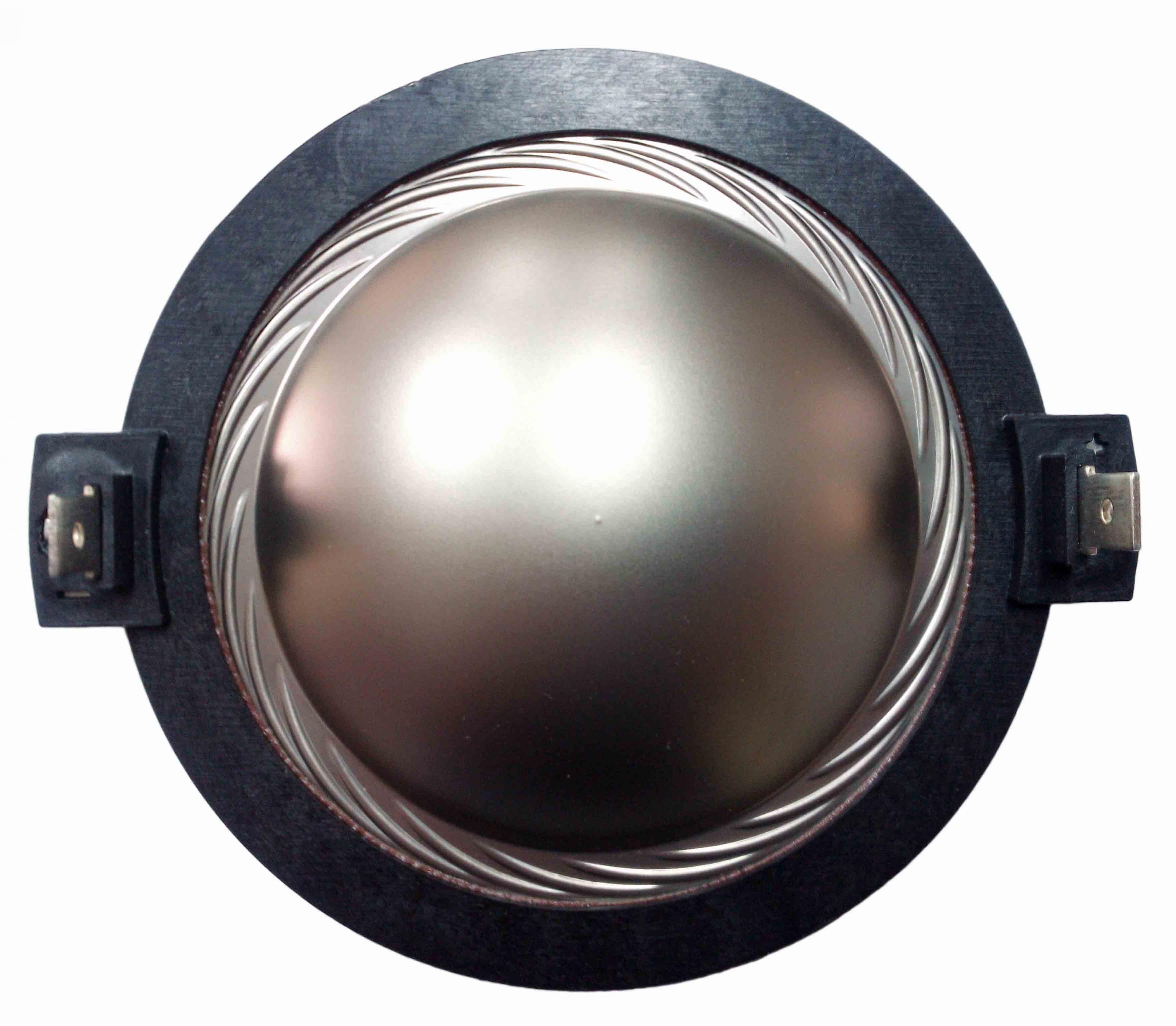

The compression driver use a 2.5-inch diaphragm with a 1.4 inch throat featuring several state of the art technologies. The diaphragm and suspension are formed from 0.05mm thick pure titanium
I have to disappoint you, the diaphragm is nothing special.
I would go as far to say it's the weak spot in the driver.
This was not me talking, but a quote from their spec sheet.

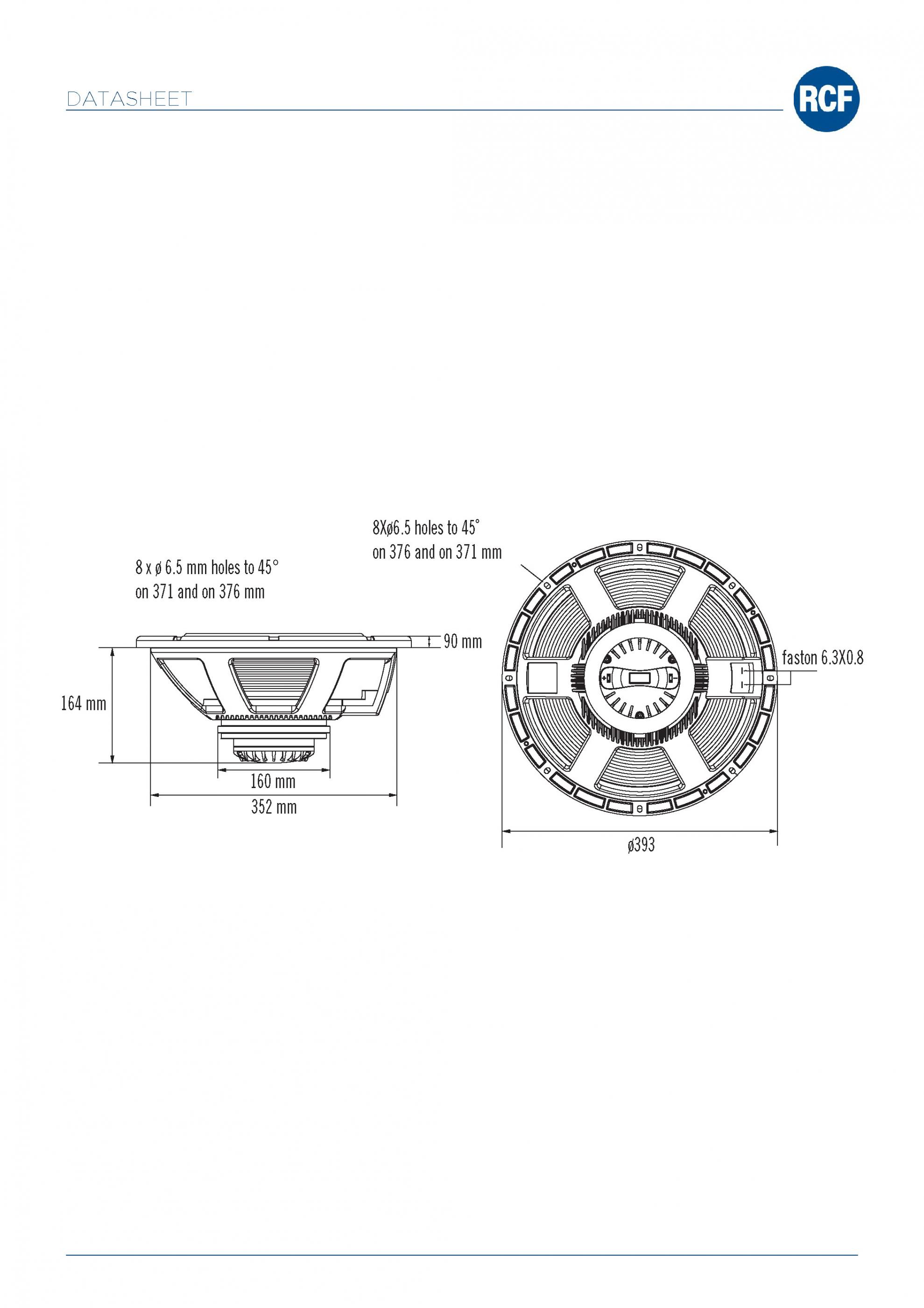

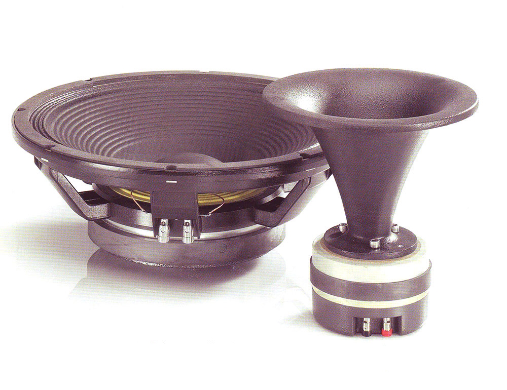

So the RCF has a 1.4" CD?
GM
GM
OK, I thought this horn driver is what the 1.4" initially referenced: https://www.diyaudio.com/forums/att...l-low-distortion-2-a-bullfrog_old-drivers-jpg
GM
GM
The 18" in that 60 grand a pair Tobian 2-way might as well be a RCF anyway, assuming this guys prefers to buy from a single manufacturer and thus receive considerable discounts.
Currently, RCF's line-up lacks an 18" with M-roll surround and ribless cone. However, the good 'ol budget L18P300 fits the picture perfectly.
GM
At first glance you'd think Altec 288/291. The terminals are different though.
The top (underside in the pic.), including the terminals, looks like vintage JBL.
Funny thing is, about a 1.5 ago I was close to buying a set of vintage drivers that looked exactly like this.
Even though these were almost free of charge I let them pass, because the dias were gone.
Some time later I coincidently stumbled upon the driver online, but can't recall the brand now. It'll pop up sooner or later.
