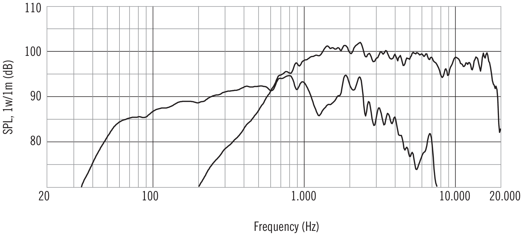

As said, the RCF Coaxial in the current Bullfrog is completely modified, both the woofer and the compression driver.
Older Bullfrogs were crossed at 1500 to a smaller compression driver, whereas the latest active model's crossover is at 680hz.

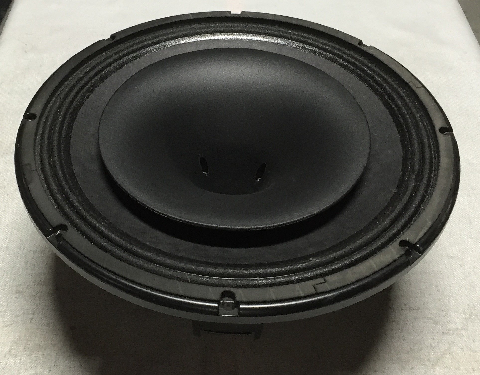

Martion reintroduced the passive Bullfrog a few years ago. It's a slightely different amphibia with a 1" compression driver and XO at 1500Hz
As it appears, quite remarkably, both diaphragm and cone are 'sandwiched composites' and I also read both are actually paper based.
However this may as well be a misunderstanding from the reviewer.
Chassis, diaphragm/cone and suspension are modified or custom built. The magnet cap is also different from the regular RCF.
I am not sure whether horn is completely customized or a modified RCF horn.

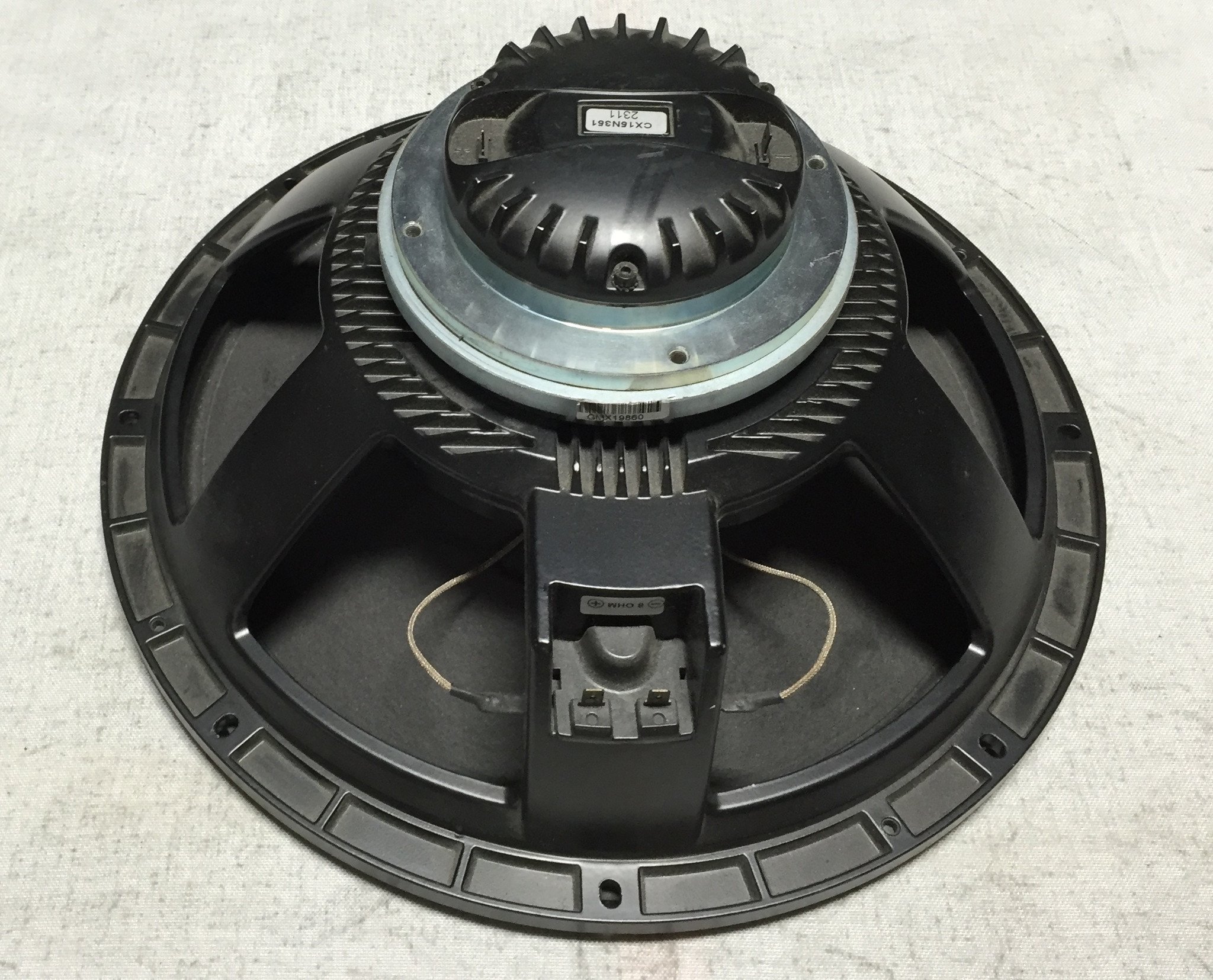

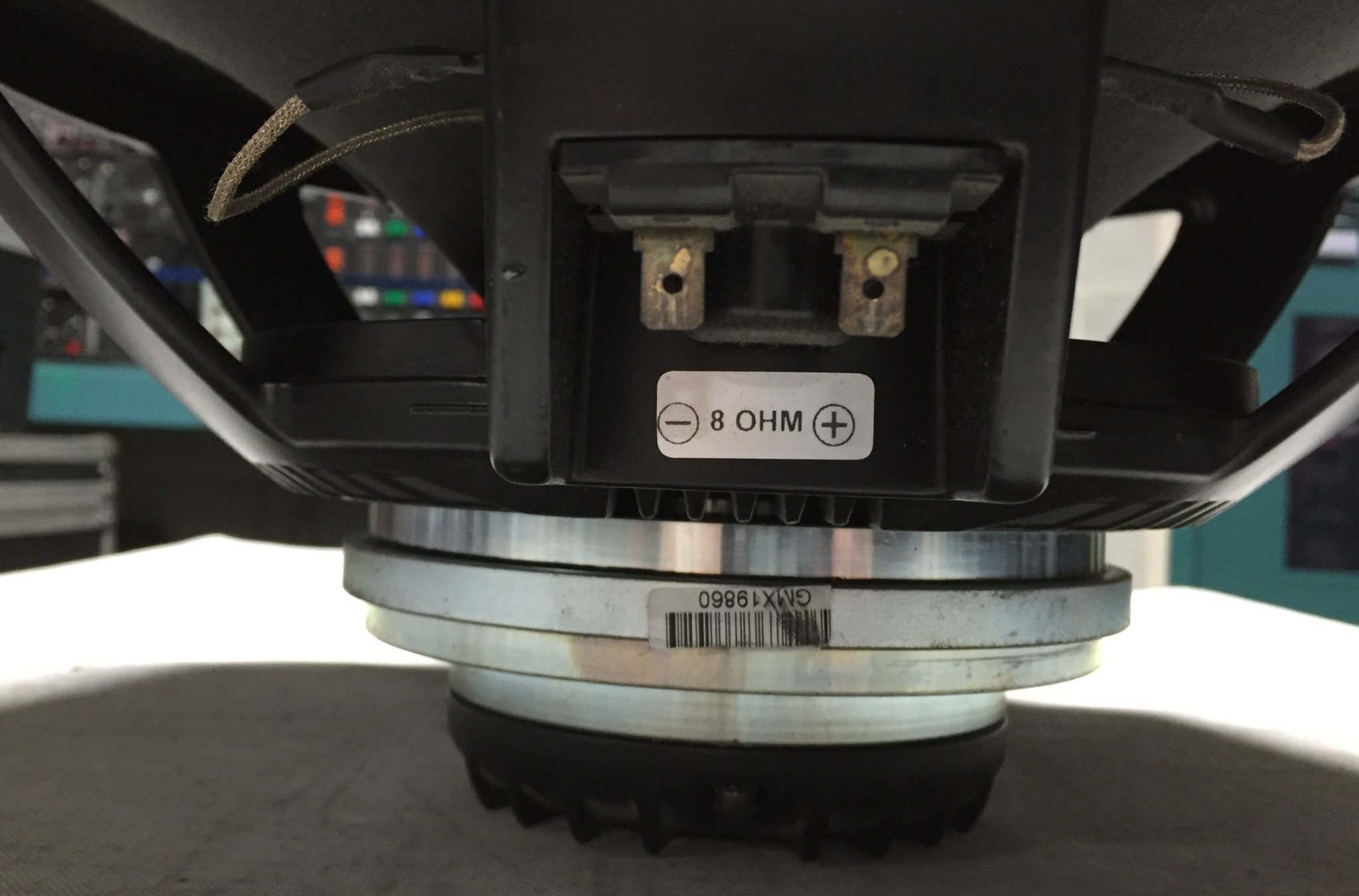

I have first hand experience with the Martion Bullfrog and the CX15n351.
The driver is the exact same one and is only modified by Mr Bullfrog himself,
He applies the felt on the inside of the horn for absorbing reasons only.
The cup covering the magnet on the woofer is also done in the Bullfrog production line and glued in place, it has a threaded insert that is used to hold the driver in place as he does not use the front mounting holes on the woofer, but rather a bolt inserted from the rear of the cabinet to pull the driver in and hold it very firmly in place.
Nothing to it really. all simple mods done in house!!!!
seen it for myself:)
Only thing I would like to get my hands on is the crossover.
Are you sure?
Apart from more than a few references to raw drivers built to specs as well as post factory mods, the spider in the Martion 351 does look slightly different from the one in the factory driver.
Besides, the passive Bullfrog may house a driver that's based on the 251, the cone looks more similar to the one in the 351.
Could you explain the 1.4" vs 1.5" exit?
believe me its the same driver and it uses the same 1.4" don't believe what they say, they are just trying to put you off copying their design. The Passive version is crossed over at 650hz to 680, I have measured it.
As mentioned I have first hand experience with them. One of the most dynamic speakers out there!
Yes, you're correct.
There appear to be some misconceptions among owners and reviewers concerning older verus current models.
"Coaxial construction: Both the RCF 15-inch Bass drivers as well as the 1.5-inch high-frequency unit - both with sandwich composite membrane and neodymium magnet are elaborately modified by Martion. In order to achieve the lowest frequencies in the the small housing the cone is soft suspended"
This confirms what I said, all modifications are done by Martion.
It is still the standard 1.4" comp driver though, that I promise.
I gaurantee the driver they use is standard from the factory.

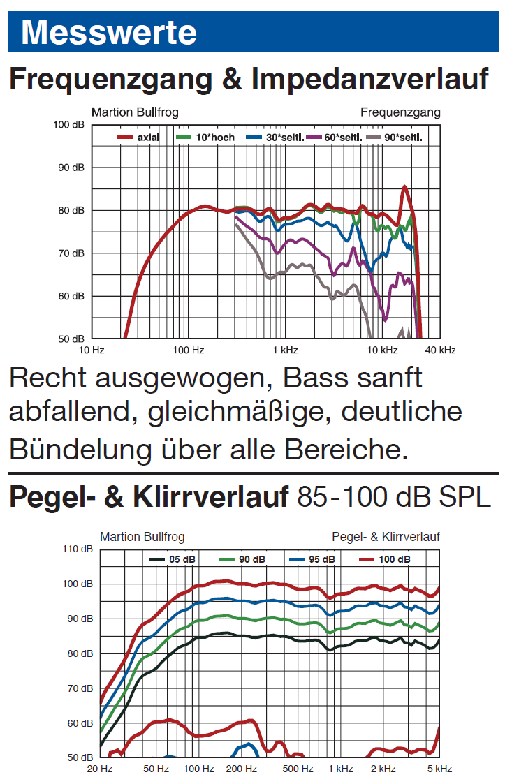

Measurements by a German magazine, including break-up spike:
From which speaker are these measurements?
We see about 12dB descent from 90Hz down turning into 18dB from 50Hz on. No bass fundament at all... The frequency response taken only at 80dB Level... Huge break-up modes at HF. A very strong beaming with deep holes. The distortion curves end at 5k while fr response is shown up to 40k - why? The answer might be the steep increase of distortions at the right side.
I would not waste any money in such a design in the sense of this thread searching for a reference Monitor design.
