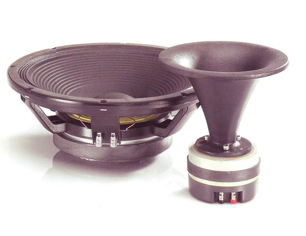

Attached 2 pictures showing the inside of the cabinets, drivers and horns of older Martion products.
The compression drivers attached to the horns appear to be Altec, or GPA. At least the woofer on the right image is an RCF unit.
