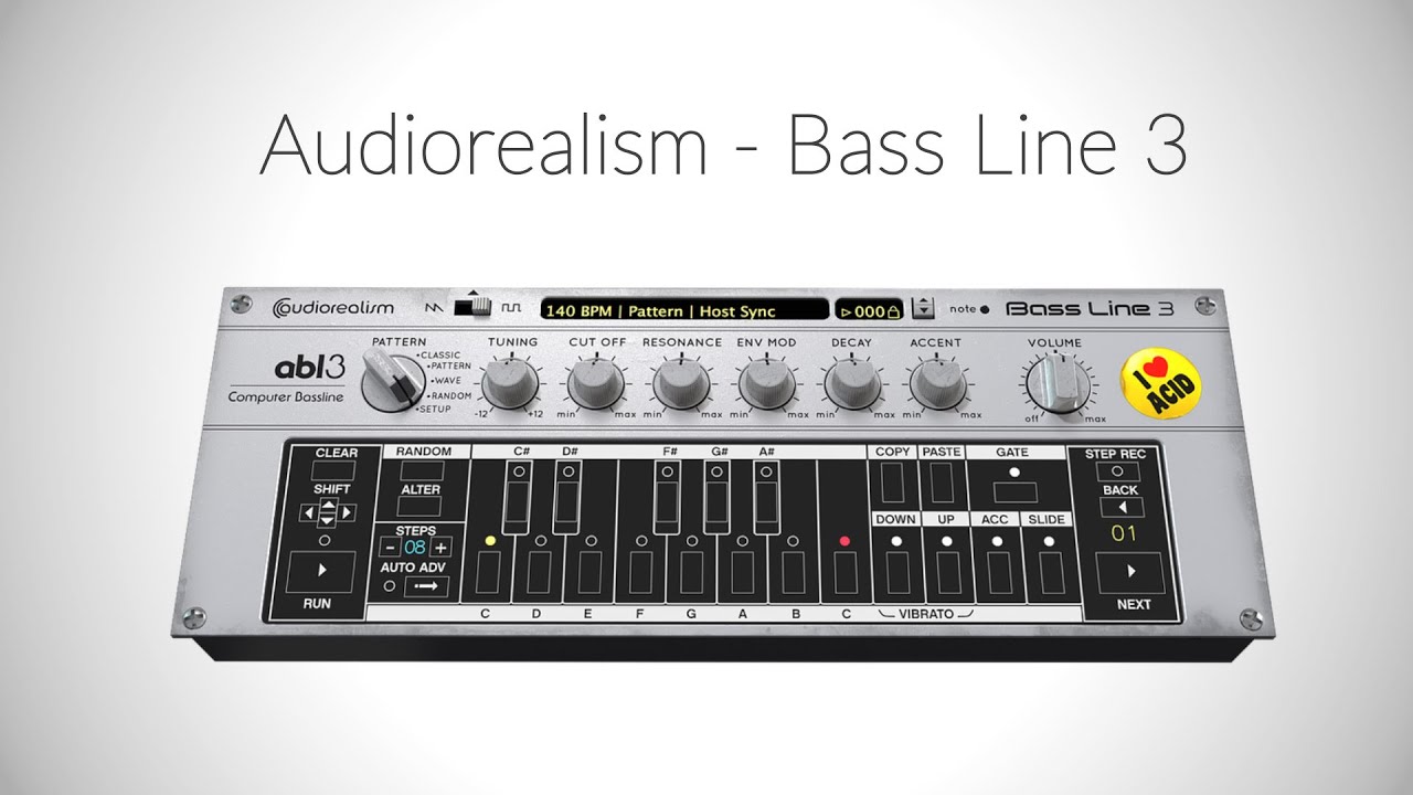

Some people still prefer analog modular gear, but personally I think VSTs have come a long way regarding authenticity and overall sound quality.
For example, it is very difficult to distinguish this VST from the real physical device.

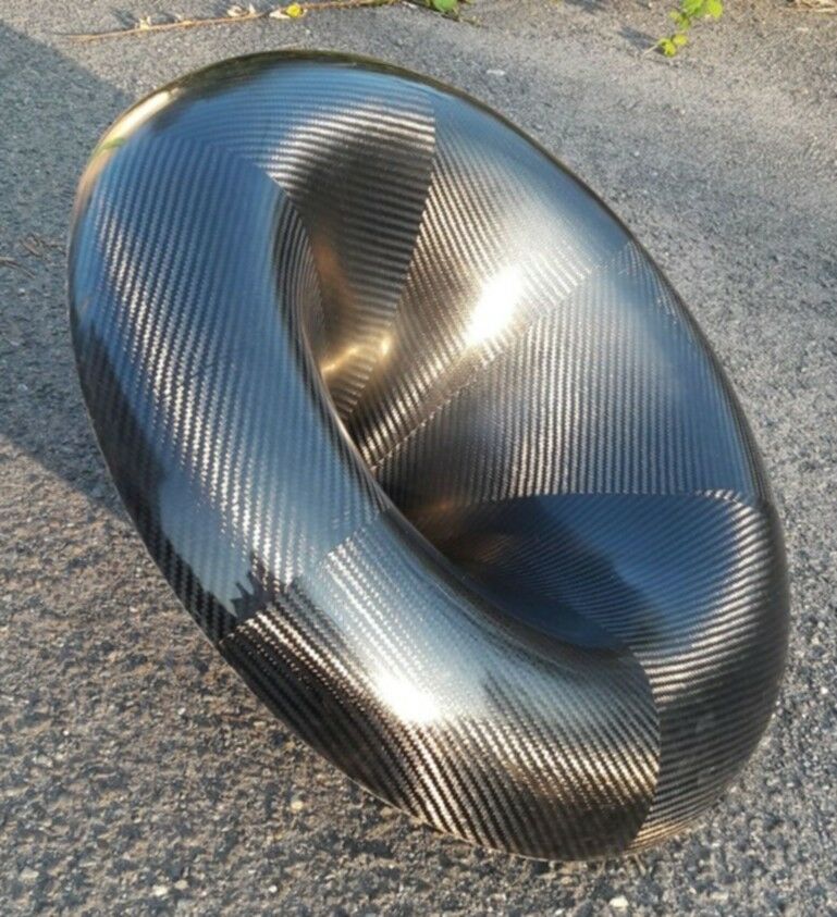

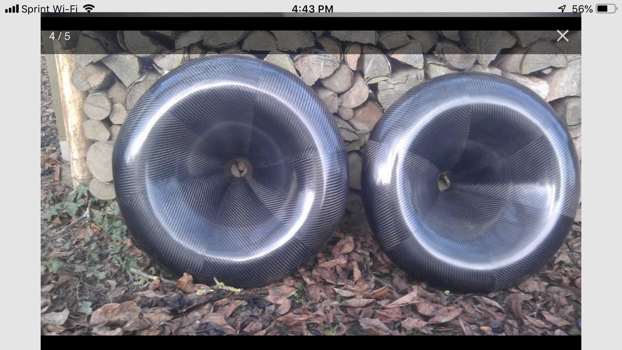

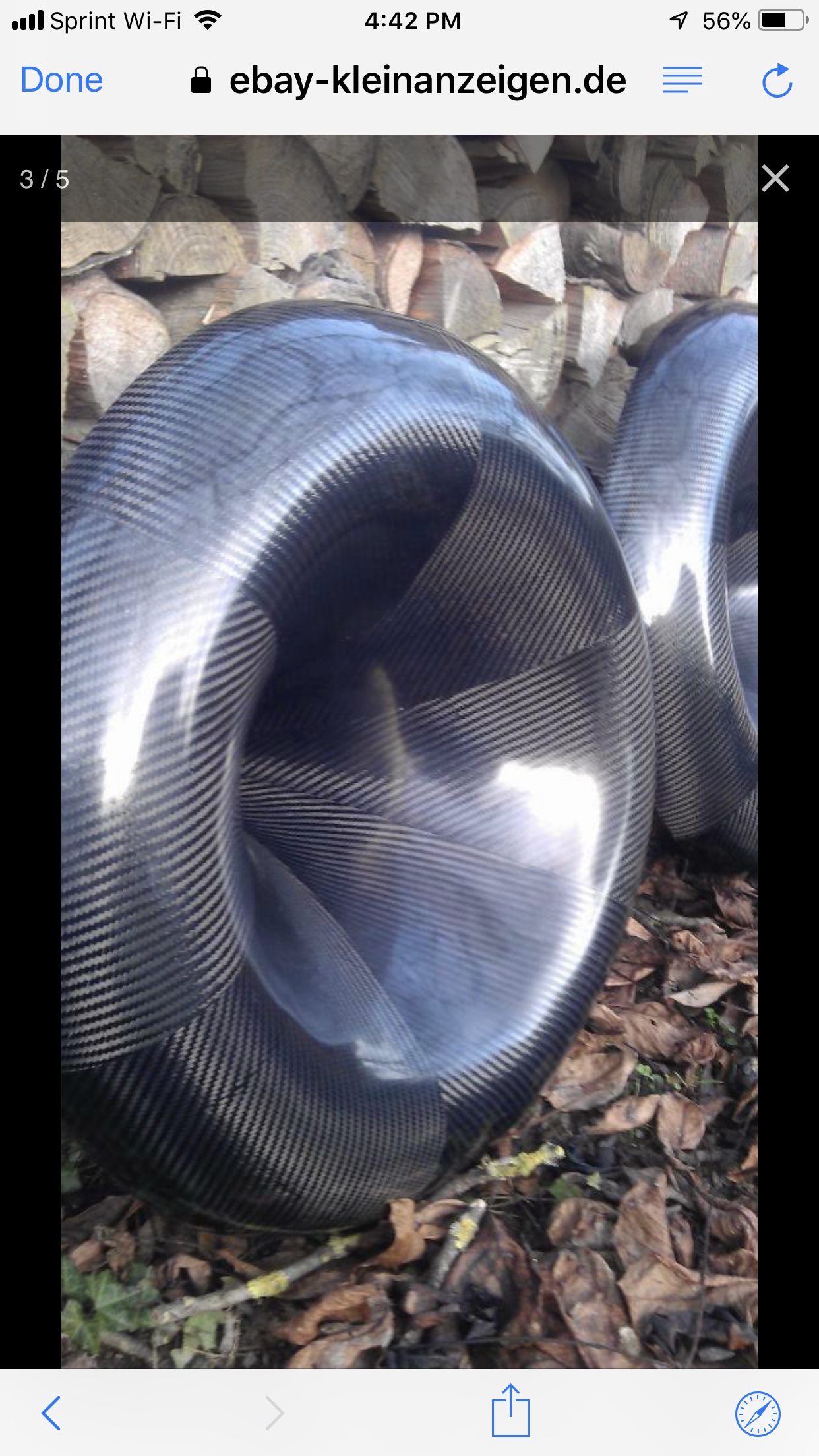

Daemonsgr- if you search jmlc on eBay Germany he will come up. I paid a little under 400 shipped. The guy seems knowledgeable about loud speaker theory and stayed in contact with me the whole while waiting for my product ��
They are 26x15....which isn’t a bad size
This loudspeaker is called the "Einhorn", which means Unicorn in German, but I tend to believe it is (also) a tribute to Martin B. Einhorn, the American theoretical physicist, who shares the same background as the manufacturer.
You've paid 400 all included? That's a very good price.
You'd probably pay at least twice that amount for similar horns from Auto-Tech.
Perhaps the finish of the Auto-Tech horns is slightly better, but likely not worth the difference.
This is the seller's local e-bay account (use google translate).

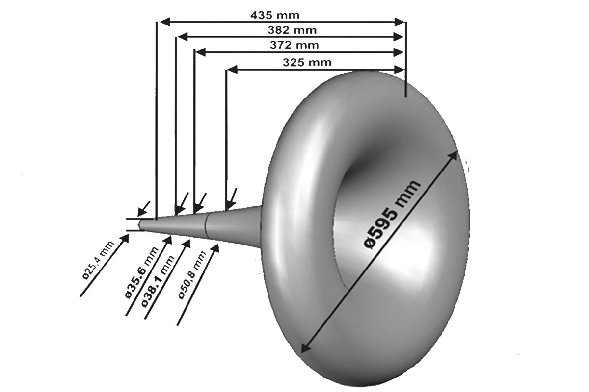

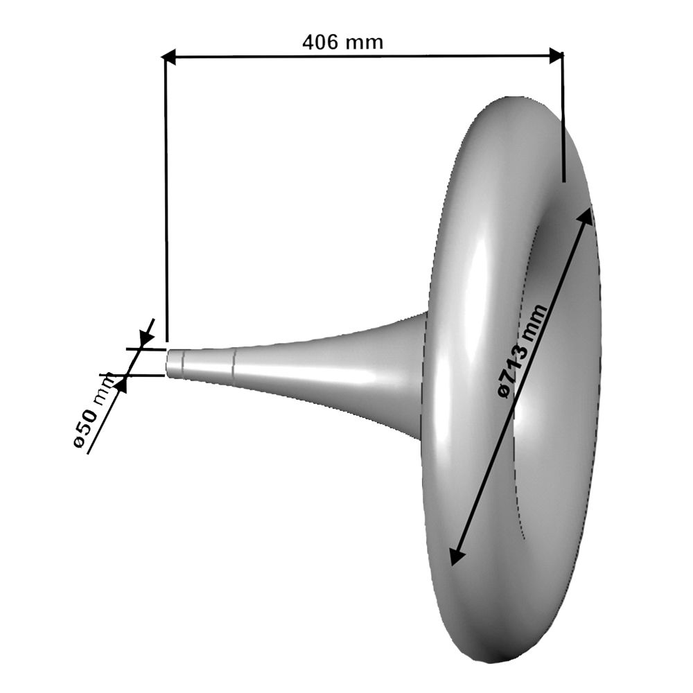

It's a 2-way, but you'll need subs. I'll post some additional info later.
Tractrix Horns w/ B&C DCX50
Though I suppose the voice coil is small for the task.
The voice-coil size of the DCX50 is misleading.
The mid diaphragm is actually cone shaped and 5" diameter, whereas the HF diphragm is annular.
It's supposed to be a very nice driver, now superseded by the DCX464.
Both on paper as well as according to some sources the DCX464 beats all BMS coax drivers.
