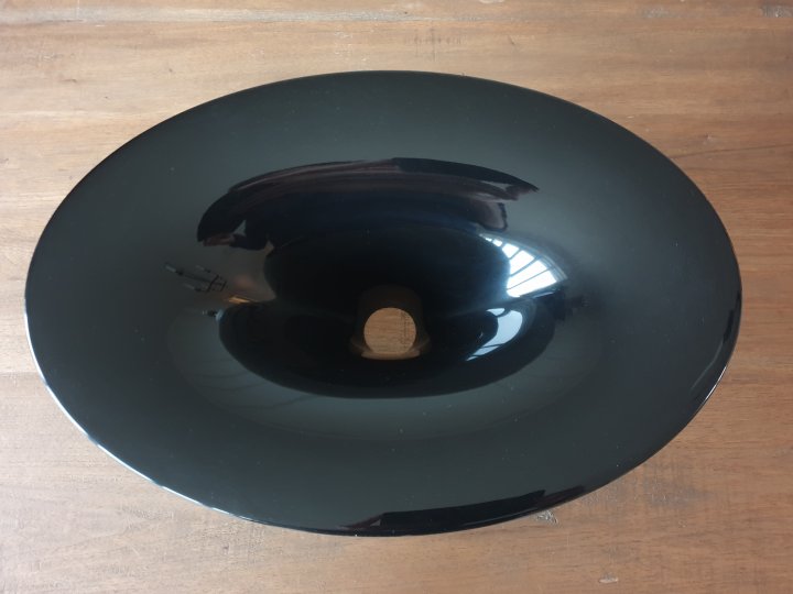

The mouth still looks similar to some of the 18Sound horns, but the throat is definitely different, without the usual slot.
At least on the image below, the throat area doesn't look particularly smooth.
The flare appears to be (hyp)expo or perhaps even (truncated) spherical.
