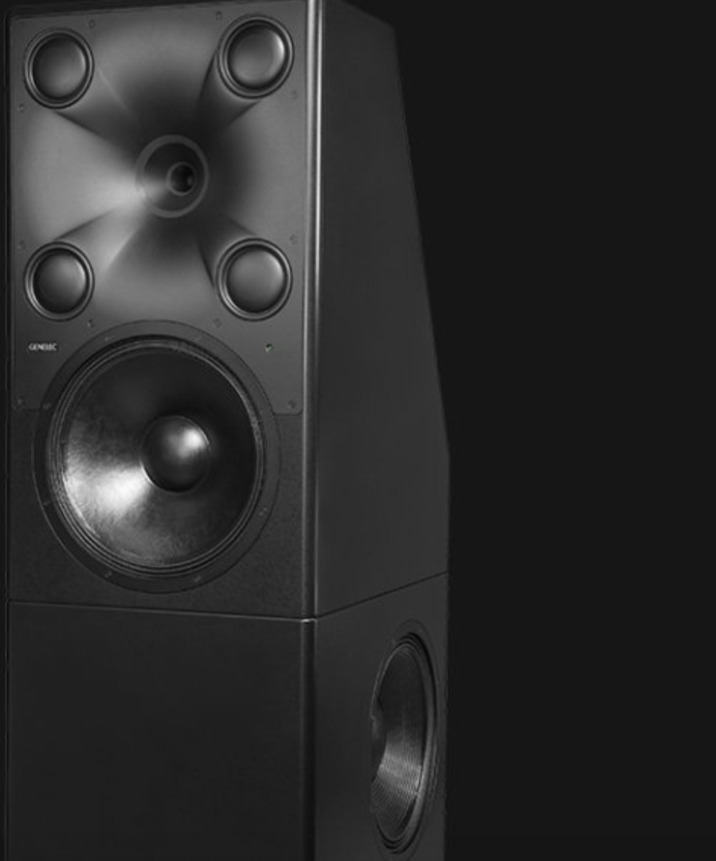

Ok now lets pretend like Genelec didn't just release a 2023 mastering monitor, its now Flagship, 2023, applying the same principles of keeping as much of the spectrum on the same acoustical axis....as possible.... Why didn't they just release a big Waveguided Two way in the normal sense
Yeah there you go Gelenec you already did it on the small scale, just take this idea, and make it bigger. Oh whats that Genelec? You have a better idea?
They literally could remove the 4 small midwoofers woofers, have a roll over, its now the waveguide, cross it over at 800hz, call it day. The driver in the Waveguide crosses at 500hz, even better, just delete the 4 midwoofers and move the crossover up on the 15". Whats the big deal about the lower frequency acoustical axis transition trend? I already explained it to you "There are more aspects to imaging, than just point source presentation, yet, you cannot be considered the best in imaging without sounding like a point source" and the way to sounding like one is to be one as best you can.
Genelec and Tom must of been reading my thread, but honestly, they must understand the same thing that I understand. I mean Genelec is a hop and a skip away from being another iteration of a two-way section resembling a NS15 and they were like yeeeaaaahh but Nope.
