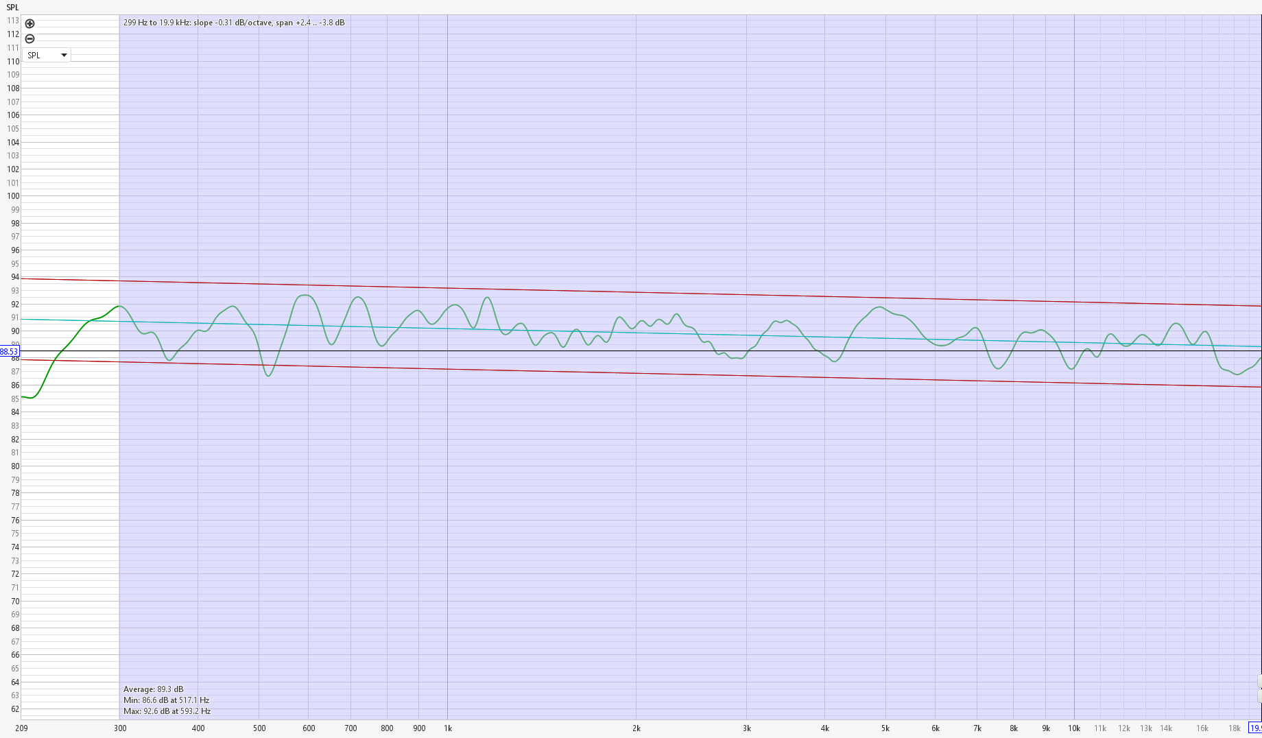

This is indoors at 1m I think.

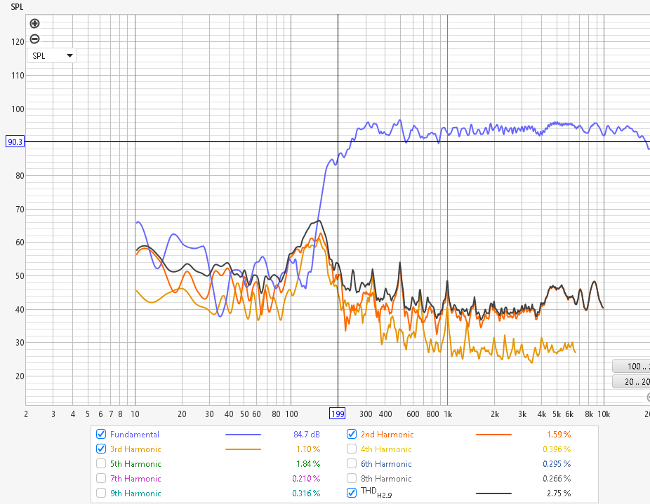

Art is telling me the THD is too high in the Max linear range if I am truly aiming for 115db/1m... I am trying to duck that by pointing out that it sounds good, and that though the thd is looking sketchy, I am not hearing any issues when listening at 95db or similar. I've done other experiments, Like 15" vs PPSL where the issue is not THD but something more tangible, FR. In the room, the PPSL measured better than the 15". When I turned over the PPSL and got the woofers, basically on floor, the FR was even better.

@200Hz, 85 dB the system produces 3% THD. Still 10x to much. And here it starts to be important but at 115, you ears will distort so much it doesn't matter. It might sound fine for some but if you get rid of it, you would notice a "dull mist of grey" disappearing.

If I'm understood it right, having high harmonic distortion in a THD plot at low frequency might mean high IMD for the whole bandwidth. For example on a woofer there are multiple sources for harmonic distortion that would show on as 3rd harmonic. Simplified, one source for distortion is suspension and another is motor. If high harmonic distortion number at low frequency is due to non-linearity in the suspension, it would likely have very little effect on high frequency performance where suspension is less involved, and thus would cause less IMD high up. But, if the high harmonic distortion is due to non-linearity in motor, then it likely would show more IMD because electrical parameters in the motor depend on excursion affecting the whole bandwidth.
Anyway, if you see high harmonic distortion at low frequency band of a driver, worst case the distortion means high IMD for the whole bandwidth, even though the swept THD measure showed low distortion at high frequency.
Thus, one should evaluate distortion performance also with multitone, play the 200Hz and 1kHz or 6kHz or something, and see IMD sidebands appear. You could have 20 tones for the pass band and evaluate how much peaks of the tones are above the "grass" between the tones. See Joseph Crowe site, he has posted this kind of measurements.
While 2nd or 3rd order harmonics are not very audible as such aligning well with the musical content, the sidebands due to IMD would not align and likely be the audible part of distortion, if any. I do not know what is cause of distortion in your case, and if it makes IMD and if it's audible or not. Since it is elevated, it would be worth checking out, perhaps little adjustment here or there can make audible difference.

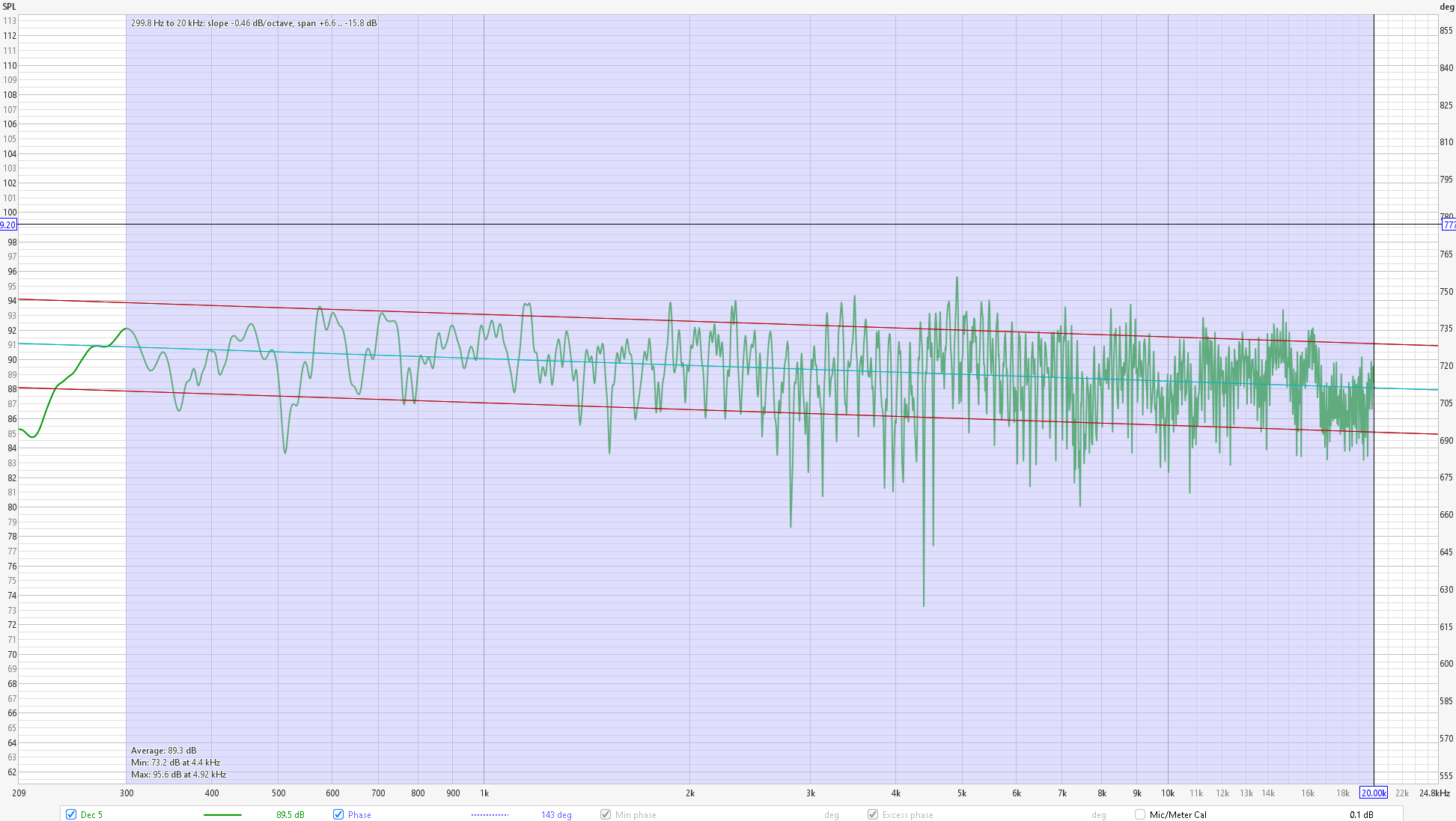

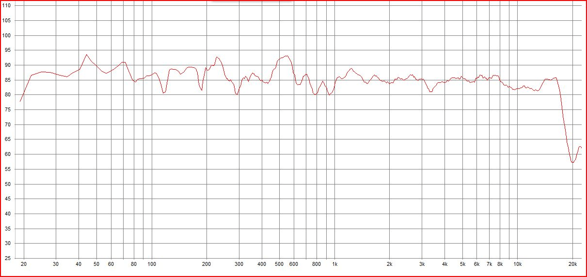

Frequency Response is one the most important aspects of sound quality. Gedlee you did mention my response from the ppsl, but what about the Horn? This is at ~1m in my living room..... I am having a hard time finding any 1m measurements of the Gedlee NS15 do you have them to share? Anechoic or Echoic alll are welcome. This is also the direction of my FR at listening position... Do you have any measurements of your system at the listening position?
(1/12smoothing)
(Raw)
I forgot to share my idea. I happened across this post of yours and I think it supports my idea. I should be able to measure thd with the horn off.... All I have to do is use the voicing intended for the horn.In any of these systems the radiation load is a small fraction of the total mechanical "load" on the diaphragm - being dominantly the result of the Electromagnetic damping. What this means is that horn loading will have only an insignificant effect on the diaphragm motion. It will continue to increase as the frequency falls if the SPL is to be maintained at a constant level regardless of the details of the radiation impedance. So basically the horn load has almost no effect on the diaphragms motion.
I found an Abey in room measurement. Impressive, I wonder what the smoothing is, if any. I think its 1/12 but averaged...
"I won't be taking free field quasi-anechoic measurements for a while, so what I put up will be in room, but with some spatial averaging of the mic to reduce the effects of the room."
"Again, I want to warn that these are not anechoic measurements, they don't really even fit atb's requirements to get properly averaged quasi-anechoic, the speakers were measured at 2 meters in location. This measurement is with the mic in place, but the speaker turned through roughly a 60-90 degree range."

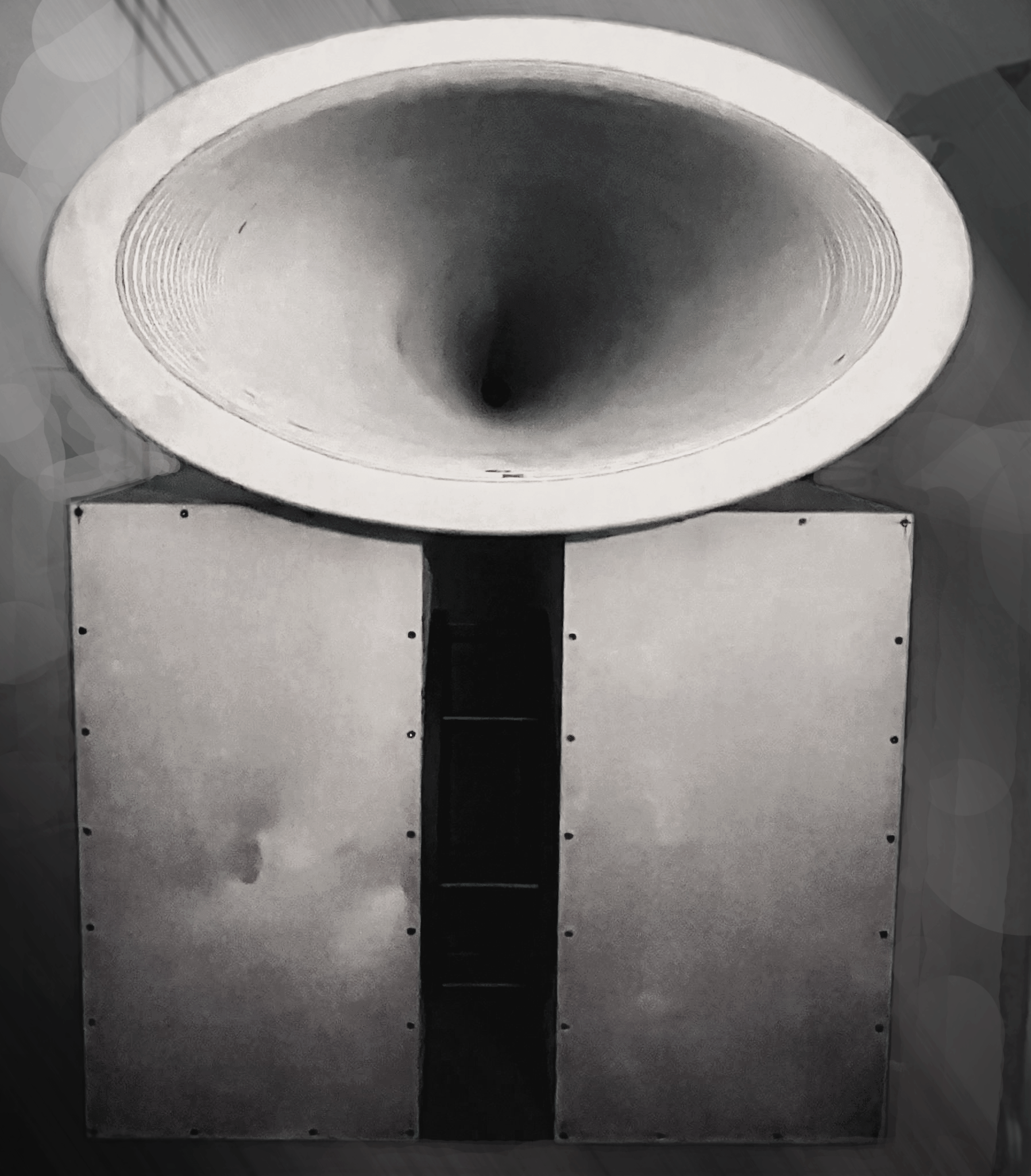

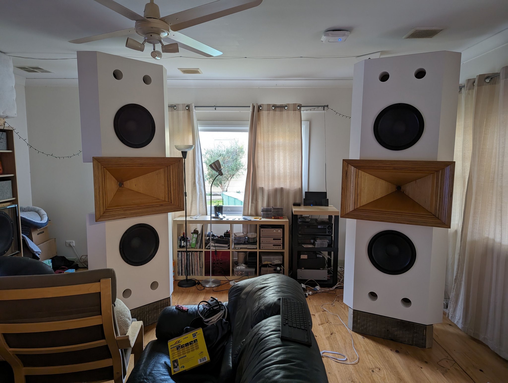

Checking in since 5000 posts ago, i have finished the 3rd (or 4th?) attempt at such a 2 way..
A K402 clone horn with jbl 2453J and dual faital 15pr400, complete with a passive crossover

I like what you are doing, why so many attempts though?Checking in since 5000 posts ago, i have finished the 3rd (or 4th?) attempt at such a 2 way..

Awesome work. Thanks for sharing this and the link.Checking in since 5000 posts ago, i have finished the 3rd (or 4th?) attempt at such a 2 way..

1 meter has and will always be my preferred listening distance. I set out to design the largest build I could that would sum well at 1m. At 200hz crossover I have achieved that. The THD/IMD is still being investigated.
I could also argue that non of your Two ways that do not reach near 1/4WL spacing at crossover have good imaging.... and that its really a matter of "it sounds good to me" until someone like myself comes around and disagrees. Which measurement should I turn to, to judging how well a speaker Imaging? Not Frequency response, Not THD, being Diffraction free won't stop a source thats spread too far apart from sounding like two sources. So you all are walking around saying your large two ways with large horns or waveguides crossed to large woofer, well beyond 1/4WL spacing have "great imaging"... When in actuality These configurations have great imaging and the former is just a "sounds good to me"
If you move closer it definitely removes the veil, and the imaging of more common, large two ways, will not have good imaging at 1m.... Not crossed at 600hz, thats for sure. I keep trying to remind some of you that at the top of the food chain, we seem to take move to the right or left, but not exactly better. By creating constant directivity (while not using a synergy) you widen the X axis sweet spot, yet you've shortened the Sweet Spot on the Z axis 😕 your head is now in a vice, you have no choice but to sit further back, in order to mitigate this Flaw. You might say well these designs weren't intended to be used at 1m but potentially neither were the Tom Danely or Genelec, its just that their imaging is soooo good.... it can be.
If you had all the pictured loudspeakers in a room set up at 1 meter, and you think the JBl or Gedlee will image better than speakers pictured at the top. You are mistaken. That gives question to, how much better do those designs image, at 7ft....

I just like the challenge of a new project, although these will stay with me for a long timeI like what you are doing, why so many attempts though?
